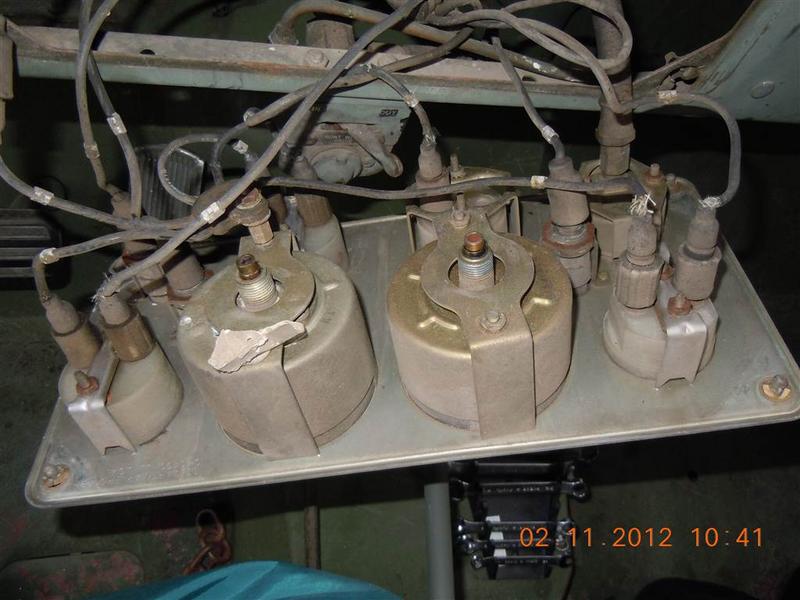

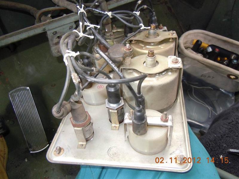

Spent pretty much all day working on Betty. I had noticed the gauges sometimes stopped working while driving down the road and the fuel gauge bounced all over the place so I took the gauge panel out to check it out. The wiring was badly dry rotted with exposed conductor and loose connections. I didn't have a new gauge wiring harness so I used some Prestolite 14ga and Packard connectors to replace the worst of the wire and put new connectors on virtually everything. While I was at it, I cleaned all of the gauges with alcohol. I disassembled the two red gauge lights and cleaned them up as well. They were full of dust and some corrossion.
The result is all gauges work and are rock solid. On a test drive this evening, I noticed that the gauge ilumination is now much brighter and I can actually tell the difference between the two brightness postions for the gauge lights.

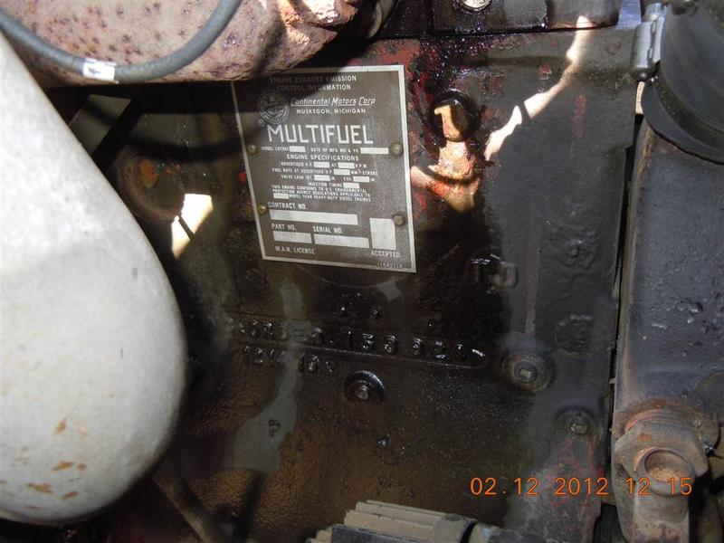

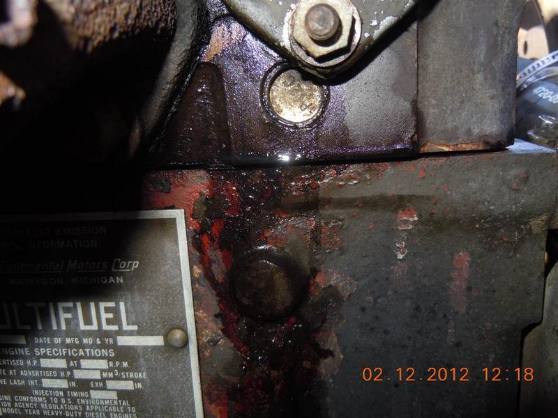

I discovered that the coolant leak that I thought I had under control, is now leaking pretty badly again. I think it is the gasket for the external coolant manifold on the passenger side of the engine. It might be the small casting plug in the head, but I don't think so.

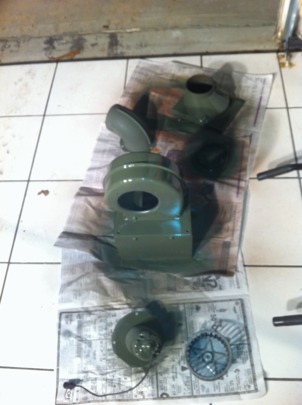

So that cab upgrade that JP-234 did has me feeling completely inadequate, but I made acceptable progress on my heater project tonight. More than I expected as a matter of fact.
I put a coat of primer and a coat of paint on most of the parts. I replaced the dry rotted wire on the blower motor, and straightened out the slightly warped squirrel cage.
I still have to cut down the blower box cover and trim the mounts down to fit.....somewhere. I'm still not sure at all how I'm going to plumb the 4" duct from the blower to the diverter. I'm thinking about putting the blower/heater core on the engine side of the firewall near the steering column. That could solve the diverter configuration problem and leave valuable cab space available for something else. If I mount the blower box on the firewall, I'm thinking I could plumb the air intake through the firewall to draw cab air to recirculate heated cab air instead of drawing cold air or engine compartment air.
I discovered my low speed resistor is cracked so I need one of those. I'm pretty sure it was good when I took it off of the parts truck, but I managed to let it get cracked while moving the parts around here.
(The paint is ultra flat Camo Green but it is shiny in the photo 'cause it's wet.)
