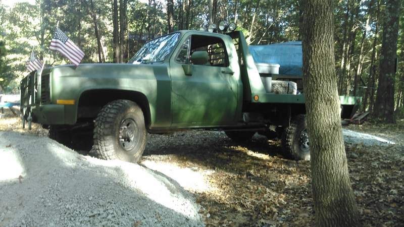

Me and my dad found this truck on Craig's list. I had been looking at a couple and I wanted to see this one first I had looked at a few civi trucks but they just didn't cut it. Iht took about a week to get time to see the truck. In that time the Craig's list ad was gone and the truck was on eBay. I placed a bid. Someone kept bidding me up, I bid a couple times and up the price went. So I called the owner and he said he would sell for cash. So everything else was dropped and on the road we went. Me dad and mom (she went to drive the vehicle we went in back) since o was 15 dad had to drive the truck back. So we looked at the truck for about 3 hrs. Ended up getting it for 4500 cash. It was less then the Craig's list ad but more than the eBay price.
So we start back the truck is running like a Swiss watch. We made a quick stop for fuel because we didn't know if the gauge worked then back on the interstate. After a few more miles we made a stop to for something. I got out and water was pouring from the Grill. Dad shut it down and we started figuring out where the water was coming from. During this it started raining, ended up the radiator cap was cross threaded. So that was a easy fix, after that not a single problem.
I was not a member of this site at the time but I had been reading a lot on here. So I had a pretty good knowledge of the cucv. My dad however is just fascinated by it. He was driving and I could tell how fast he was going by the rumble of the 6.2. He would try to hit 70 every now and then and I would have to get him to let off it.
It was a great trip. I was a little dazed by the fact I had finally got my first truck.
The truck is complety stock drivetrain and electrical wise expect for a gp resistor bypass and the removal of the locker in the rear. Since the truck was used on blacktop only must be why the locker is gone.

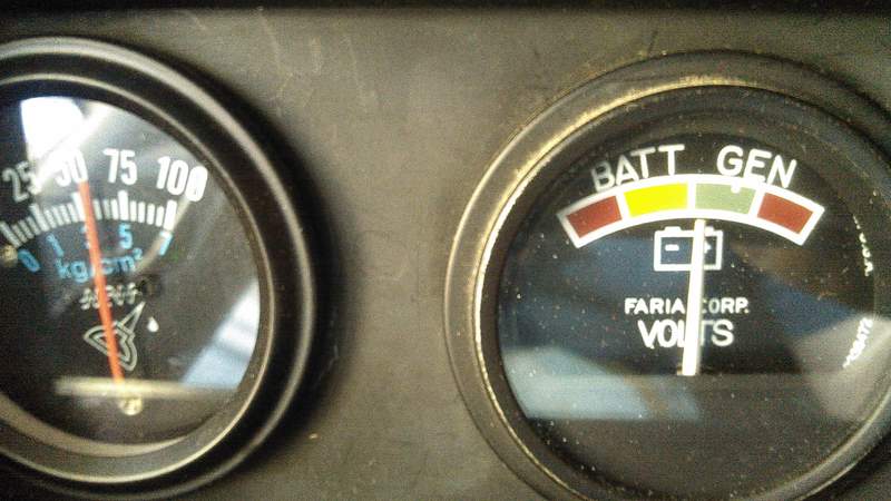

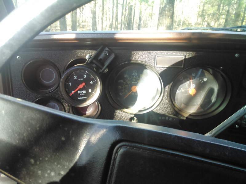

First thing I did was add a oil pressure gauge. I used the testing port beside the radiator over flow bottle to take my reading. I also had to buy a gauge install kit with a few fittings. Also I swapped the old non working volt gauge for a new one and since the old circuit was dead I wired up a new one. I used the 24 volt from the fuse box then a simple 12 volt relay powered by a 12 v spot on the fuse box to send power to the gauge.

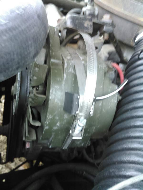

Than came the tachometer. I didn't know at the time that one alternator has a output so I got a autometer universal tach. It has a prob you hook to the alternator then adjust the gauge to show your idle speed then you are good from there.
Thanks for looking everyone

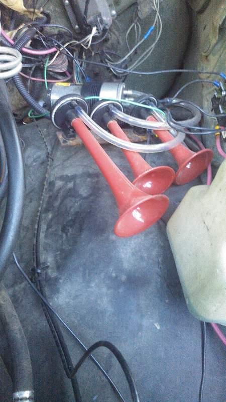

I noticed the stock horn was some what inop. So since i was on a tiny budget I went by harbor freight for a cure. I found a simple horn kit it is their version of a trian horm for like 12 bucks so I figured why not. I did have to take the pump apart and remove a disk that opened the air ports. This way it feeds them all at once. I put the button under the floor mat under the fender vent.

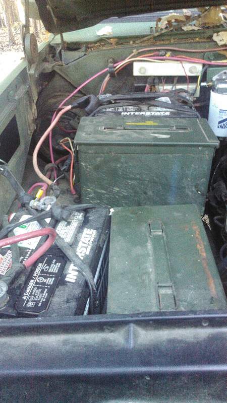

I drove the truck into winter. I had only had it for a couple months and I had my first problem. I went to start the truck and nothing no power.
So charge the batts the back one was way down. These where big truck pro brand batts they filled the entire tray. I got it started and it was on for a few days. I checked every wire on the truck and all where good. After it happened a few more times I bought a new battery and put it on the back tray. That was the problem I guess the battery I took off developed a bad cell.
So now the truck a a pair of interstate batteries. With about 1200 cranking amps and 850 cold amps. These batteries take up half the space. Meaning I could put both on a single tray but it was a little tight so I added some storage.

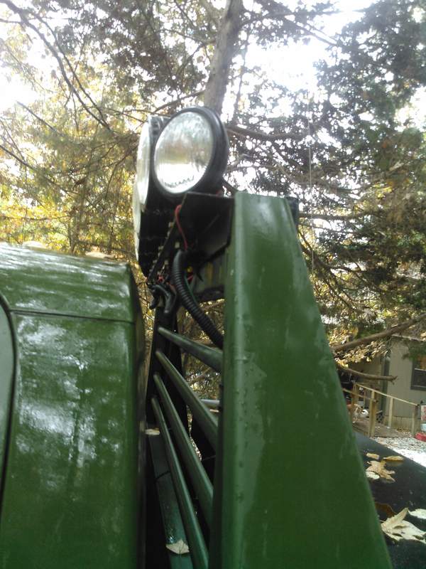

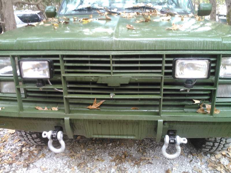

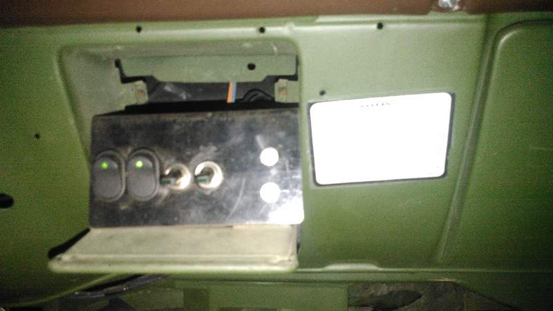

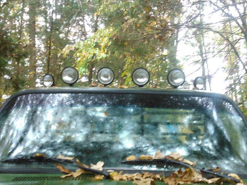

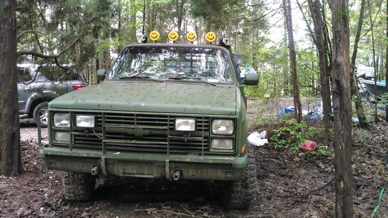

So I had always wanted to cover my ride in off road lights.
So come Christmas I got a couple sets of kc lights from my dad.
I had been doing 12 volt electrical for a while so light and fuse boxes where nothing new. I have a small fuse box under the hood. Then the lights on the brush guard has a switch, the 6 up top have one and also 2 extra switches for later use.
Up too I have two 160 watt 6in KC daylighters, two 6in 100 watt KC daylighters and two 5 in KC Apollo's on the ends.
I mounted them to a piece of angle iron I bolted to the head ache rack.
In the brush guard I used two 100 watt new old stock eagle brand 4x6 light I found at a 4x4 shop.
I will post better pics of the lights soonKIMG1021.jpgKIMG1022.jpgKIMG0999.jpgKIMG1031.jpg

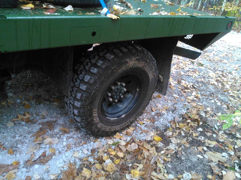

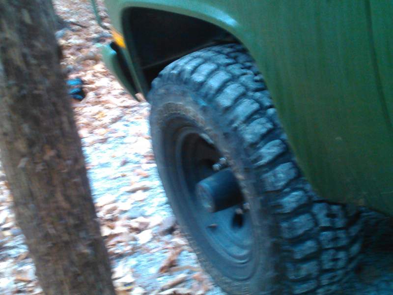

The truck had the stock wheels and a set of 285/75-R16 tires that where bald. So out with old and in with the new. I found a set of Mickey thomson aluminum wheels that where polished aluminum. They where less then a month old and I got a whole set for what one wheel would cost. So I had them powder coated semi gloss/flat black. Then a new set of 285/75-R16 federal mud tires. The wheels a little more outward offset than stock but I like them and the chrome lug nuts make them POP.

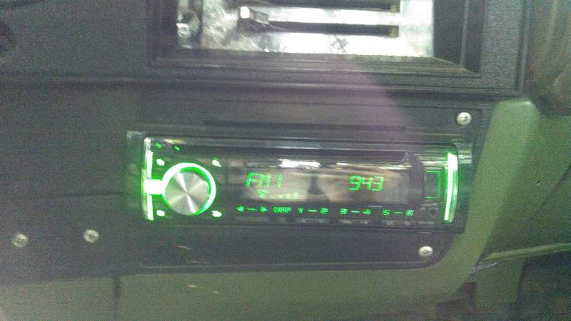

I had plans off putting a stereo in the truck since I got.
So my dad got me a pioneer head unit and some 6x9 speakers for Christmas. Then I got some 2.5 in high output JL audio speakers later on. So I installed the head unit in the correct spot, the cutting of the dash was a little trick but the radio had a large trim piece around the front. I used a small air saw and worn out blad to slowly cut the hole. I just held the bracket for the unit up marked around it cut the hole small then slowly opened it up.

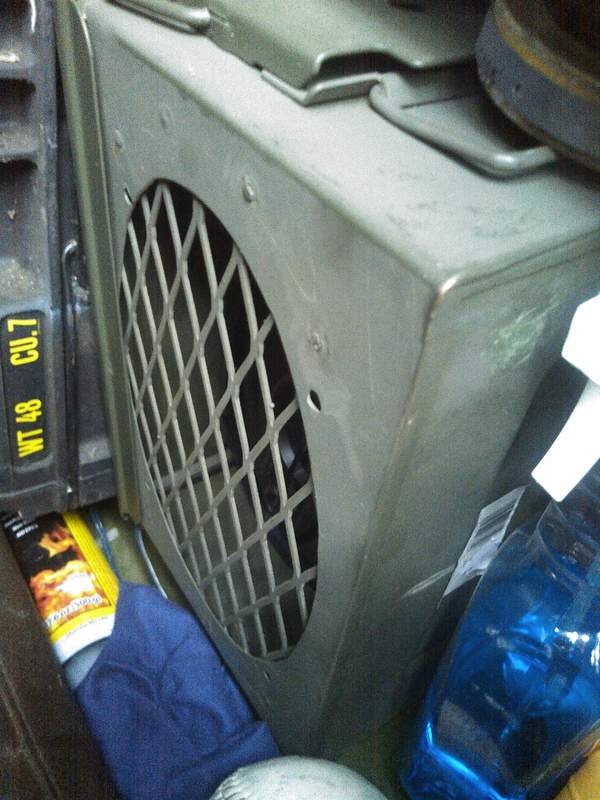

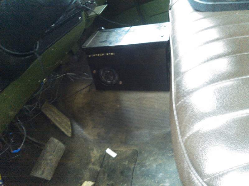

I needs a good way to mount the speakers that would look good, be tough, and cheap. So to my local military surplus I went and I ended up with a few ammo cans. I mounted one becide the 4x4 lever with the 2 small speakers in it.
The 6x9s got a box each on each side just sitting behind the seat. I cut out holes for the sound and welded flat expanded metal to the inside for nice clean look. On the speakers behind the seat I left the wires long enough that I could set them on the flat bed and play music outside the truck.

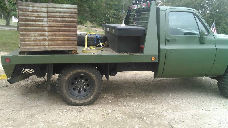

When I got the truck it didn't have any tools boxes. I had packed so much junk behind the seat it would not let back. So my dad was putting boxes on one of his shop trucks and we changed the way that some would mount so we happened to have a tool box laying around. The box is usually mounted in a standard pick up bed.
It is not the best but it works for now and it was free to me. One thing I really like is where the box is mounted so that the lid will open I get a nice cubby hole between the tool box and head ache rack. And the pieces on the sides keep stuff from jumping out.
When I tool that picture I had about 2200lbs of steel in that box

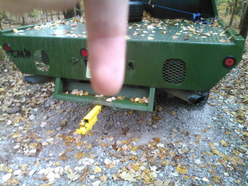

The bed was on the truck when I got it. The Arkansas state forestry service put it on there. They used the truck to pull a low deck gooseneck trailer with a couple mowers on it. The bed is welded to the frame and they actually added some braces in the common areas that the frames can crack back there.
When I installed the radio I was trying to give out which color to set the screen since have every color there is and the green was it needed to be.
I will update the radio post with better pics as soon as I take them also with more information.

The truck had a sucky exhaust when I got it.
It has been redone at some point and not in a nice way. It had 2.25 pipe from the manifolds to the Mufflers then 1 3/4 in diameter pipe on back. So I looked at threads on exhaust and videos on YouTube for straight piped exhaust on a 6.2. I decided that I needed to break out the sawzall and do a custom redneck fix. I cut the pipe off at back of the cab. It was super loud and you could not sit in the truck with it running because you would start to feel sick. So I went to the Muffler shop to get my pipes taken care of. I had a full set of 2 1/2 in straight piped true duals ran all the way back. Then some 4 inch diameter tips that are about 2 ft long on the ends. The entire job was about $300 total which i didnt think was bad as the tips cost over a hundski and they did have to get creative around the T case.
