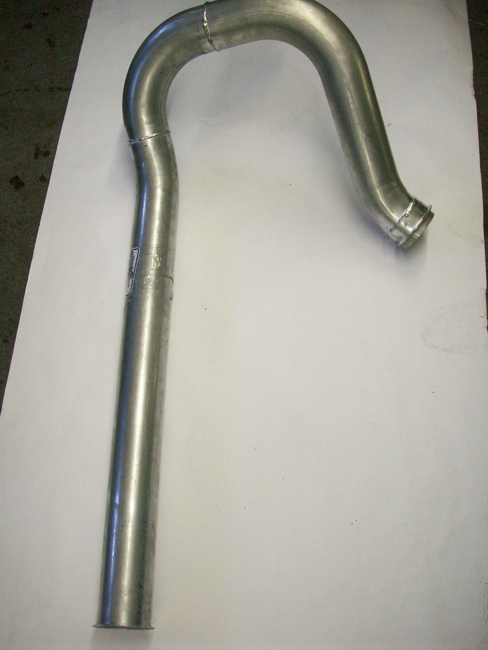

I just attempted to install a new j-pipe and ran into a problem. The new pipe is one of the newer ones that has welded sections instead of one continuous pipe. Well, after having issues getting the pipe in place I compared it to the original and they are a little different. The end that goes toward the turbo is angled slightly different and is an inch or more longer. This makes the flex pipe from the turbo too long to fit in between. I collapsed the flex pipe as much as possible but it is still too long. Has anyone else run into this or did I just get one that was built wrong?

Pic's would help, you are bolting it all together before tightening anything up right?

Where did you get that pipe?
I've not seen any that look like it.
It looks like a poorly/cheaply made replica.

I purchased one last year and had the same issue. I had to cut it and shrink it. At first I managed to get it in with the use of four letter words and way too much time wasted, but I couldn't get the flange on the fender nor the hanger underneath aligned because of how long it was.

Did you cut out a section in the straight portion of the pipe or at the bend near the flange?

I took mine out at the bottom of the "J". But that's where mine was different from my original. I put it on the truck, cut it till it fit, tacked it together and then removed it and finished welding it.

I put a new one in my Deuce last winter, it too was a little too long. Lots of cussing, finally got it in, wrecked my arm and pinched the crap out of my finger, and the pipe is right up against the outer edge of the cutout in the fender. I don't suppose it's easy making a pipe when you don't have the original design dimensions. Still seems like it should be closer that what you are seeing though.

Well, I finally have the new j-pipe installed. I cut out a 2" section and welded the pipe back together and then it fit. But the fun didn't end there! I got everything repainted, bolted back up and then went to put the stack on. Would you believe that the flanged end was too small for the stack to slide in? So, I had to take everything back apart and cut the flanged end off of the original pipe and weld it on to the new pipe. After spending most of the day fixing this poorly made j-pipe at least it is done and my huge exhaust leak is fixed.
Warning to everyone: Don't buy a deuce j-pipe from NewStar unless you need to practice your welding.
