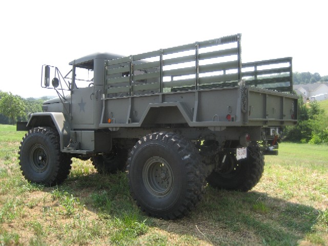

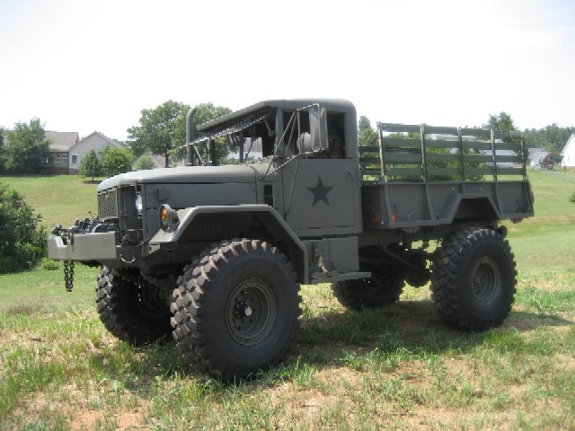

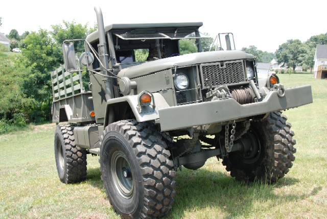

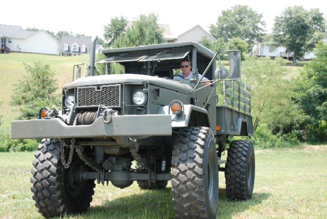

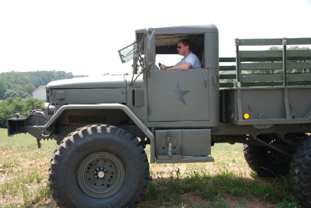

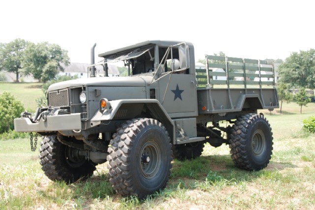

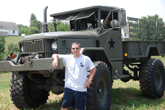

well, just wanted to introduce the newest asset to the community. :grin:
specs:
  • 16.00-20 XZLs
  • hardtop w/ visor
  • winch truck
  • rear 12k# electric winch
  • 6" lift springs
  • PSC hydro steering kit
  • OEM ultra lockers front and rear
  • OEM lockout hubs
  • custom rear traction bars
  • stock multi (for now...)
special thanks to:
Scott (tie6044) - for getting top notch OEM parts at unbeatable prices
Eric (heavy)- for putting up w/ ever-changing schedules and making delivery happen at rock bottom pricing
Jim (cavemantrucks)- for your hard work in putting this truck together to my exact specifications and going the extra mile with only top-quality in mind
some photos (more in my albums):

Do you think if you would have used the same size tires that acceleration or top speed would increase? How much weight do you think you removed?
mudguppy
1,587
15
duncan, sc
Do you think if you would have used the same size tires that acceleration or top speed would increase? ...
i don't understand the question - what size tires, stock size? if the stock tires were used, i would most definitely think that the acceleration would have increased, probably substantially. probably not a real gain in top end, however, since you'll still be limited by rpm.
... How much weight do you think you removed?
between what was removed and what was added, she's at 11,000 lbs now - so about a 2k lb saving over a stock cargo. would probably be just under 10k if stock tires and suspension was used.

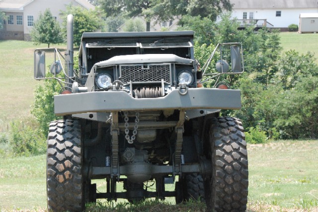

The custom springs you used in the front . could they be used in the back instead of the blocks? are they strong enough? the front is heavier than the rear correct ? I really like the way the front is done they look like belong there.
mudguppy
1,587
15
duncan, sc
thanks for the compliments.
The custom springs you used in the front . could they be used in the back instead of the blocks? ...
yes - it was an option. i chose to go with the stock-height springs and blocks because i knew that the traction bars would take care of any axle wrap. and with a light rear-end, i wanted a relatively flat spring to keep a good ride. so i saved money, eliminated axle wrap, and am happy with the ride.
with the amount of slop in the driveline when off-roading, i'm sold that every bob'd deuce would benefit from having some sort of traction bars / locating links on the rear.
... are they strong enough? ...
yes - the rear springs are deuce front springs. while i don't know the spring rate of the new front springs, i would have to assume that they're similar to the stock spring rates. so they would be 'strong enough' depending on how much weight you want to carry in the rear.
... the front is heavier than the rear correct ? ...
yes. i haven't been to the scales, but another member with a similar setup reported around 7400 front and 4000 on the rear. i believe my truck had similar weight numbers.
however, since the engine/trans swap, i estimate that i have lost about 500 lbs off of the front. i need to hit the scales, though.
