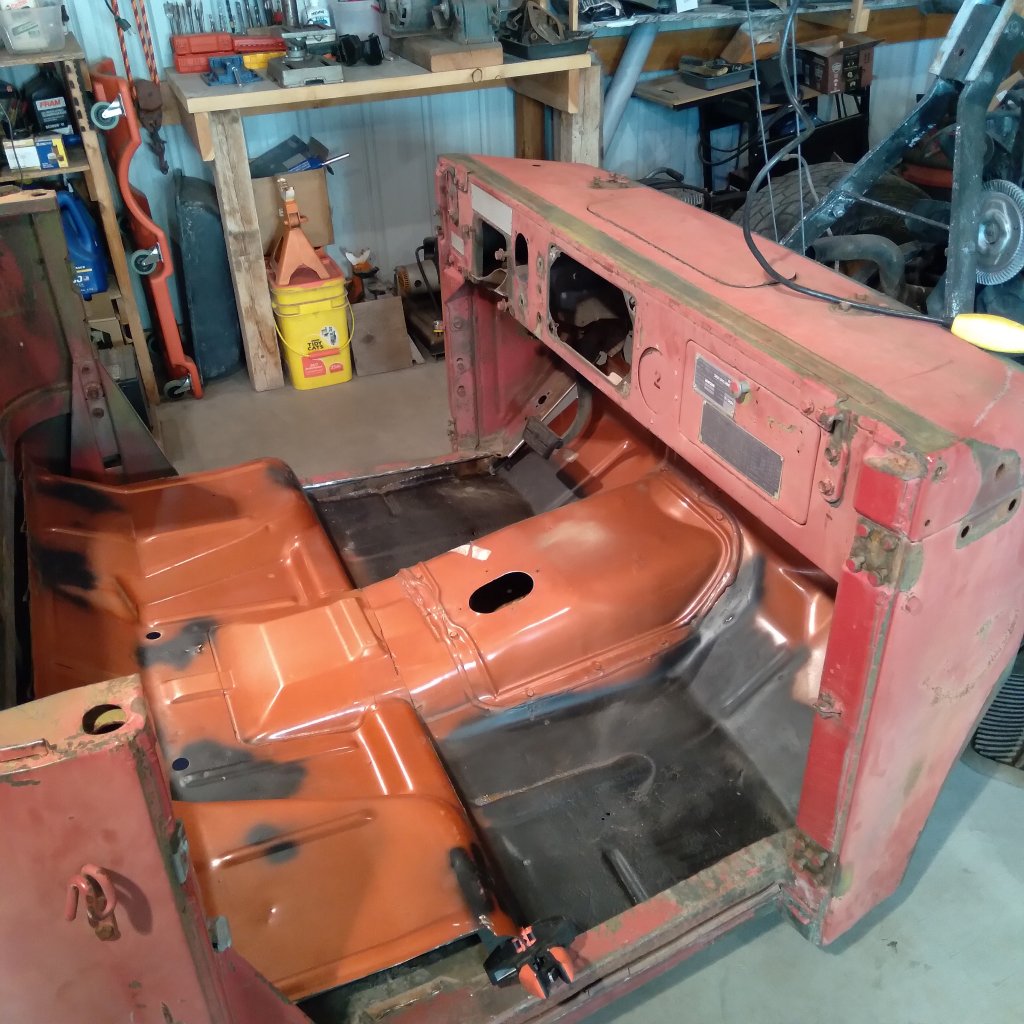

I'm doing a restomod '58. It's well on the way at this point. Using a '78 3/4 ton Chevy Camper Special as the donor truck. The end product will be almost entirely stock Chevy so parts will be easy and driving it will be substantially more functional than a stock M37.
I deleted the saddle tanks on the Chevy and shortened the frame 19 1/2 inches. I'm using a stock 31 gallon tank from a Blazer. The instruments will be after market including a GPS speedo/odo that will fit in the original dash of the M37. The tough part will be splicing the floor and firewall of the Chevy into the cab of the M37, and the cutting and fitting is now done and the welding about to begin. I'll also have to use a yet to be determined radiator, and am looking at options. Suggestions are more than welcome. Seriously, if anyone has a line on custom radiators I'm all ears.

Just checking in. The M37 cab morphing into the Chevy floor is proving to be a bear. Trying to seal all the differences and make them all watertight is frustrating. I'm going to use fiberglass once the metal is all welded and stable to cover gaps that it would take a lot of fabricating to do right. Once the carpet is in, no one will see it anyways.
