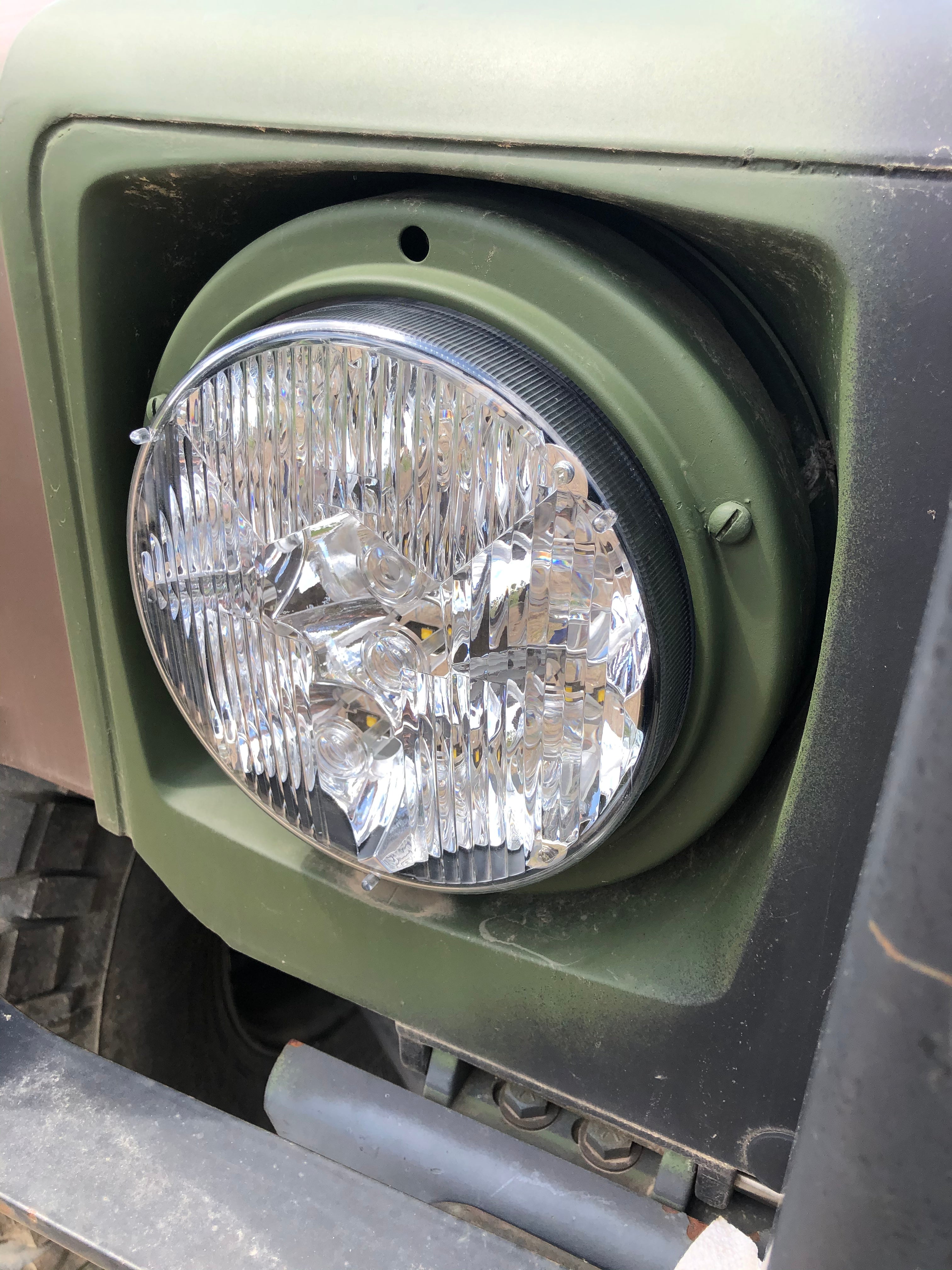

Hey Guys,
I am having a similar problem and hope you guys can chime in.
HMMWV M1123 A2.
The OEM pass side lamp dim-did not work but BRIGHTS BULB WORKED. Also the pass amber running lamp doesn't work and may be related(?) if its power is downstream from the dims.
I replaced the OEM array lamp with the plug and play LED array on both drive and pass.
Drive side all good. Worked with both dim/bright with both OEM lamp and LED lamp.
Replaced pass lamp assembly with LED lamp.
Same problem as with OEM. Brights come on but no dims.
I am assuming I should just put the meter on "18"?
Looking for some plans of action here.
Thanks in advance.

Well that was fast and weird.
Solved.
I hooked the meter up and everything showed 24v on 17 and 18.
Plugged the lamp back in and it all works-including the amber.
No clue how or why but, I will take it.
