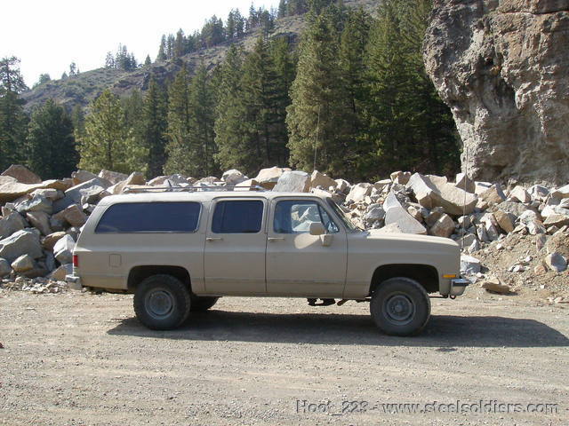

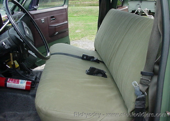

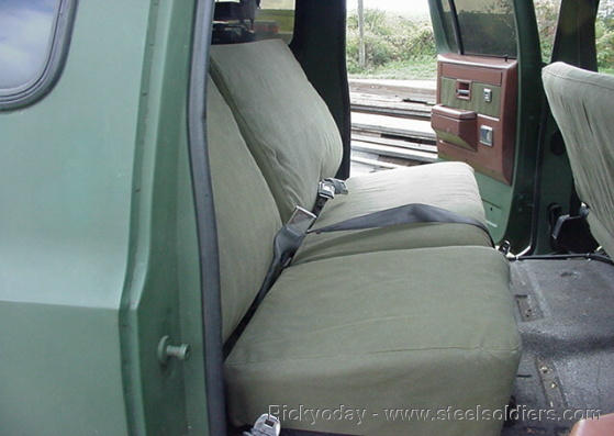

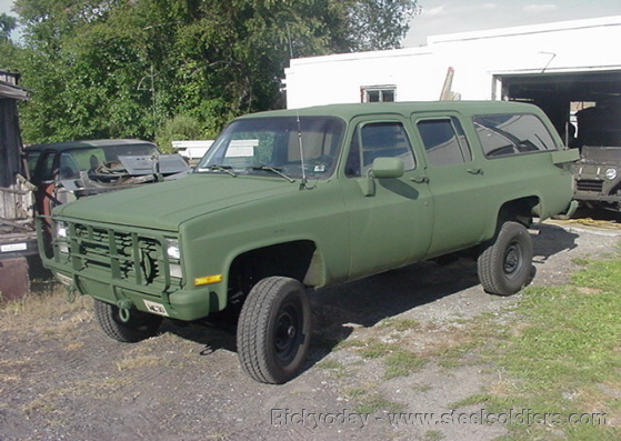

I've had a couple requests to post info and pictures of my Suburban conversion, and I think this is the place to do it.
I've had many CUCV"s over the years, but hadn't seen one that would fit the entire family( in air conditioned comfort). Then out of the blue a friend tells me he has an '86 Suburban for sale, 3/4 ton, 4X4, 6.2L diesel. Perfect! It had 33" tires on it(bald), and aluminum mags, with re-arched springs (with extra leaves) to give it a 4" lift.

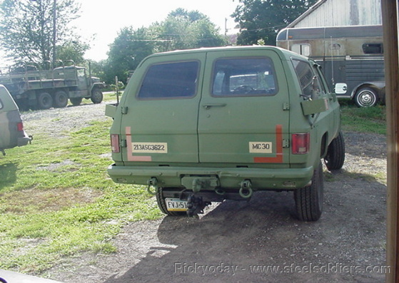

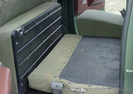

I bought a parts M1009, for all the bolt on parts, and bought 5 M1008 rims and 5 new Firestones to get a correct military look. I went over the entire truck replacing/repairing the mechanical systems. I removed the front bucket seats, and replaced it with a bench seat, and had New Life Canvas make me custom canvas seat covers for the bench seat, and the rear split seat.
I removed all carpeting, insulation, door panel carpeting, headliners etc. The floor was prepped and given 2 coats of rolled on Herculiner, from the firewall to the rear door sill. I also coated the door sills to prevent slipping while getting into the truck. This has worked out very well except where I've worn thru the Herculiner with my heel at the accelerator pedal. I recovered the previously carpeted rear passenger door panels with canvas, and used CUCV door panels for the front doors. The Suburban has power windows and locks, so I "hid" the switches under the armrests.
The Suburban had a 4 headlight set-up, so I used the M1009 radiator support and grille to switch to 2 headlights. The wiring harness is still "4 headlamp", so the only problem left is the high beam indicator is on on low beam, and I just can't get it to work any other way.

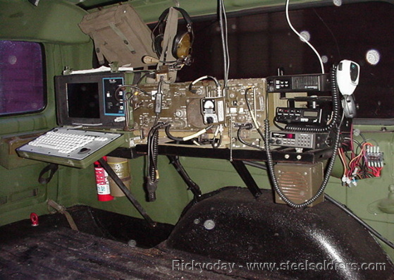

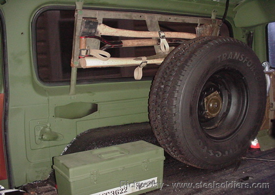

I set the M1007 up as a "Convoy Command & Control" vehicle, so I have an RT-524/ R-422 radios, as well as CB, Uniden Police Scanner, and Motorola 800mhz Maxtrac radios. These are mounted on the driver's side of the truck, due to the spare tire wheel well being on that side, and the M1009 spare tire mount being on the passenger side. I also mounted the pioneer tool rack, and fuel can mount on the passenger side. I mounted cargo hooks in the floor, and footman loops secured straps everywhere. I don't want to get whacked in the head by any flying gear in an accident!

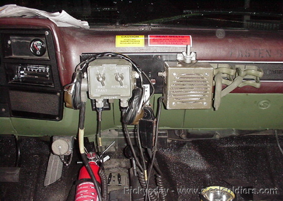

The radio controls are secured with the proper equipment on the dash, since I removed the welded on bracket from the donor M1009, and installed it in the M1007. Also mounted the radio tables, first aid kit, spare fuel can, etc., with parts from the donor M1009.
