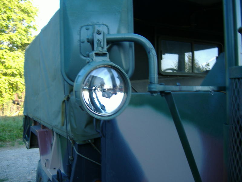

I don't have pics handy to post, but I had added 6 of the armored lights to my deuce. 2 went on the front bumper, 2 went on the bed in-between the bed and cab aimed at the ground, and 2 went under the bed in the rear for backup lights. If anyone is planning on using the armored lights under their bed in the rear, make sure you protect the lights! I managed to rip mine off in about 15min once I took the truck off road. The next set will be bolted to the bed's frame sideways and I will plasma out a hole for the light to shine through. I figure if they get ripped off then, I have bigger problems to worry about.

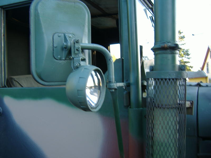

I also got some of the newer style(read plastic) aim-able spot lights, like off the back of a wrecker. I will be mounting one on my driver's side "elephant ear" style rear view mirror mount. It has an on/off switch built into it and I can move it to light up whatever I need light on besides the static mounted lights.

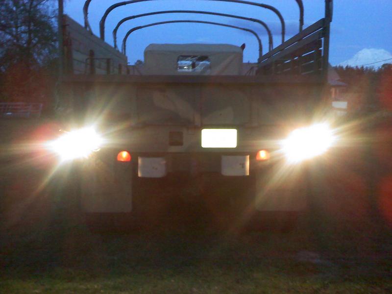

Josh
1,678
12
Portland, Oregon

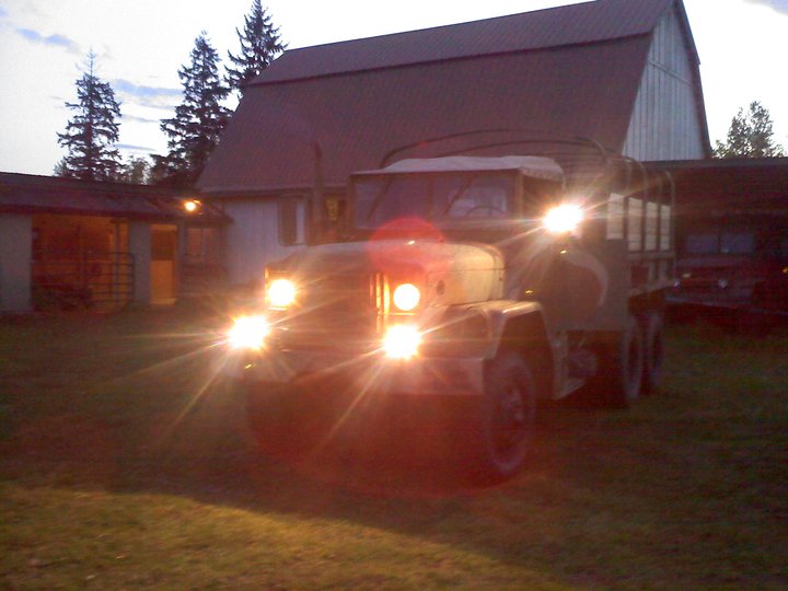

Its the only picture I have. I now have 12 of those lights to install. They are all 100w 24v H4 haligen with a cheapo HF housing and a decent bulb.
whyme
429
angola ny
Josh:

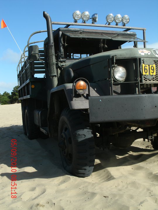

What size are those? Are they the 6"? Trying to get an idea how many I can mount while not looking redic. 6-7 look like it will work for me.
wsucougarx
6,949
65
Washington State
319, great mounting point! I'm still trying to figure out where to put mine. Definately want to try and keep them off the bumper (mounted topside-tripping hazard, mounted underneath-ripped off due to inclines). Do you have a pic on how you mounted them?

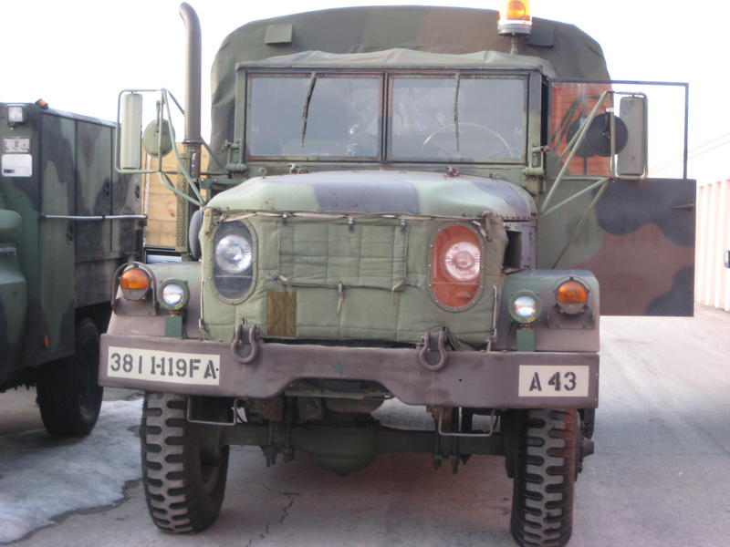

What kind of cab is on the M35(?) in the last picture with the lights off? The windows look rounded off and your hard top has provisions for marker lights and ribs
srodocker
6,549
70
Lacey, Washington
a company here on the west coast made fiberglass tops. its a one piece setup for the windshield and the top is all fiberglass. the marker lights dont work atm. not hooked up. i may switch to my old windshield tho so i can fold out my windows
