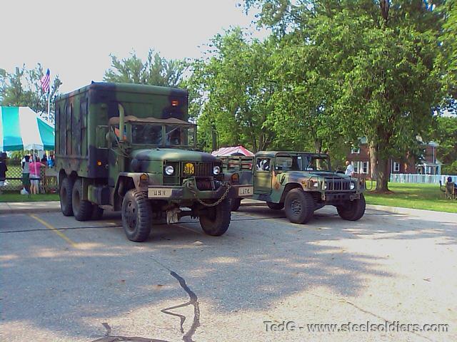

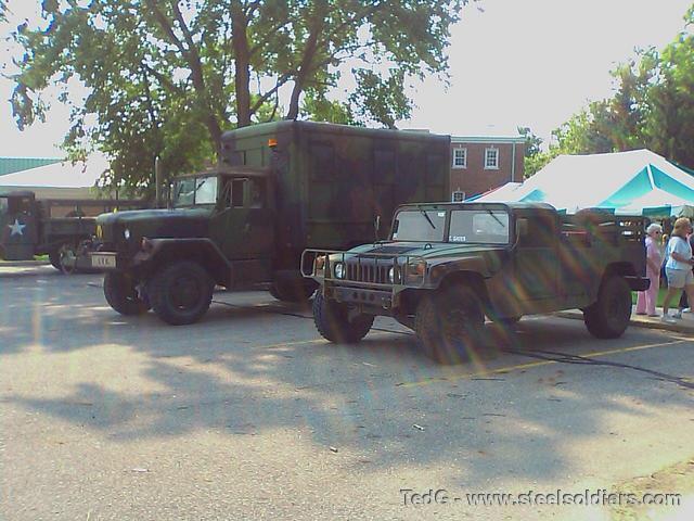

I took the M185A3 and my freind drove my hmmwv to the National VFW Home for their open house. Met some nice people including an AM General employee :shock: He said that he will find the date of the truck and perhaps its history...then he looked at the hmmwv :roll:
Enjoy the pictures.

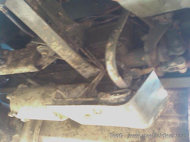

Rattlehead said:
Recovry4x4 said:

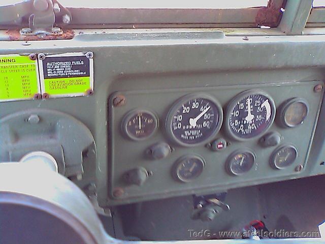

Wow, it's got the split brake system as well, thats just too cool.
How can you tell?

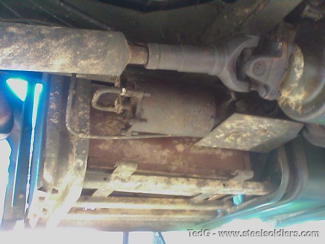

Maybe I'm blind, but I can't tell either. I've looked at the pics several times and don't see any two-chamber master cylinder. I don't know what the air packs look like or where they should be, so I can't tell by that. Enlighten us, please??
Recovry4x4
LLM/Member 785
34,013
1,814
GA Mountains
It has the "Brake" light in the center of the gauge panel. I suppose it's possible that someone swapped in a late model gauge panel but thus far, not seen that.
TedG
1,133
MI USA
Here are the pictures under the truck of the 2 air boosters and the master cylinder. Sorry for the quality but it was early morning and I was laying on gravel in work clothes!

Thanks Lane. I learned to check them from the WC's and M37's. Seems they do get passed over from time to time. Since other fellow MI mv people "can't wait" to see, I better have it cleaned underneath and polished on top! lol!
