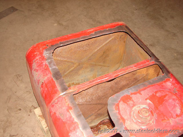

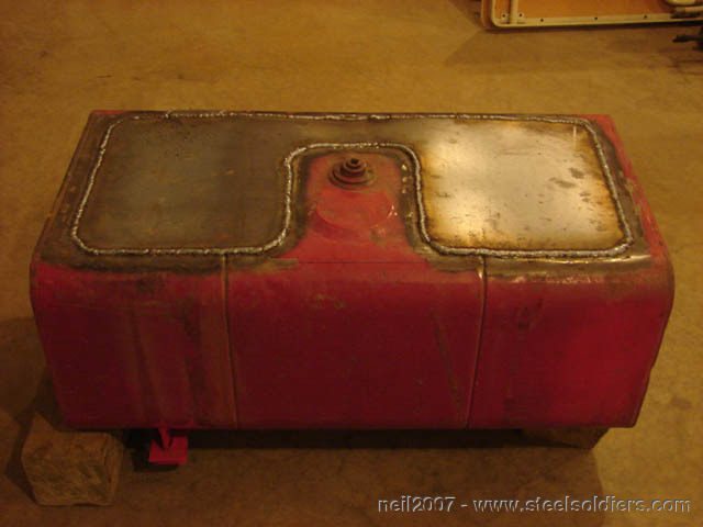

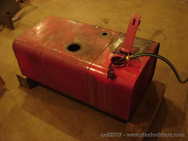

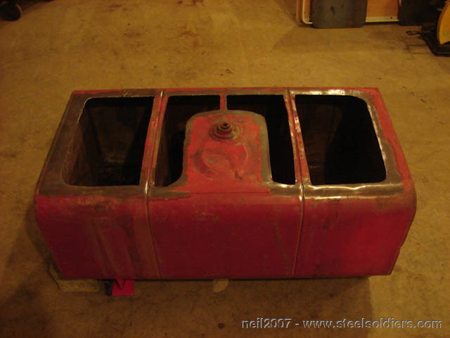

1953 530 B Progress Report... What I did this weekend....
He Guys... Heres the latest progress report as of 10-08-07
For more pics goto Http://www.letsgettwisted.com/530B/
Final Summary: I have one spot where there is any kind of sepage (Not too bad for the first try!) that I need to grind down and re-weld.I think I'm going to drop a can of sealer in ther while I'm at it... Anyone have any recommendations for a good, yet inexpensive, fuel tank sealer?
I also removed all the screws that hold in the fuel sump, redrilled and tapped to take a larger grade 8 bolt. Also removed the fuel sending unit as well. As it came out of the tank, it was completely rusted in place. Could not move the float or rotate the shaft that goes up to the sensor. Both places were rusted in place REAL GOOD. SO I used a dental pick to clean out as much rust as I could from between the gears at the base of the float and slowly tapped on it and tryed to rotate the shaft while applying PB Blaster... I also applied a liberal amount to where the shaft goes into the sensor. After a few minutes it would slowing start rotate. After about 10 minutes it worked just like new!
I guess the moral of the story is... PB BLASTER is GOOD STUFF!!! HIGHLY RECOMMEND IT!
Checked it with my Digital Volt Ohm Meter and it read from 0 to 300 ohms like it is supposed to! The PB blaster didn't effect the rheostat at all!
Other than that, it's time to sand and repaint, install and finish the Electric Fuel Pump install.
Enjoy!
Neil
neil2007
110
Brazil, IN

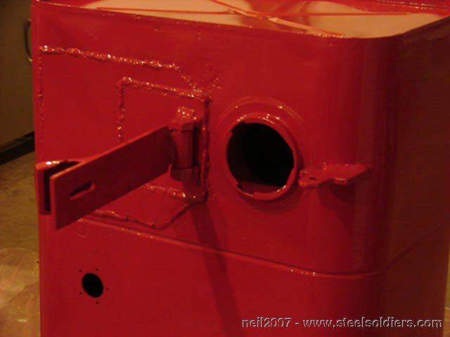

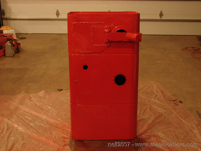

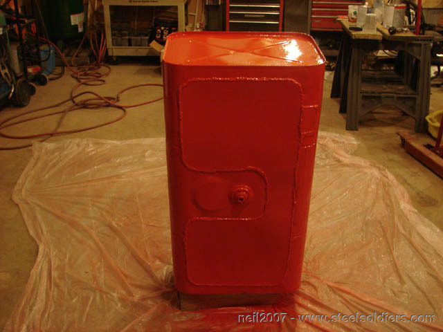

What I did this last weekend... Project Update...
Here is the latest pics of progress on the 530B.
Project Update as of 10-16-07.
Final Summary:
1. Need to clean and repaint section of frame and gas tank supports on the truck.
2. Find a replacement for the pads (rubberized canvas) that keep the bands from rubbing through the tank.
3. Bolt the tank in place and work on running the electrcal for th new electric pump.
Enjoy!
Neil
(PS.... The welds are actually alot better than they look! )
