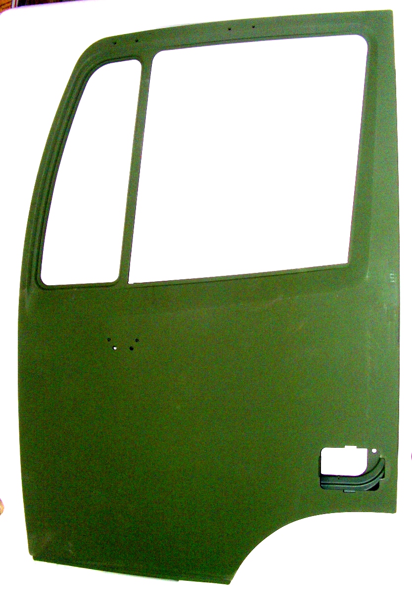

still looking for an actuator on the driver side its stamped with TAGA on it.
i have the part number from the TM but haven't had any luck finding one.
Any ideas or help would be great
PN 12417475 (driver I think)
12417476 (passenger I think)
i only need the driver one

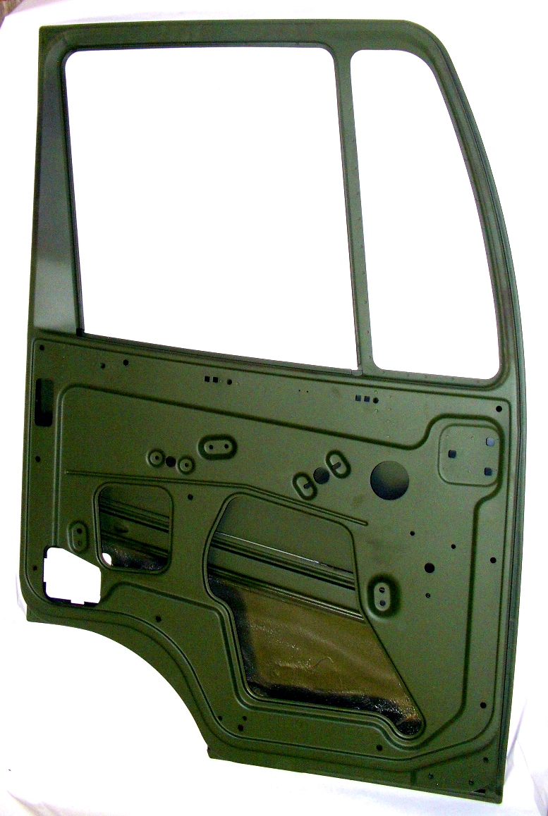

i made two door panels i used a thin piece of steel cut it to size and drilled it then coated it with a lot of plasti dip after paint i cant tell the stock one from mine

I was also missing the actuator on the drivers side. With the help of a friend in the aviation parts business, I was able to locate one at Augusta Engine Parts in Augusta, Ga. (706)736-1288. Part # 12417476 (NSN 3010013757322) is the drivers side, so I would assume 12417475 is the passenger side. Hope this helps.

As far as the door panel goes, I purchased a sheet of Masonite/Hardboard at the local building supply store, used the other door panel as a template, & shot it with OD green paint. Unless you look really close, you can't tell the original from the copy.

I can order the door parts through Steyr Directly. They are new (not new Surplus) and can get them here in a few weeks.
