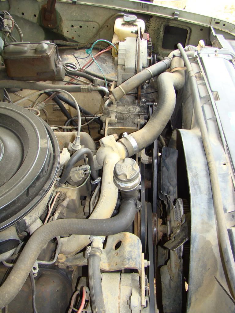

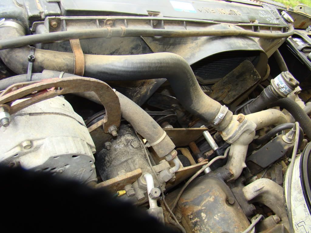

Guys, I have a M1028 that someone added A/C to and didn't do the best job on the pulley setup. The A/C is on the driver's side, and the second alternator is way over on the driver's side. I'm having trouble keeping a belt on the second alternator due to poor adjustment range (long story, can't get it very tight) and possibly some alignment issues.

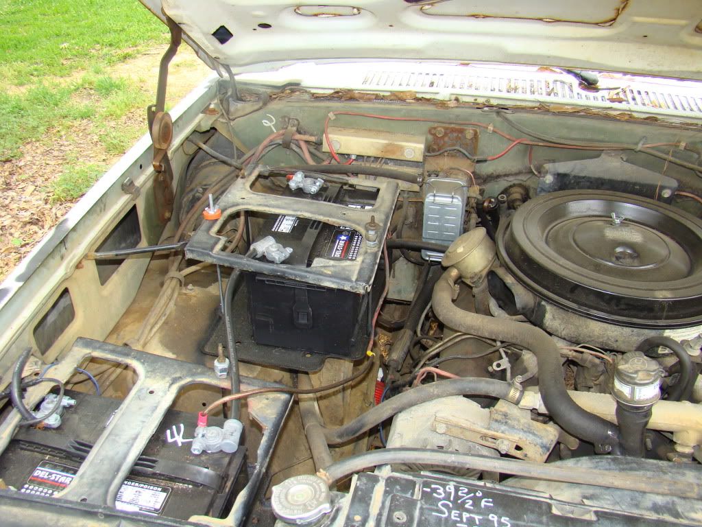

I have searched, I promise, and I can't find a case of someone who still has 24V setup, 2 batteries, and simply runs one alternator. The obvious reason may be that it won't work, which is what I'm asking. The truck also has a 12V fuel pump added. Will both batteries charge from one alternator since it does it on modern trucks? Or does the 24V setup have to have 2 alternators? Can one alternator handle the A/C and the electric pump?

The original alternators in the CUCV are 12V units, so a single one of them cannot charge both batteries in a 24V system. I haven't had hands on a CUCV ambulance before, but if I was in your shoes, my first impulse would be to look for the brackets and other hardware that the ambulances use to mount the AC compressor, and then to fix the belt setup using those parts.

In the CUCV, one 12V alternator charges the lower 12V battery, and the other 12V alternator charges the upper 12V battery. This is distinctly different than in most other military vehicles, where a single 24V alternator charges both batteries at the same time as if they were a single 24V battery.

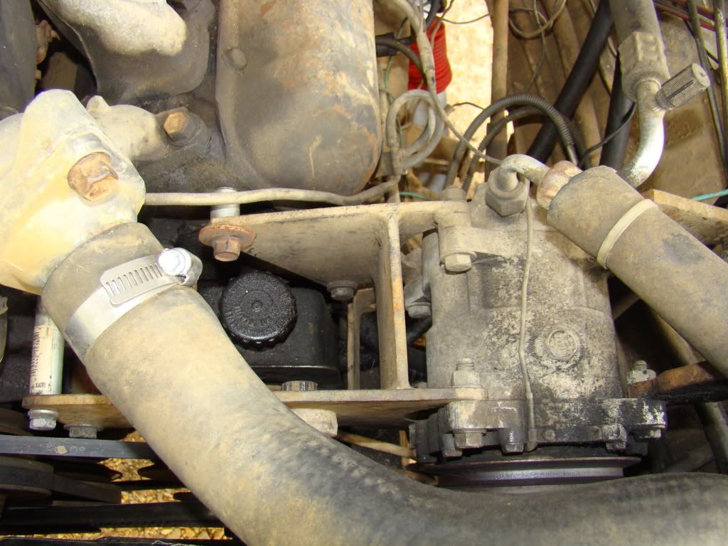

OK, here we go:
Here is the compressor:
http://i148.photobucket.com/albums/s16/vgodenwa/DSC06169.jpg

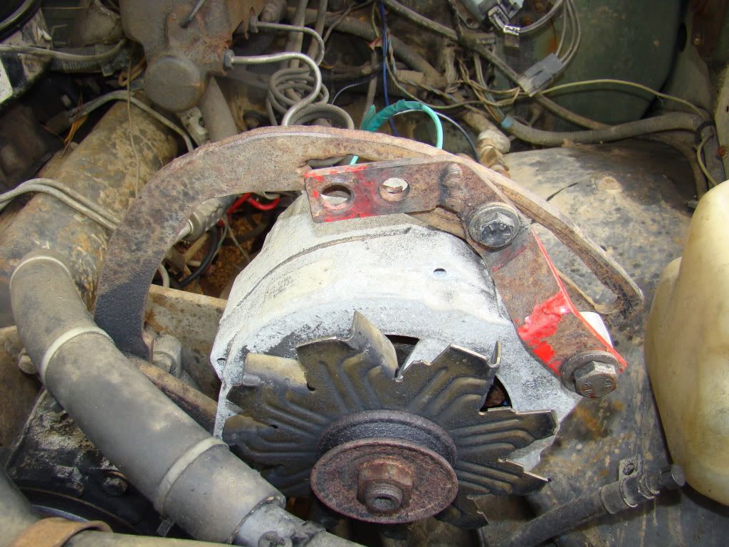

This is the jerry-rigged bracket that won't adjust because it is just a radius instead of actually lengthening the belt:
http://i148.photobucket.com/albums/s16/vgodenwa/DSC06158.jpg
Here are the brackets from behind:
http://i148.photobucket.com/albums/s16/vgodenwa/DSC06162.jpg
Here is an overview:
http://i148.photobucket.com/albums/s16/vgodenwa/DSC06157.jpg
Batteries:
http://i148.photobucket.com/albums/s16/vgodenwa/DSC06168.jpg

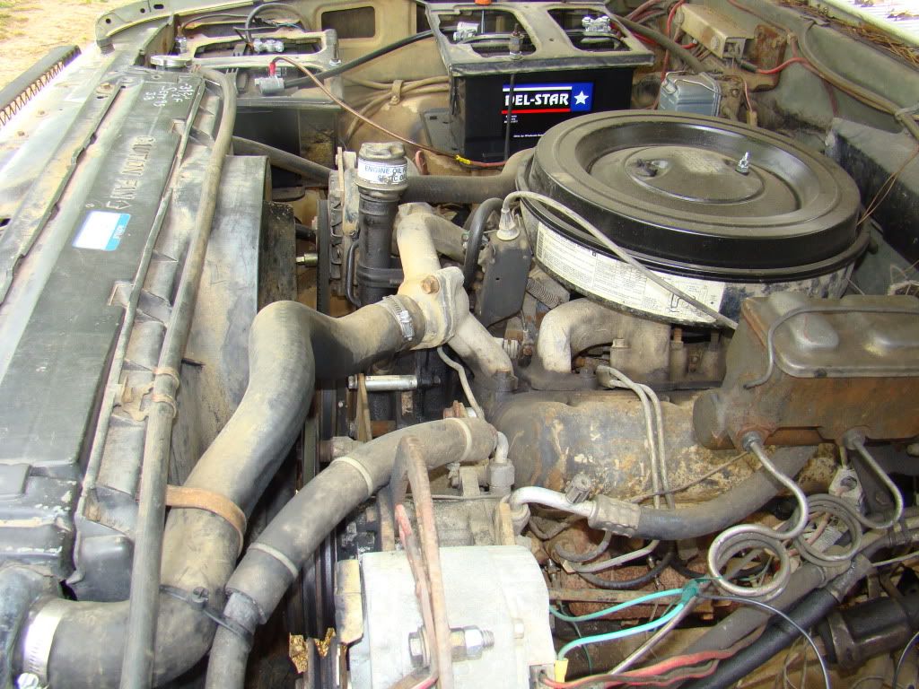

Overview from passenger side:
http://i148.photobucket.com/albums/s16/vgodenwa/DSC06166.jpg
wayne pick
