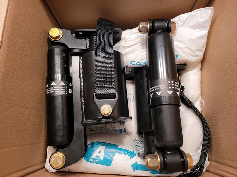

One of my cab airbags grew porous and needed to be replaced. I was able to track down OE replacements to the tune of ~$350 each. It took a while to find them and knowing that they really aren't consumer-based items, I looked at other options. Someone else pointed me to a different (similar) component, but $'s were close to the same and I was looking for something easily replaceable if needed.
Someone pointed me to a facebook ad for an airbag/shock assembly constructed with more commercially available components. It looked compelling, and although it'd be a little more than what two new OE bags would be, it'd be new bags and shocks, and they'd be available if needed. So I rolled the dice.
They are from Ryan Bentley in Utah. Having them in hand confirms that they are certainly fit for duty, and they were a direct bolt-in swap for the OE units. I got them off the front porch ~8p and the job was done by ~11p.
It was 9 days from order to shipment and I think weather delayed their delivery. Everything here was pushed a day or two. Total bill was $1006.
I have yet to run the rig due to some other work I am doing on it, but based on the quality of the work, the care with which they were packed, the thoroughness of the instructions (not that they were really needed but kudos for writing them well), and the communications I've had with Ryan, I am confident they will rock.
Arrival:
Unpacking (new hardware included):
Installed:

Thanks for doing this post. I wanted to let people know about the airbag system that Ryan built as well. Ordered them up and got them fast. Packaged great with fantastic instructions.
Installed them last week and have been testing them out this past week. My airbag had failed so i was driving around with no airbags supporting the cab for awhile. What a huge difference in ride quality. Loaded up a friend and took it for a spin and found the stock setting of the shock felt great.
Huge improvement!

My cab is still tilted up for other reasons but as a lovely feature, there are actually three shock settings. Unbolt the top of the shock, compress fully, twist to select the setting, fully extend, and then re-secure the top bolt. They ship in the soft setting and that's how I installed them. I can't imagine it won't be fine, but you'll have options to firm them up.

As an aside, I have logged ~5k miles since this install and remain very pleased with them. Work fantastically well and seamlessly with the rest of the OE system. No tire rubbing or any other issues. Very happy with the purchase process, install, and performance. I expect that they will last the lifetime of my use for the truck.
Again, no affiliation, just want people to be aware of options as some of our components wear out and get difficult to replace.
