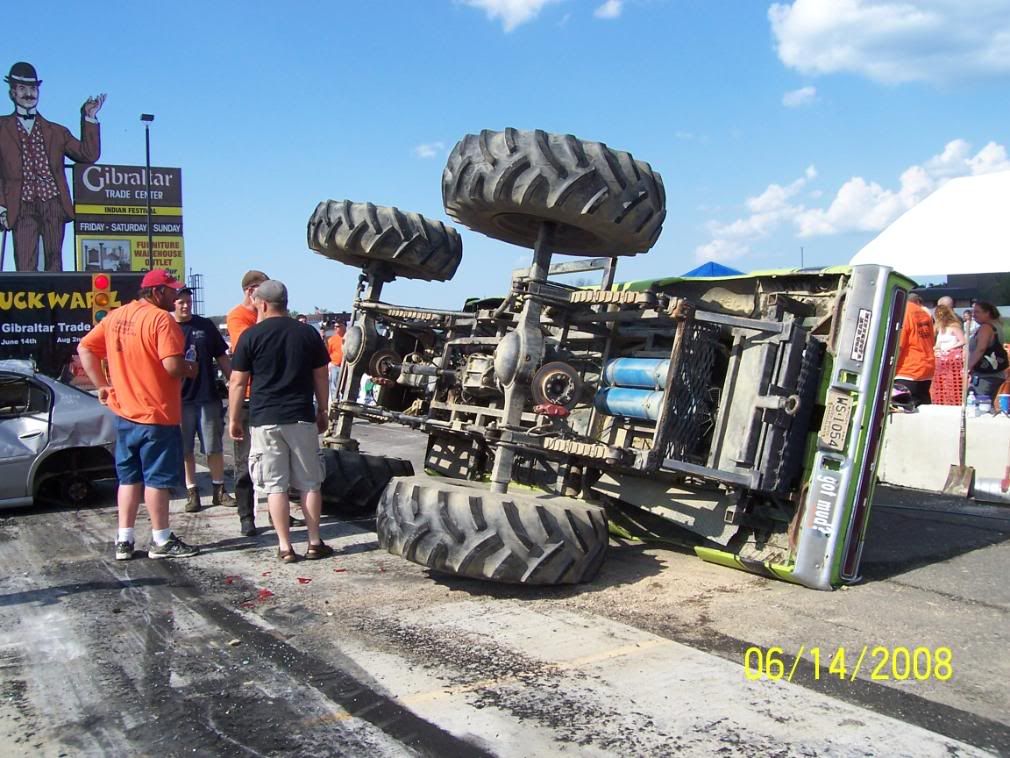

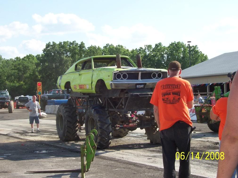

He probably has more, he's a big Mopar guy...his name is Luke, I think he said he's a member here but hasn't been on in a while.
