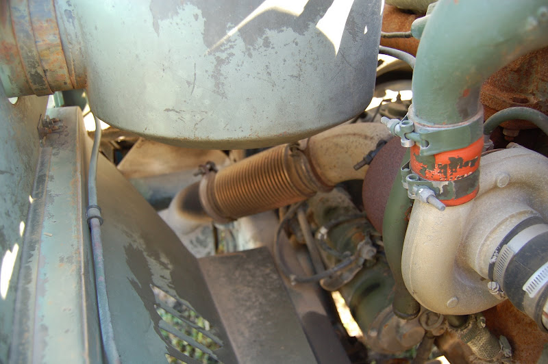

any body have pics of the exhaust sytem and how it mounts when adding a turbo to a non turbo truck? I am in the process now, and the instruction page is worthless, real pictures would be great!

I know all this and have the parts, I just need some pictures of how the brackets bolt up, I HAVE ALL PARTS, would just love some pics from under the air box on the frame rails! If any body can just snap a few pics and post them I can finish this job knowing I did it right!

Now, I have a 1.5 inch angle bracket and need to find where it goes! Is there anyway to get a pic of the flex pipe area and the cut out through the fender well? Thanks so much

Yes it does! I wanted to make sure I cut out the right area, and if I didnt mount anything that might be needed. I have one angle bracket about an inch on each side that I do not know where it goes! Thank you TexAndy!

Sorry for the real crappy photo, just went out in the bitter rain and cold (for FL) and got this with my phone and a lantern. Should help with the small bracket you have.
