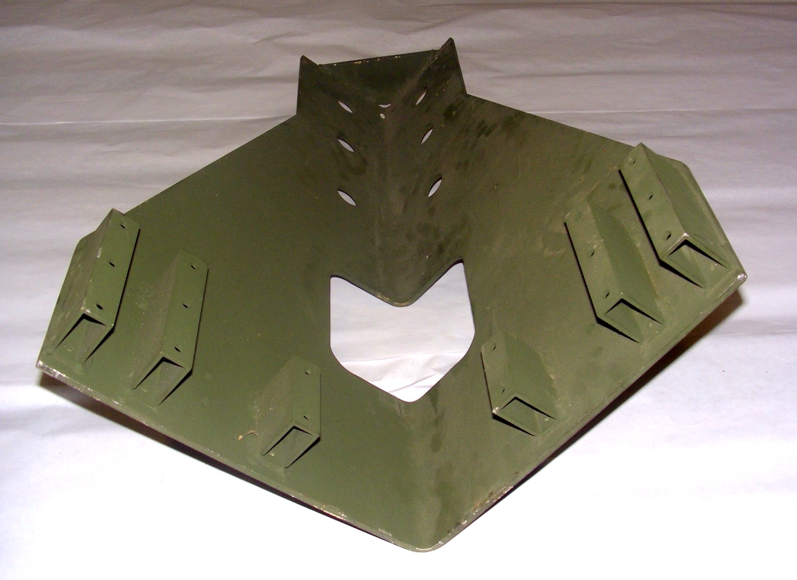

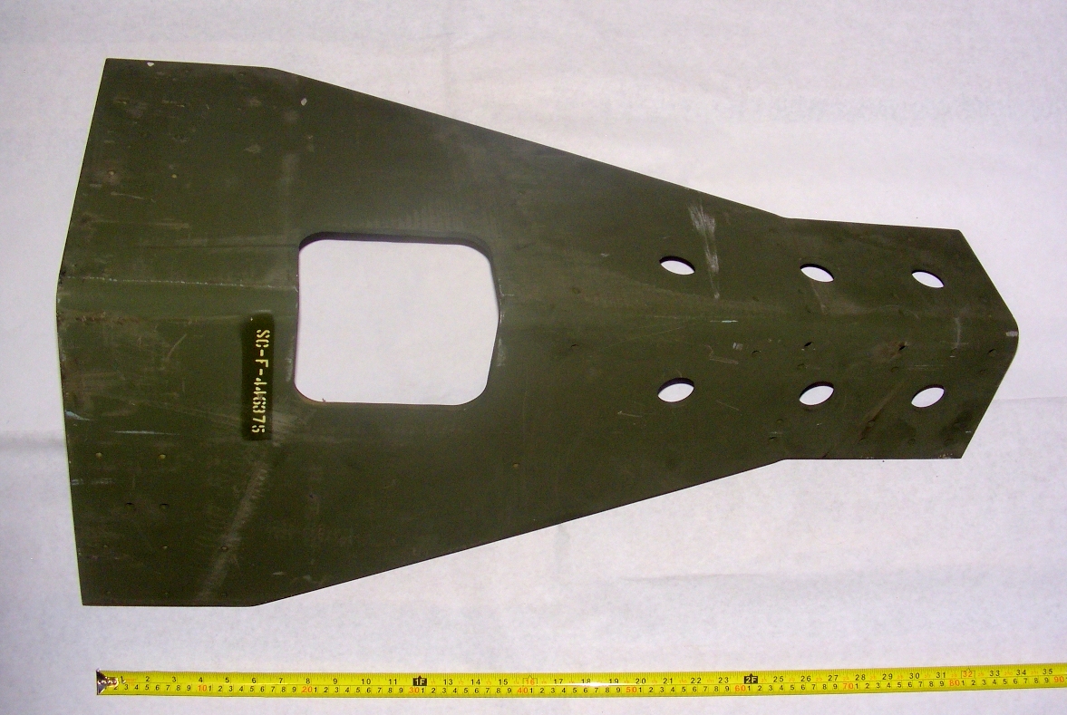

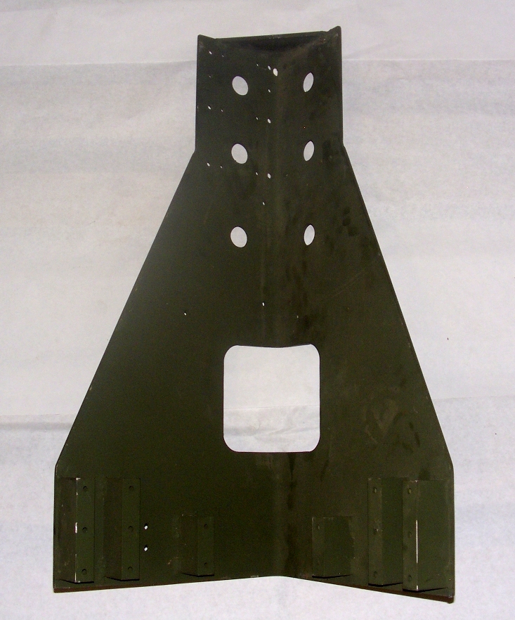

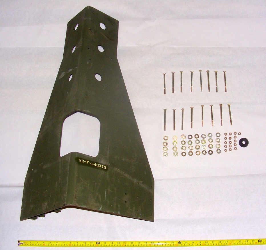

I have a VIC1 mounted, and the VRC series installed.
Very different from a MUTT mount. The mount shown goes on either side of the front of the carrier. The ones that go on the back of the rear carrier-over the tail lights--are harder to find, and the one that goes on the front fender is stupid hard to find.
Once again, I need to get off my lazy-night-shift-working posterior, and get pics posted of my Comm-rig.

Bill,Idaho's Outstanding setup!!!!!!! #1
Hello gents,
One of our very own Goat owners, Bill,Idaho, was gracious enough to send me pics of his Outstanding VIC-1/VRC/GRC setup in his M561. As most of you know, reference materials and pics seem to be absent in this technology age. Unfortunately, the Goat was around before all these little gadgets were in place. So therefore, many potential pics, are not around like the deuce and 5 tons. These pics are invaluable for those wanting radios/VIC-1's in their Goats. I mean I never knew some of these mounts ever existed. I had no idea there was an antenna mount for the driver front fender. Now we all know what these mounts look like thanks to Bill.
Now, Bill has been extremely busy as a public servant. Please keep in mind he covered it up about 6 months ago (winterized), and hasn't touched it since. Thanks for your service Bill!!!!!
