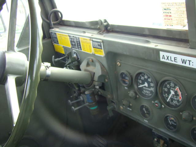

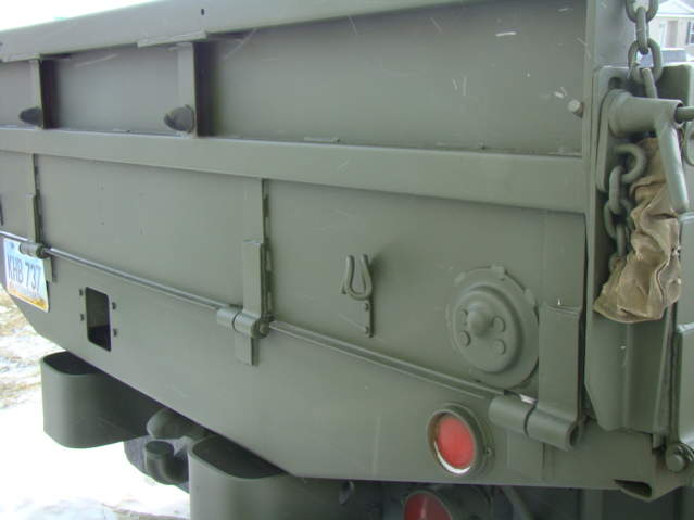

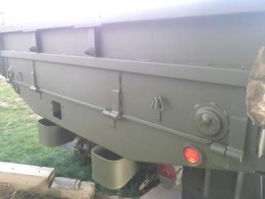

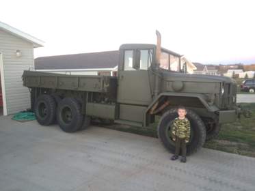

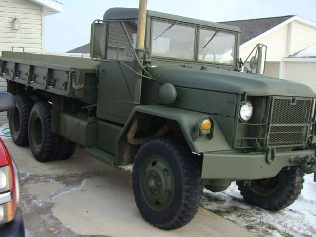

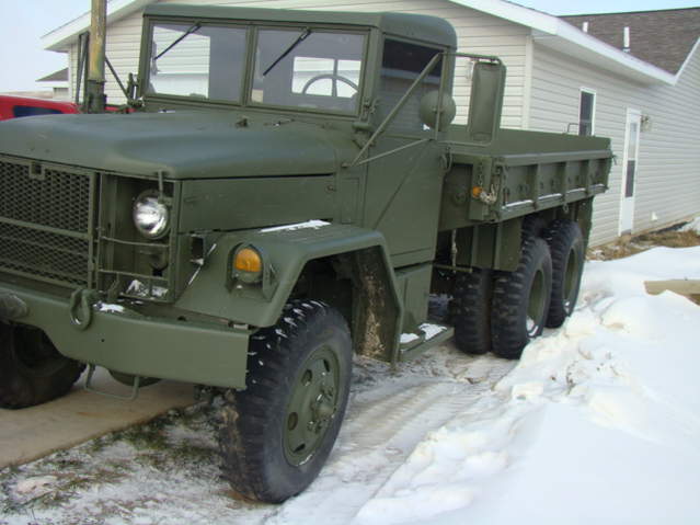

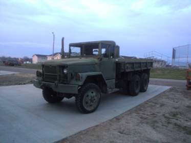

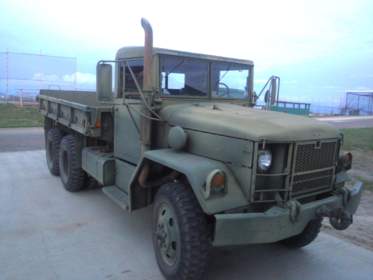

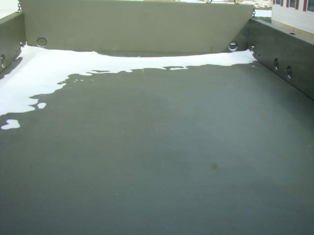

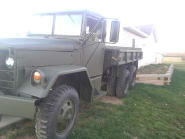

Hi all,
First off, I really appreciate all the info and help on this site. Thank You!!!
I've been wanting one of these for about 3 years, and earlier this year I finally got one.
Title says 1979, it was an Air force truck, power steering, heater, ether kit, drop side, hard top, and there are 2 hydrovacs. The truck shows 6500mi and 336hrs.
I've put new 2 batterys in, replaced a brake light switch, new headlight switch, headlight, bled brakes with new dot 5.
I sanded and sprayed with DuPont 222S adhesion promoter, then painted with Gillespie Coatings 595-34079-11 forest green.
Right now I'm waiting on a Kats 1500 watt tank style heater, but while I was waiting I decided to run the 5/8 lines, the threaded block plug behind the solenoid turned out to be a real bugger.
The truck drives excellent and is a blast to drive, and my wife and son absolutely love the truck.
Thanks All!
First 2 are before paint, next 3 are after paint.

Welcome to the site. Nice looking truck.

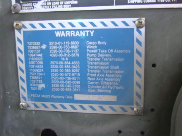

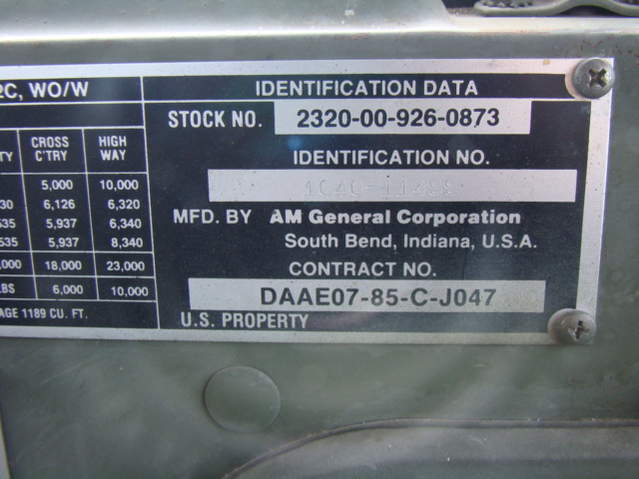

I'd like to know what the VIN is-if it has 2 airpacks, then it's a 1987-1989 model. Pre-1987 (even USAF) trucks are single circuit systems.

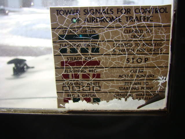

At first glance the truck seems to match up with a lot of the info on the link. air traffic control sticker , rust proofing, no pioneer rack, drop side, air ride seat, seat belts, no slave plug, pintle instructions. bla bla bla.
The vin is 10**11499, and the numbers on the back of the truck are 88K 247
Ive also never seen one with a front pintle hitch.

I'd say the odds are that truck is actually a 1988 model that someone mistakenly titled as a 1979 model.

I just looked at a copy of the sf97 form, and it also shows 1979. So if its a mistake, it goes back to the source. :doh:
From the condition of the truck, and supposed year, I've had a hard time coming to grips with only a couple very small dents, and absolutely no rust! Especially considering it came from Washington.

Welcome from sunny Florida. Great looking truck you have there; it should also have electric wipers if it is in the year range 87-89. The pintle is an Air Force thing for what ever reason they added them. Did your truck have a complete VIN plate on it? Those are sometimes removed or disfigured.

I can an 89 that I recovered from Fairchild AFB and it has vacuum wipers and no power steering. Whom ever you bought it from must have done these mods. Also the front pintle hitch is handy for pushing trailers into parking spaces thats why they were added. Take a look at this months MV contest, you'll see mine pushing my trailer back.

My VIN plate was disfigured and removed (found in the glovebox).
