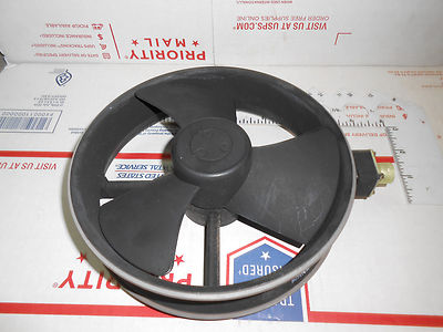

Just bought it off Facebook marketplace. Around 800 hours. Overall in good shape but I noticed the top fan isn’t working. Blown fuse. Removed the lid and it was completely seized from water and time. The motor is rusted and swollen. I checked online and the part can only be had on eBay for $300+. I paid 600 for the generator, shipping alone for the fan is 80 bucks and I’m pretty sure it doesn’t cost 80 bucks to ship something that small. I was hoping to see if anyone had any ideas if it could be replaced with a cheaper fan. Also the fuses appear to be an off size or would a civilian fuse work?
Original owner ran it without it but I don’t want to overheat it.

Get the old fan out and get some good measurements of it. I'm sure we can find you an aftermarket one relatively cheap

And your fan manufacturers
Cross Reference | NSN 4140-00-925-5188
Part NumberCage CodeManufacturer
02074382877ROTRON INCORPORATED DBA AMETEK ROTRON MIL AERO WOODSTOCK
115VAC10-50-60HZ82877ROTRON INCORPORATED DBA AMETEK ROTRON MIL AERO WOODSTOCK
19A171225140GLOBE MOTORS, INC. DBA GLOBE MOTORS
A0-1913982877ROTRON INCORPORATED DBA AMETEK ROTRON MIL AERO WOODSTOCK
A0-3351982877ROTRON INCORPORATED DBA AMETEK ROTRON MIL AERO WOODSTOCK
A0-8196282877ROTRON INCORPORATED DBA AMETEK ROTRON MIL AERO WOODSTOCK
FP176CA0011A182877ROTRON INCORPORATED DBA AMETEK ROTRON MIL AERO WOODSTOCK
FP1T6CA0011A1D9182BOSCH REXROTH GMBH LOHMANN +STOLTERFOHT
FPIT6CA0011A181349MILITARY SPECIFICATIONS PROMULGATED BY MILITARY
M2307/1-001D9182BOSCH REXROTH GMBH LOHMANN +STOLTERFOHT
M23071/1-00181349MILITARY SPECIFICATIONS PROMULGATED BY MILITARY
MIL-B-2307181349MILITARY SPECIFICATIONS PROMULGATED BY MILITARY
SAUCER 467ZH82877ROTRON INCORPORATED DBA AMETEK ROTRON MIL AERO WOODSTOCK
U60A3R19070EASTERN AIR DEVICES INC DBA EAD MOTORS
Looks to be 7 inches in diameter, three wires going to it so I assume hot, neutral and ground. .25 amps but I think it might be okay to go as high as 50 watts.
Edit: looks like farmingsmallkubota has the winner, I went with that. Thank you.

The Technical manuals are at the top TM find the TM 24p will be the parts manual find your NSN and then you can see who ever made that part and the part numbers for for uncle Sam. Guy can guide you through all of the details of the manuals as he is much better than I am although i am getting better
