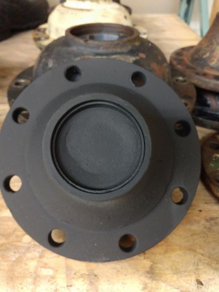

Sounds even better :) - Are these desplined hubs something that is available to buy "off the shelf" somewhere ? Repro or Original item? Thanks
You take a set of hub caps and have the spline machined out .
They come up for sale in the classifieds from time to time . Maybe e-bay.

Cool,
I had a look and found plenty, for around 40 to 50 bucks each - so there seems to be a good supply.
I found some units from this supplier already de-splined, they are a little pricey but do look nice.
The big concern is the last line of their decription stating " These are not recommended for use on trucks with a sprag transfer case. "
Well... this is obviously a big concern! - Anyone have an idea why this manufacturer thinks these desplined hubs should not be used with a Sprag transfer case??
