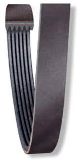

It just occurred to me to make sure I have a spare serpentine belt. After checking the 5 ton parts list, it isn't listed.
Does anyone have a crossover number for NAPA, O'Reillys etc?

It is.
Row 360. All A2 specific parts are at the bottom of the spreadsheet below the A2 only banner

Here is the part that gives the serpentine belt its no slip and longevity qualities.
Belt tensionors fail in all the ways a spring loaded rotating thing fail, subtly/insidiously.
Just cross reference this one and or buy install it to make your things as new. Less problems that way.
