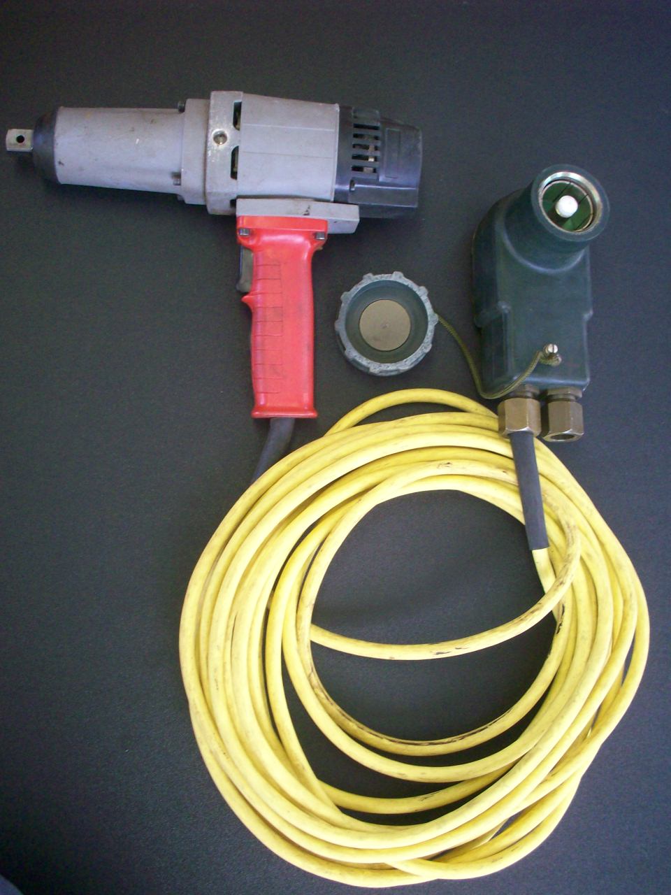

So I'm flicking threw flea-bay and I found 1/2 impacts connected to slave cables made for the military.
how do we feel about these? Are they worth picking up? Does anyone have any personal experience with these tools?
I feel like that would be a good thing to have in the tool box on the truck.

They won't loosen a Budd lug nut if it has been torqued to 1500 ft-lbs (air impact).

The truck in OE condition will give you maybe a good 3-5 second blast w/ the 3/4" Impact.
It is just enough to do the deeds usually.

I have a 24V Robo 3/4" slave cable impact gun. It was issued with some MRAPs. It broke down the spring shackle bolts off of a deuce bogy unit no sweat. These were spring shackles that haven't been touched since I was a PFC in 1970 :0)

I've got a 1/2 inch Robotool, and it came in handy when we needed to change a tire on a trailer. We did have to bust the nuts loose with a cheater bar, but the spin off and snug up went a lot faster, and that counts when you are sitting on the side of the road. I'm keeping mine!

I have a 3/4" 24v impact tool that I find quite handy. It is not a replacement for air tools or cheater bars, but a useful supplement in many situations.
I particularly like it when it is 108*+ degrees outside, and I have a couple of tires to change or whatever. I'm not a young man anymore, so 6' cheater bars look less attractive to me these days, old men like power tools...

I have three of the 3/4 Robo impacts. I keep them spread out among the vehicles. When you need them, they work. I've changed trailer tires, CUCVs, and Deuce tires with them. I have no complaints. However, I would never use them but for short periods and definitely not as a daily tool.

Just keep in mind that these 24V impact wrenches were intended to remove armor plates/ side skirts from tanks/ BFV's/ Strykers. Net really intended for high torque.
