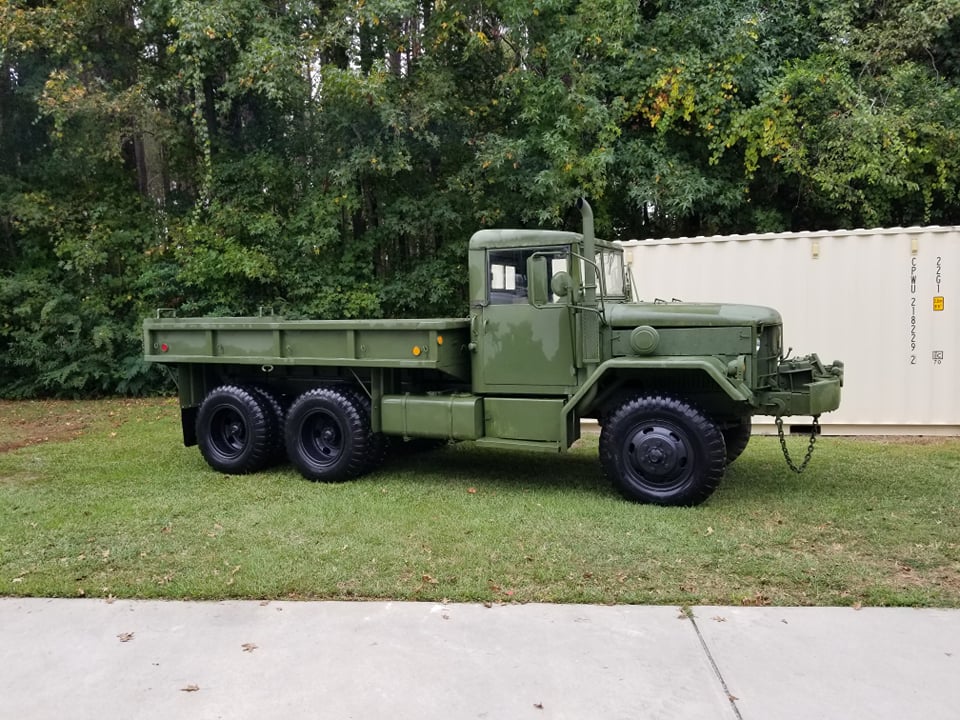

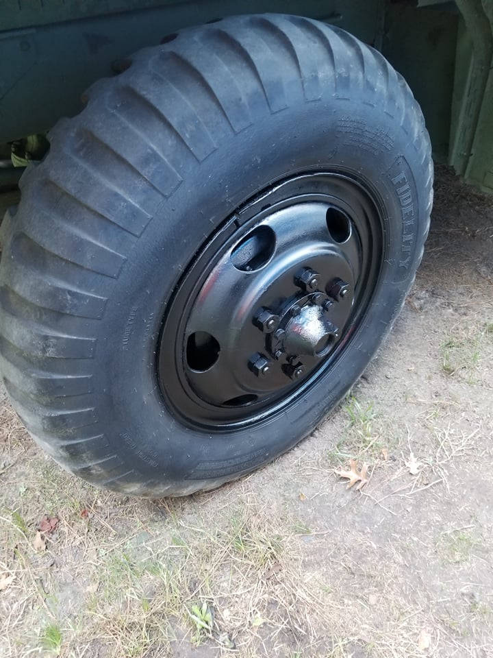

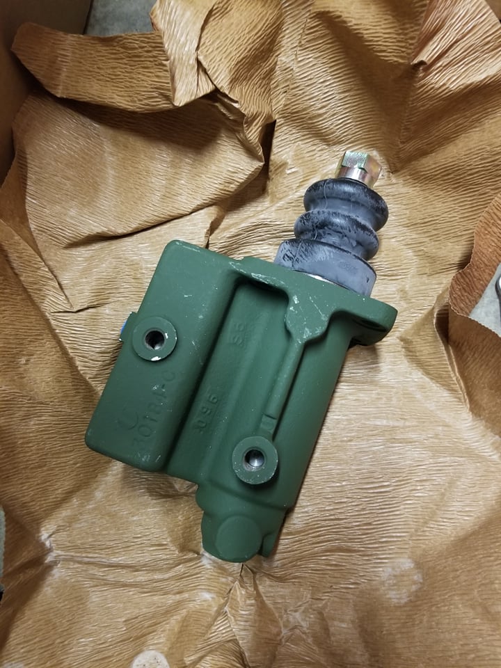

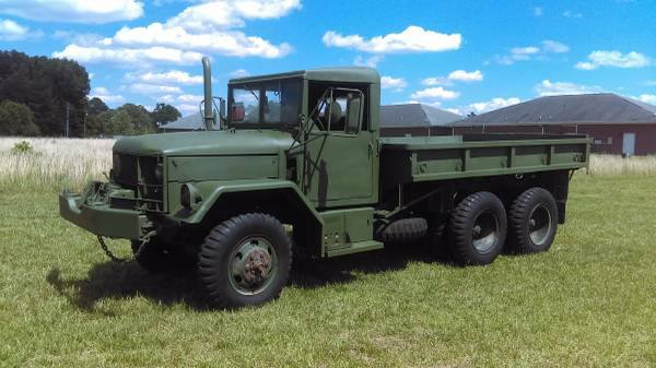

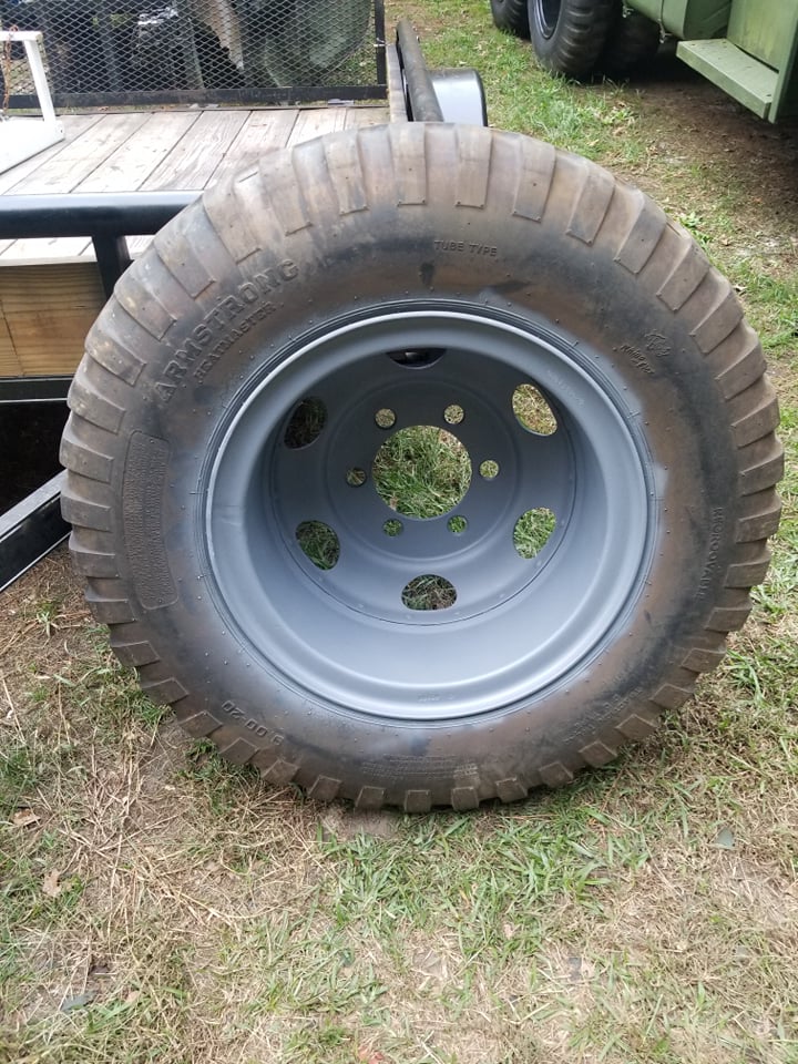

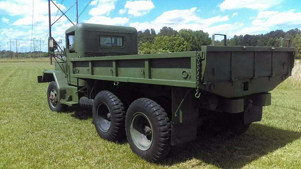

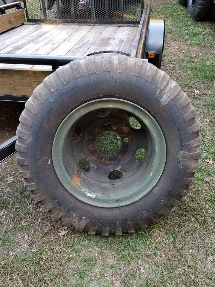

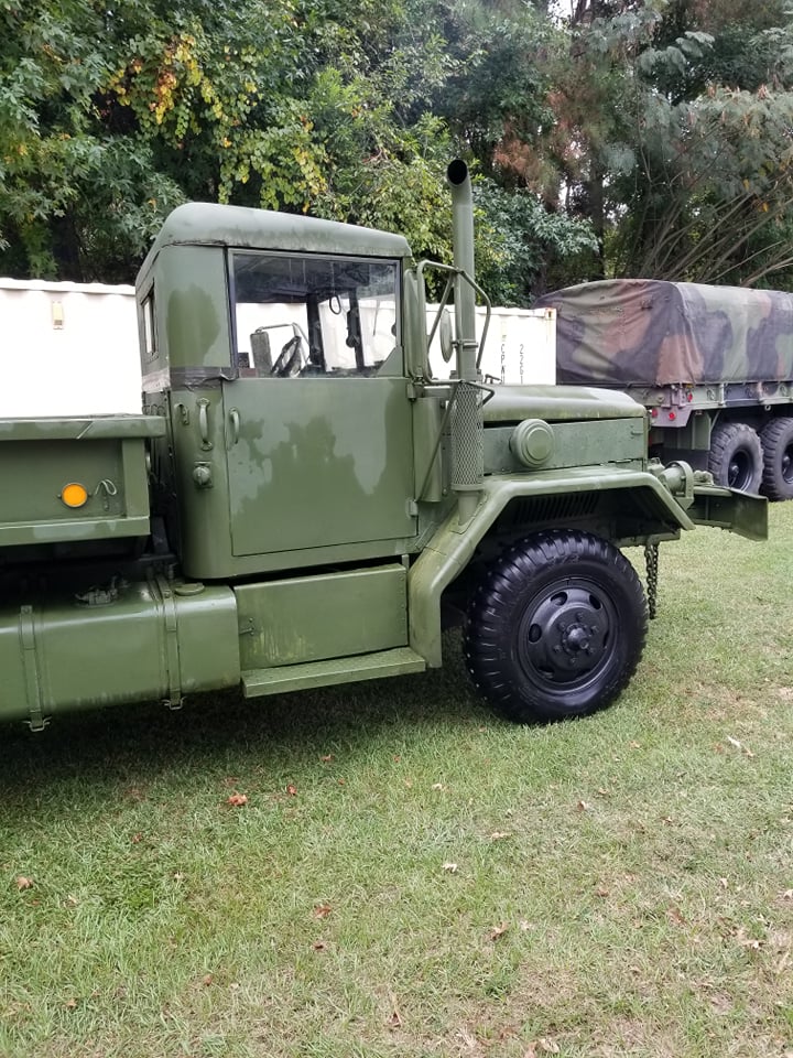

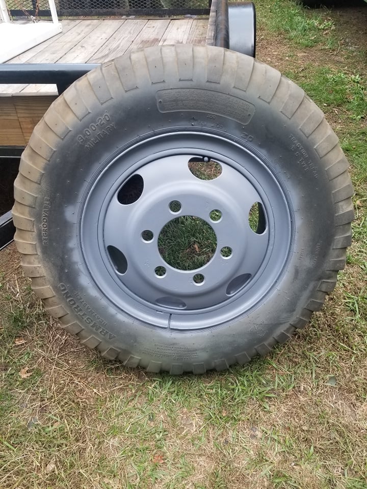

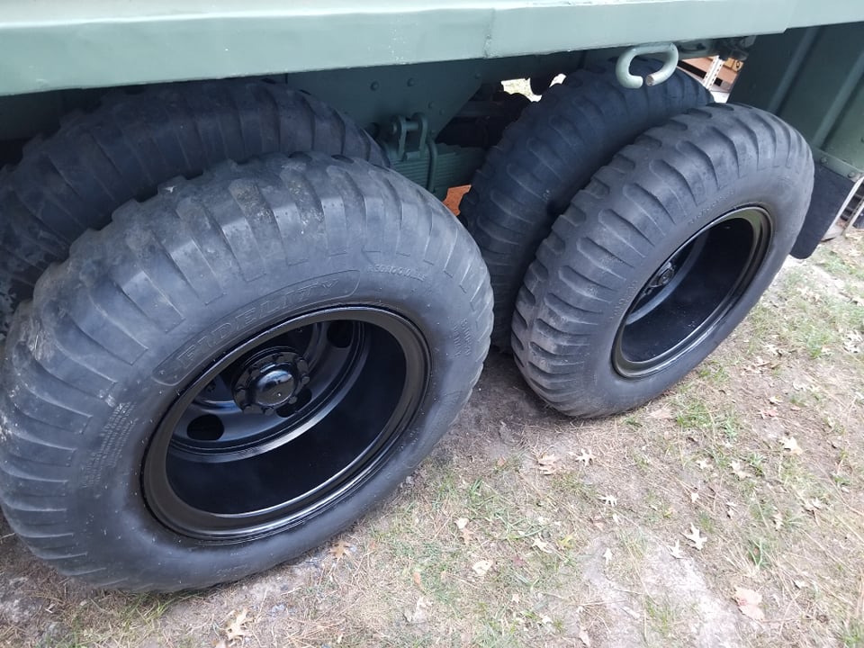

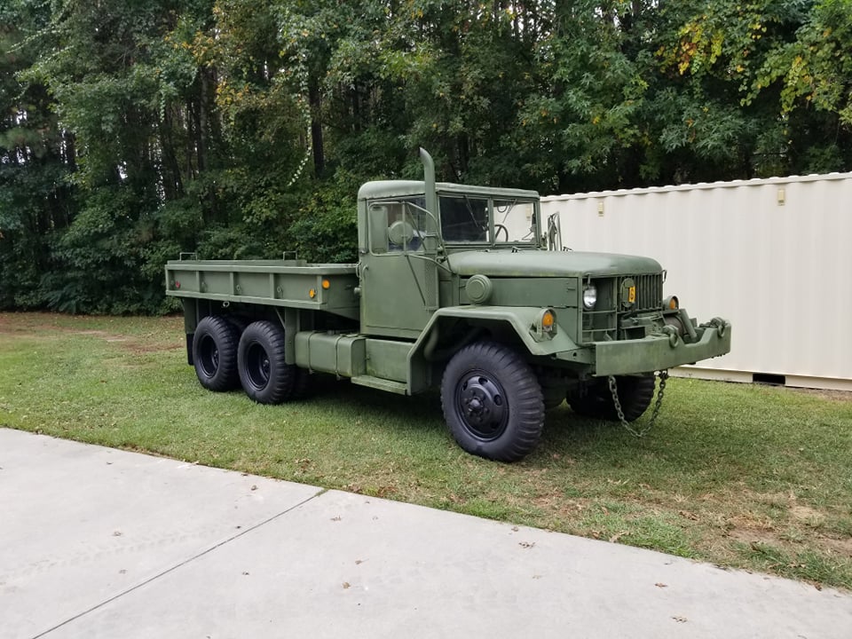

Here is my 1964 M35 A1/A2 w/winch truck, was converted over to an M2 model/multi-fuel in the late 80’s. I have owned the truck now for 5 years. The truck was in decent condition when I got her, so I started with the mechanical stuff to get her road ready. I pulled off all the wheels, removed 40 plus years of paint & repainted them. While doing that all of the brake components were replaced-(wheel cylinders, bearings, seals/gaskets, all hoses, master cylinder, rebuilt the air pack, brake shoes-all) & added a brake fluid reservoir kit to the inside of the truck.

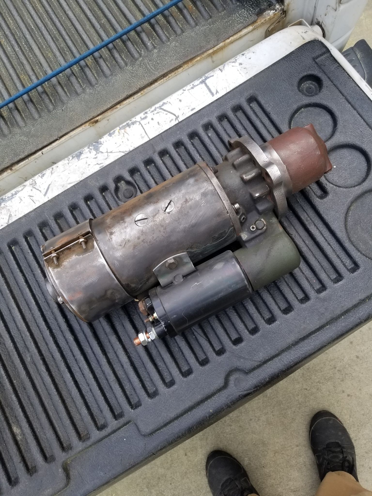

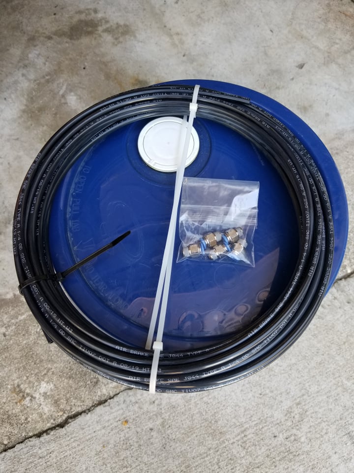

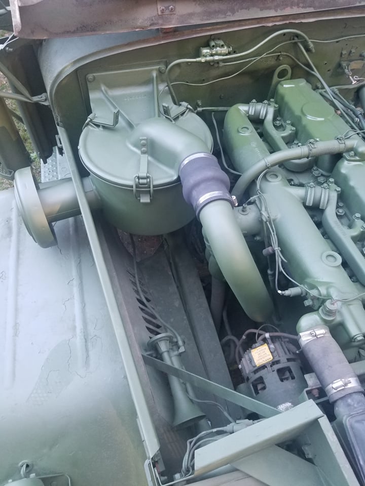

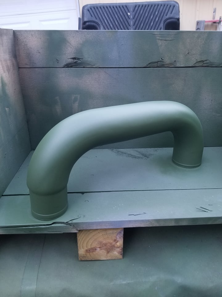

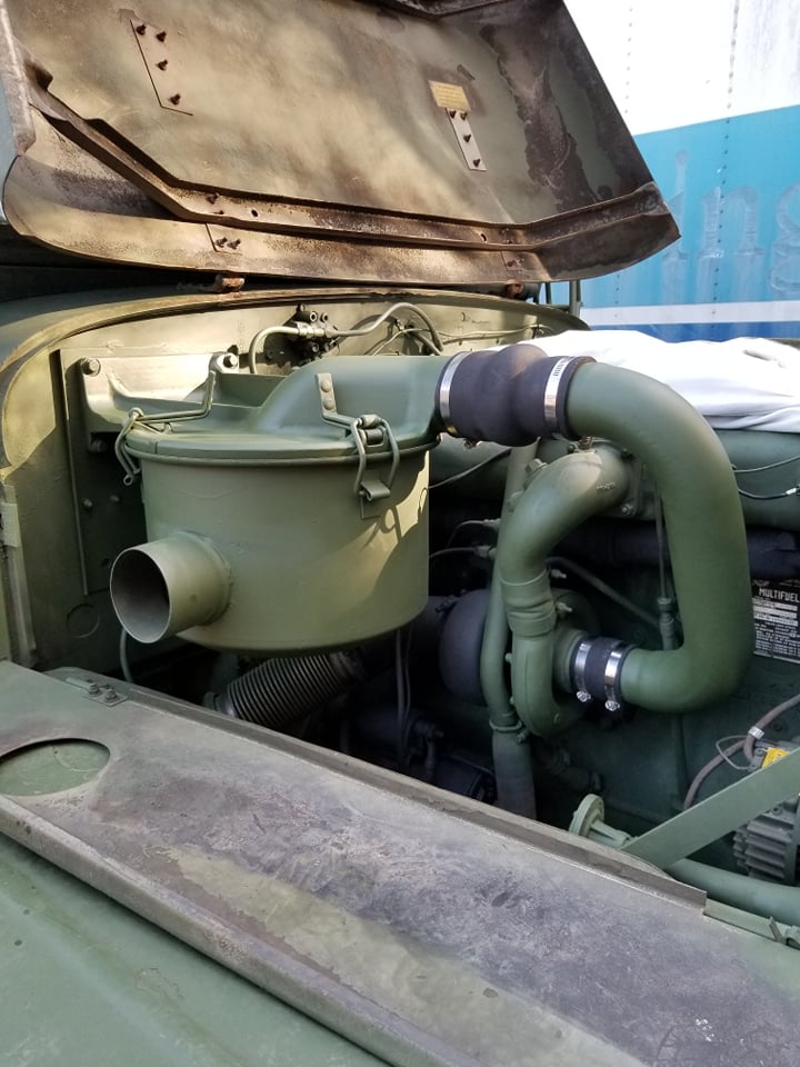

Other mechanic parts replaced was the entire exhaust system from the turbo back, speedometer/tachometer cables, gauge grounds, all filters-(oil/fuel/air), front axle boots, belts & removed the old axle vents & replaced them with ¼ fittings that allowed me to run the air lines up & away from them-(see pic). I also swapped out the old battery box for an updated/bigger plastic version so I could run two group 31 batteries along with all new cables & grounds. One last thing was to have the starter rebuilt & replaced the old solenoid. So now she starts, runs & stops!

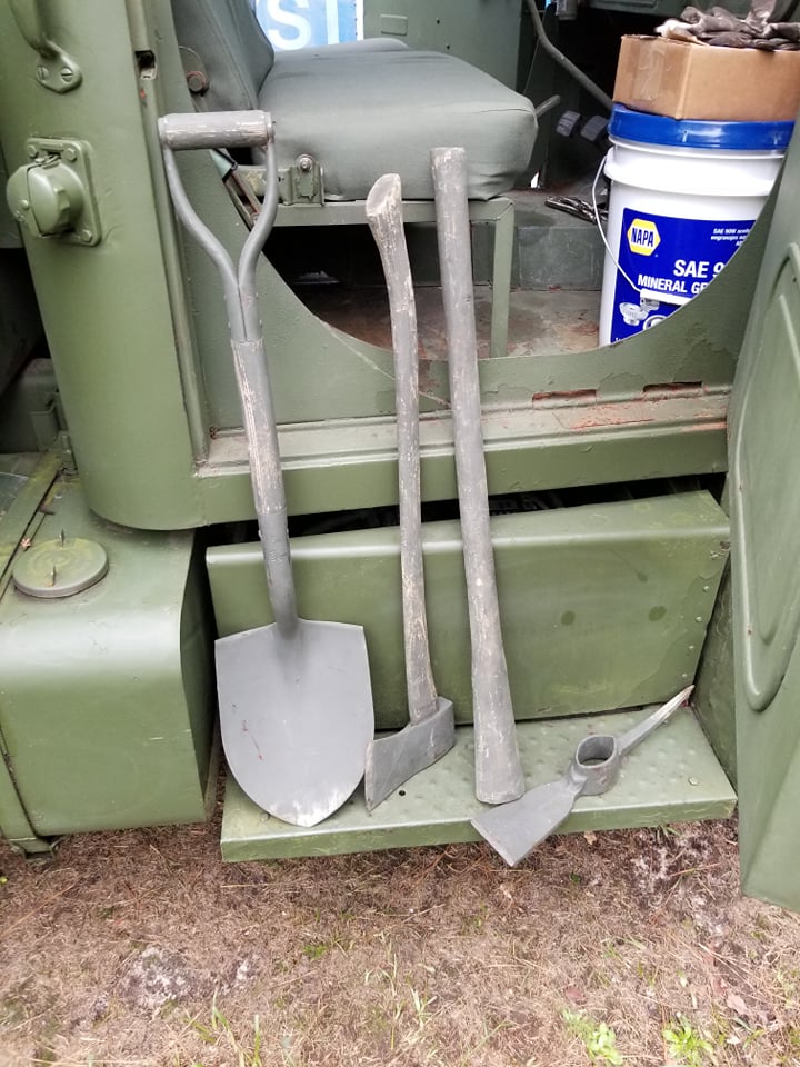

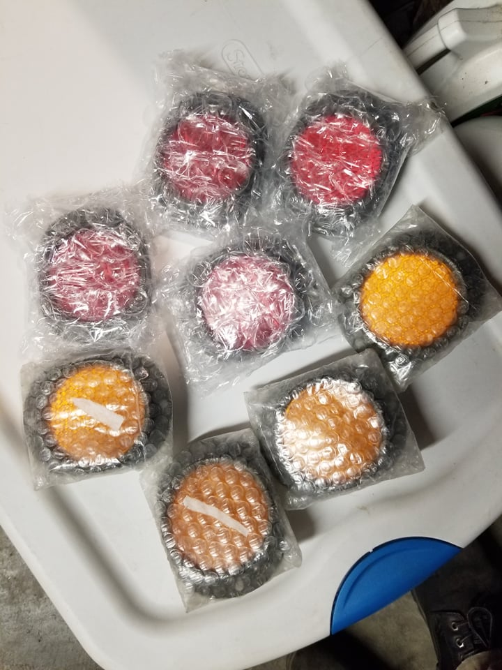

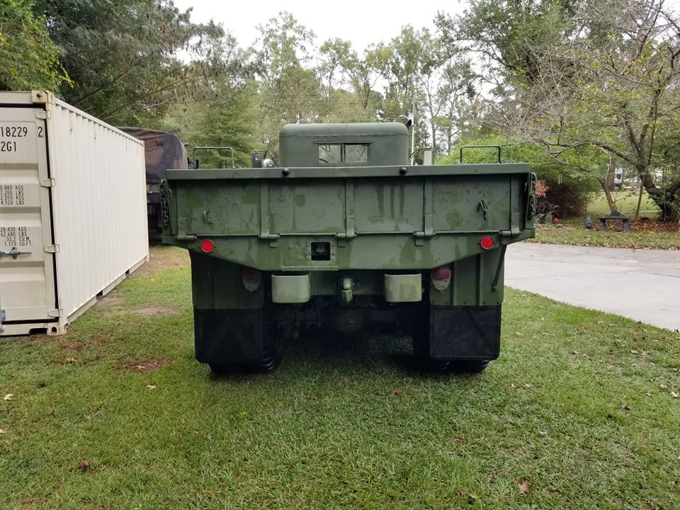

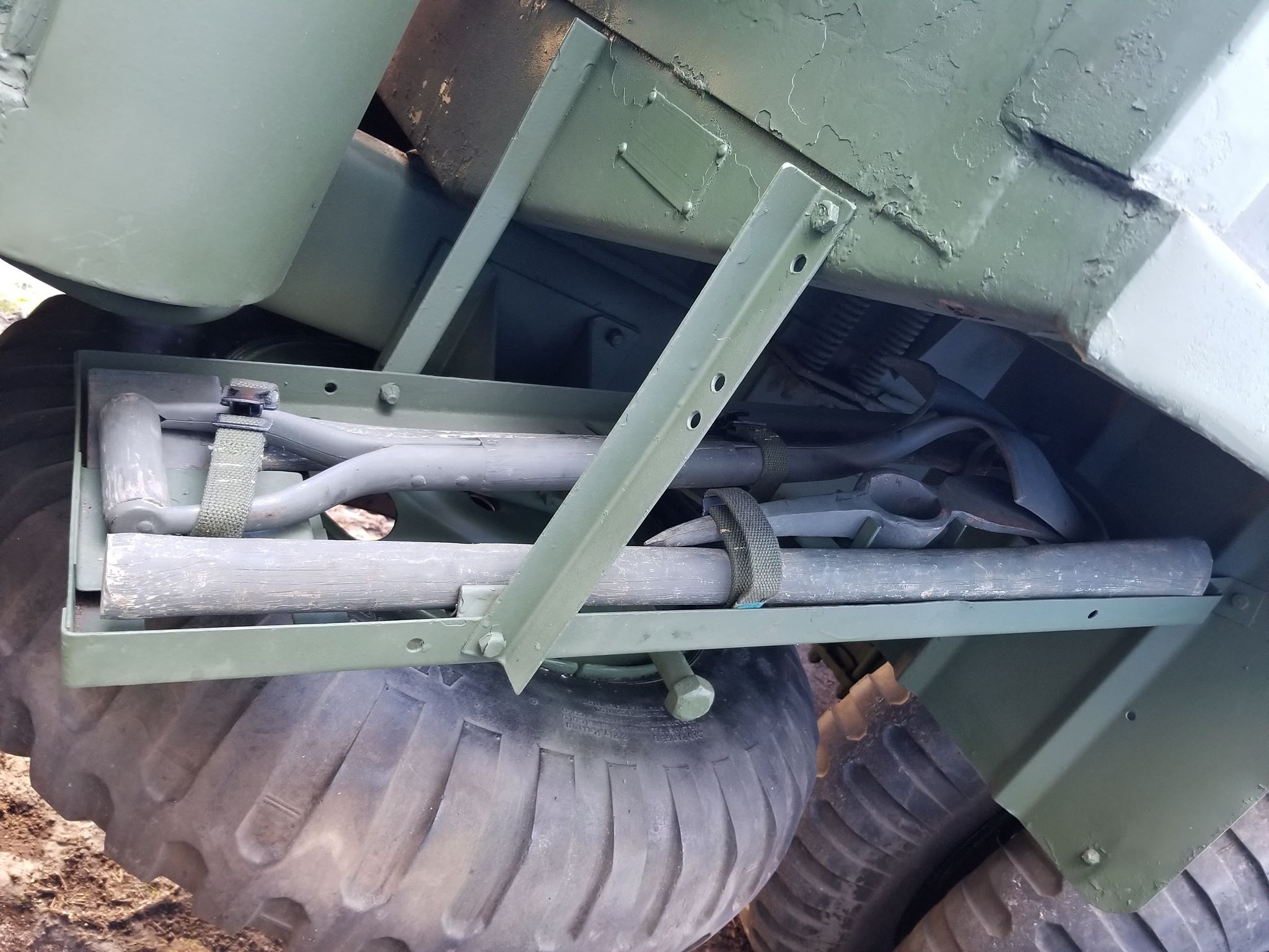

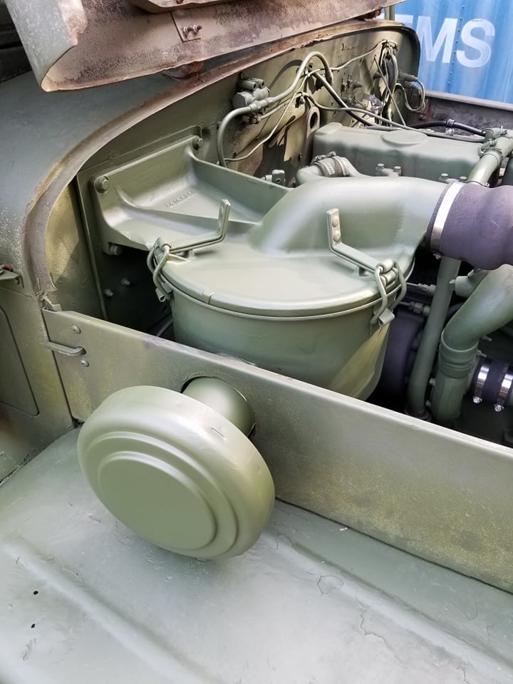

Next I swapped out off the reflectors, headlights, air breather stack, mudflap guards/mudflaps-(semi-trailer) top winch plate & added a cover to it. Tailgate needed some new step handles & rear bushings so those were replaced as well too. Scored a vintage military issue Pioneer tool kit, so installed that along with all new hold down straps.

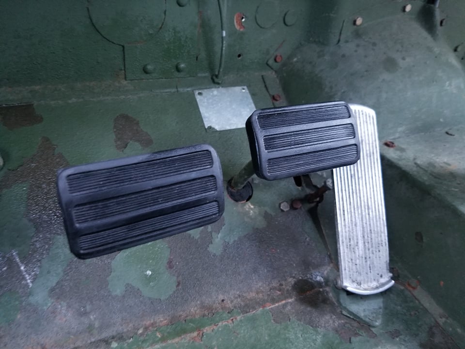

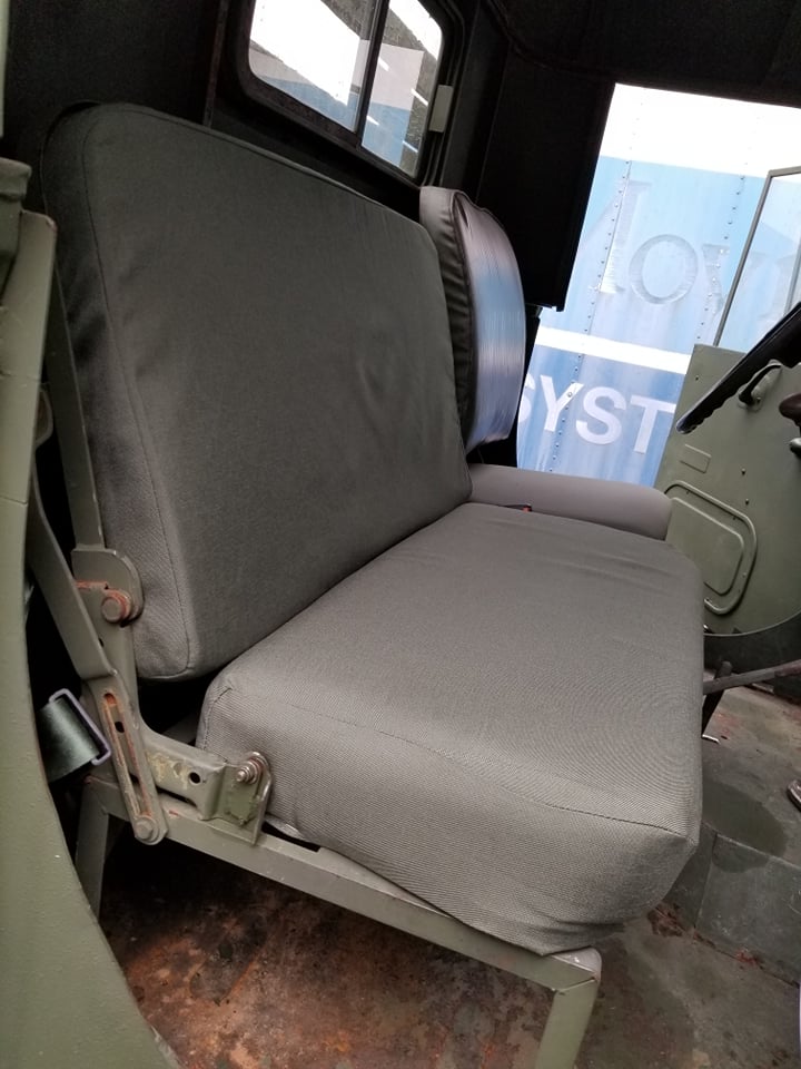

On the inside I’ve only done a few things such as new upper/lower passenger seat cushions, new pedal covers, shifter boot, new wiper motors & blades, starter push button, added a battery kill switch & new fire extinguisher.
The truck has the LDT-465-1D multi-fuel engine with the whistler c turbo & besides me completely taking it apart to clean/detail-paint everything its basically stock. The truck came with the non-air assisted transfer case, but however that has been since swapped out to the air powered model.
I'm going to post pics of what I started with & how she currently looks...

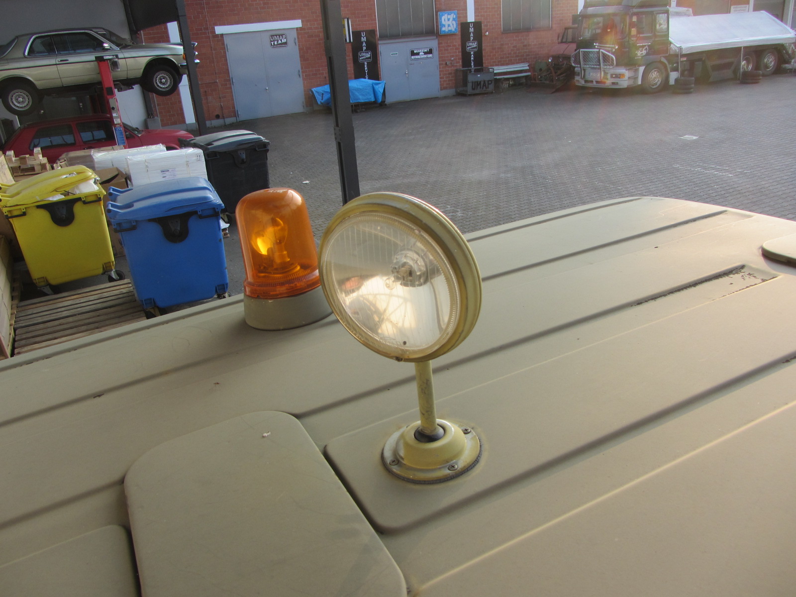

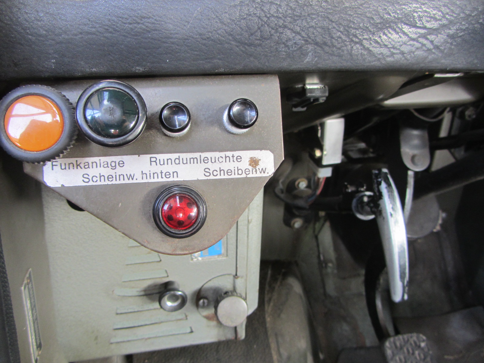

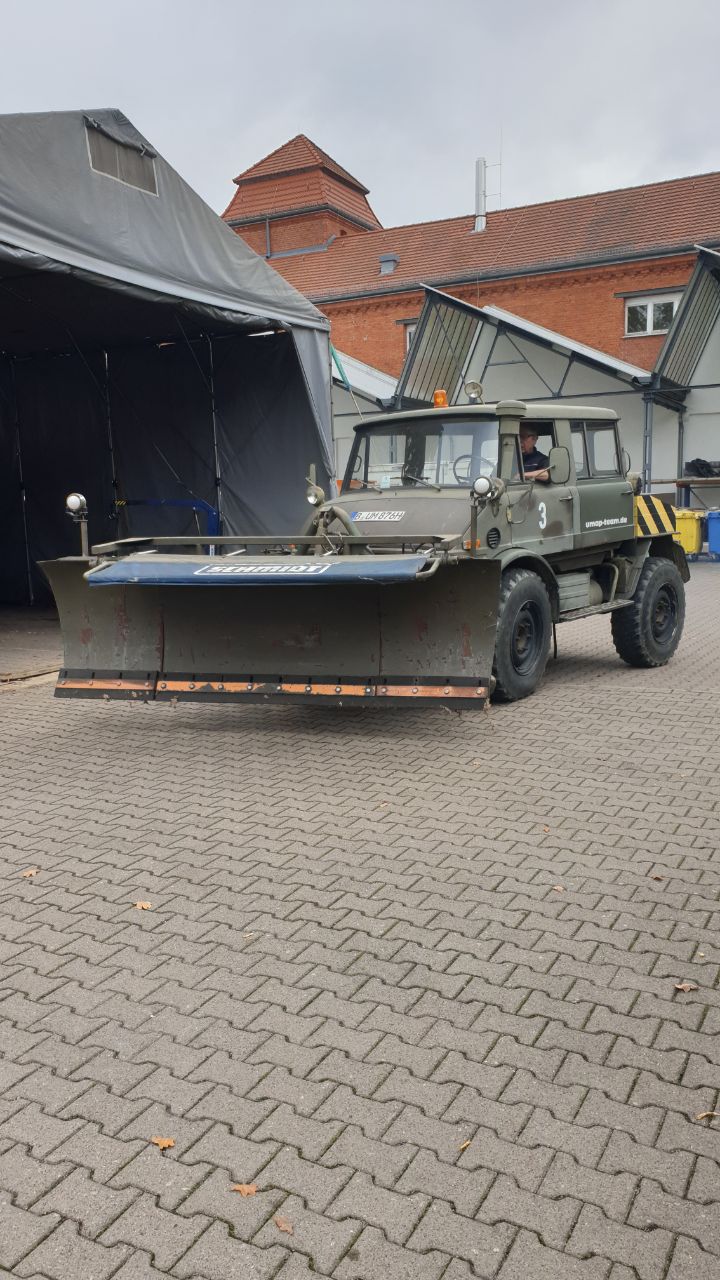

This is our 1975 Unimog 406.145 build in 1975. It´s an airfield tug which is good for towing 20 tons.
She has the common Mercedes 6 cyl. Diesel direct injected OM 352 engine and a trany with 6 speed forward an 2 speed reverse. You can switch in 4x4 and all locked, if you want.
Special feature is the torque converter clutch system which allowed a jerkfree pulling or pushing. You can stop in every gear without disengage the clutch.
We hat to replace a cracked curved rear window , shocks, belts and so on. Nothing exiting.
