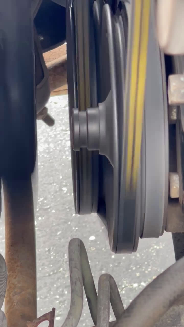

I was just checking under the hood after I got back from cruising and I noticed what appears to be a slight wobble on my crank pulley. Is a little play like that normal? The motor is running really smooth when driving but I'm concerned. How does it look to you guys? Should I replace the balancer?
I also think I need to tighten up all my belts. They're flapping around a little as you can see in the video. I read that the manual says to tighten them to 67 pounds, but I don't have any gauge for that. How tight should they be by feel?
Also, I was going by this thread here for the proper belts for the truck: https://www.steelsoldiers.com/threads/correct-belts-for-m1008-and-m1009.57290/
But are there any other belt sizes you guys prefer to use instead?

Are you sure it is the harmonic balancer and not the pulley? Easy fix is remove the belts and the pulley and just run it briefly to se what is out of alignment.
As far as the belts go I always drive to the parts store with the tools and the truck and walk in and out and get 1 belt at a time and replace them that I must use a box wrench to get the belt on the alternator pulley. Gives me lots of adjustment and the belt is almost at the complete relaxed adjustment for a long time and no SQUEALING. Do as you wish. Also check the pullies and if they have had squealing belts they could be polished and also pitted with rust. I have solid pullies installed at the alternator shop. I have less issues with belts that way. When they are SQUEALING they are wearing rapidly. If they SQUEAL the need attention. Good Luck. Report back. I seen more bent pulleys then loose harmonic balancers. Last week as a test I had my Son pry and beat on an old 6.2 engine balancer I was scrapping and it hardly di any damage. I am sure we could have broke it loose but we were just there loading scrap and I told him to pry and hit it a couple times. I think you will find the issue. If it is the harmonic balancer so be it. Easy fix and the front seal can be changed at the same time. Back to Harbor Freight for a puller. That easy. Be careful working in that area and I would recommend removal of the fan and fan shroud. Only run it a minute to get a full visual. A run out dial indicator is no needed if you say you can see it now. Good Luck again. This is a cake walk for you at this point.
I’m really not sure what part is bad. I don’t have any squealing and the motor seems to run pretty smooth to me. Could just be the pulley I suppose.
I will take off all the belts snd the pulley like you said and have a look. I might as well pull off that power steering bracket and get that fixed too. Any recommendation on the puller tool to use for that?

A large flat washer cut and welded on that bracket will fix that bracket. Do you have the lower bracket from the lower part of the power steering pump to the block just above the oil pan? Check that out and report back.
pulley power steering pump double M1010 K30 with AC, 245,00 €
Ignore RED 13. I am interested if 10, 2 ,9 ,8, and 7 are in place.

As far as the power steering bracket goes, I believe it is all in tact except for that tab on the top left. It was being held on by the nut and I still have the piece.

Get a GOOD welder to do the repair. I would add a bit of ply to that area. Do you have the rear lower bracket. And with new batteries and a new starter you have everything covered on the starter relay. I can't be that lucky to have sailed thru 25 + years with issues only when I have weak batteries and a hard starting truck. I think all is well. I have many trucks out there that I built and maintain that are running the stock system. I mean it's worked for 30+ years. I think they have it covered. I did use a plug and play cube relay but never cut the harness. Never. Nie.

Yeah I’ll try to find a good welding shop this time—definitely not that last place.
I’m not sure about the rear lower bracket, but I’m thinking everything should be there because the power steering pump is solid and doesn’t move even with that broken tab at the top. But I’ll have to check on it when I get under the hood. It’s raining right now and I have to make a trip to Napa to return that dog head relay.
