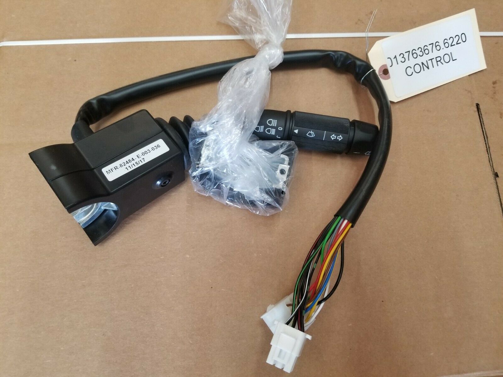

Do the 4-way hazards work?
In any case, it is usually the turn signal switch failing, as it routes all circuits having to do with signals.
If the switch is bad, there are many Asian copies out there, and they are problematic.
Search for a turn switch unit from Nartron, they are the best and have not been copied.
This is the good one, but these guys are sold out. I'd search eBay.
GeneralDisorder
2,597
6,221
Portland, OR
FMTV's don't use this switch. They use a German column switch that has integrated wiper, washer, and horn controls.
