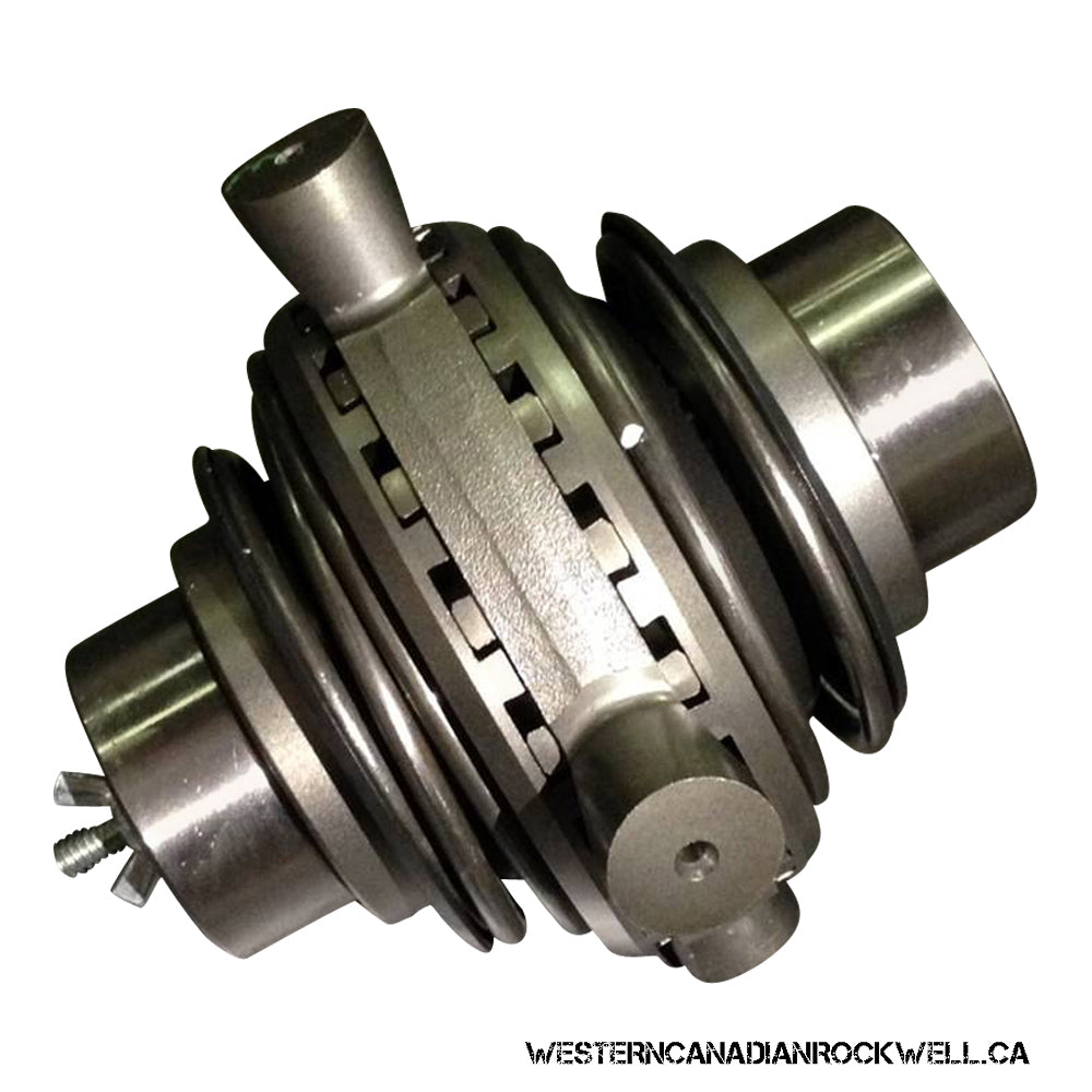

Good to know thanks. Are the lockers full time or selectable?
MatthewWBailey
1,038
1,905
Colorado
I purchased the Meritor Detroit locker product. Western Canadian Rockwell sells them. From feedback on here they apparently work without issue. I took one apart and it's clear to me that these devices "unlock" without worrying about engine torque applied. It's a pretty slick device. Only differential wheel torque makes it unlock via the cams. I calculated the differential torque required to thrust the cams apart and it's about 45lb-ft, that's the effect of the K value of the pre load springs.
MatthewWBailey
1,038
1,905
Colorado
Well if it keeps me from digging a hole and having to get out and rig a line and winch, I like it. I may add one to the rear at some point. If you don't mind saying, what did that little gem set you back?
They're still $1,118 plus shipping. I got 2
