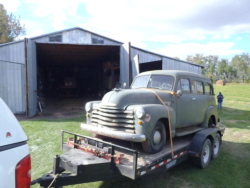

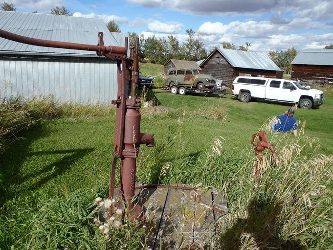

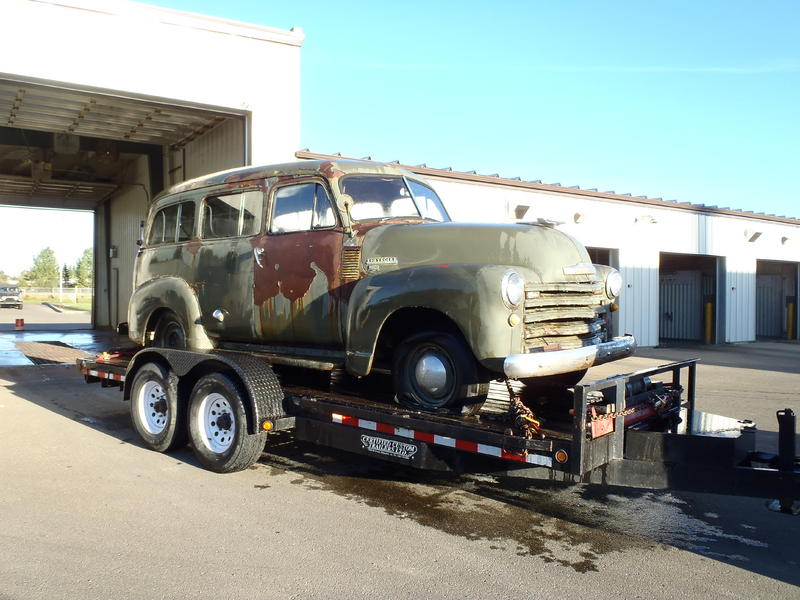

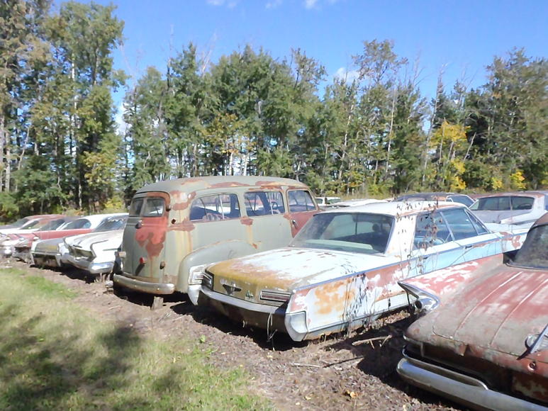

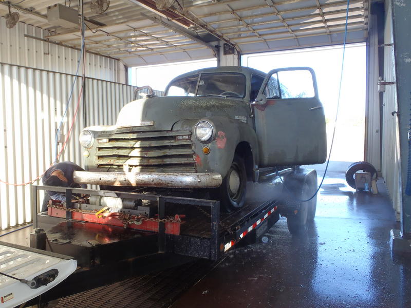

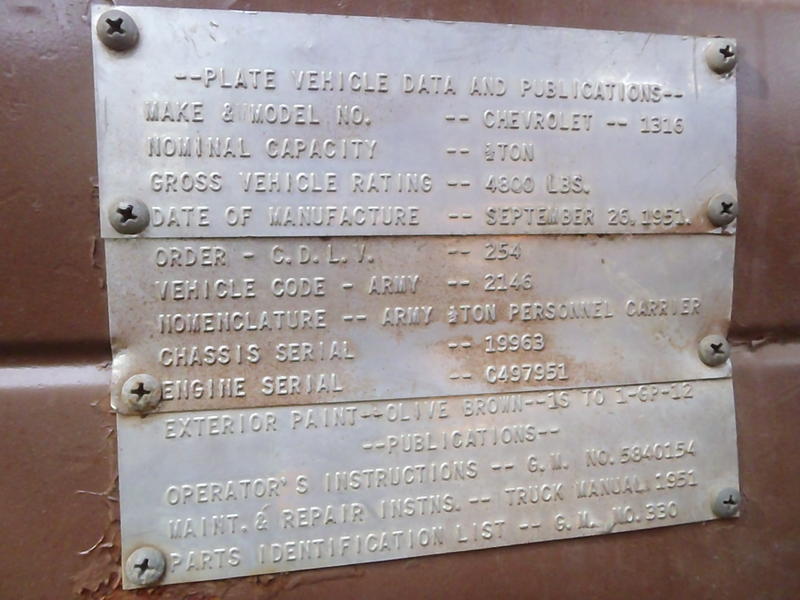

This truck has been outside for most of it's life and tonight it's in my shop for
preservation and retirement.
It belongs to the family of my brothers girlfriend and I asked if we could save it from it's home in a field.
Their history with it goes back over 4 decades when it was used as a daily
driver. It's role prior to that is still a mystery.

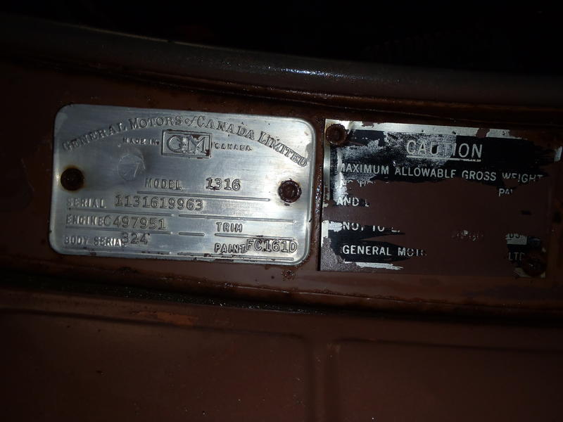

If someone can shed some light on the data plates or have some experience with the truck I'd appreciate hearing about it.
We're going to get pics of it's use by the family when it was new, to them.
Really curious about it's previous status as a 'Steel Soldier'. Found a few pics in civilian mode.

I love that Suburban.Im a fan i have owned several newer 73-91 suburbans but i love seeing an older one rescued way to go and good luck with it. :] Wow that suburban was manufactured on the 26th of sept 1951.One day after my birthday i was Born on Sep 25th 27 years after thats so awesome.Now i know why im partial to chevys :]

""""""""""Wow that suburban was manufactured on the 26th of sept 1951.One day after my birthday i was Born on Sep 25th 27 years after thats so awesome."""""""""
The numbers are interesting Southern, 'Happy Birthday', Party time comin'. I hear all great people were born in September.
Here's a good one......The chassis number on the data plate is 19963.......My birthday is tomorrow, so my chassis number is September 19 in the year 1964, yup....19964, it's meant to be.

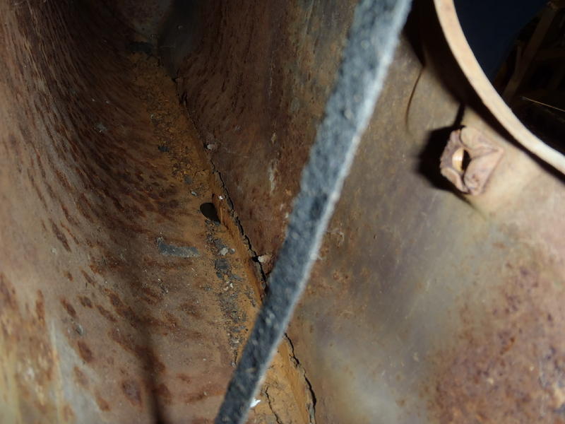

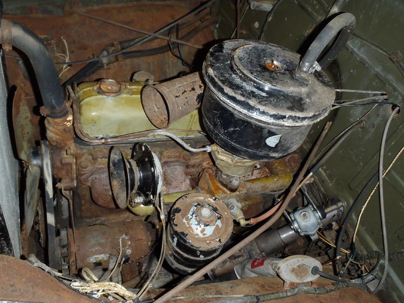

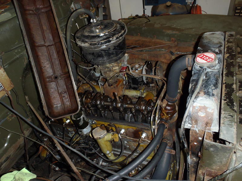

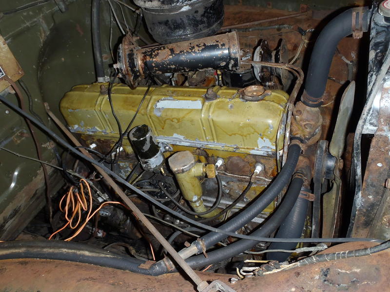

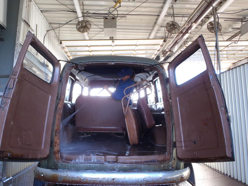

We hit the engine with simple green and washed 30 years of dirt off. Found the DEME and Rebuild Engine tags. Pulled the valve cover off and see a lot of similarity between the 51' block and the 302 in the 56' M135.

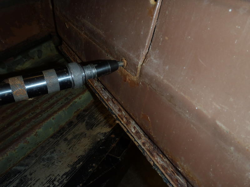

Found a great impact hammer for removing screws without screwing them up. As you hammer on the end of the handle it sets the driver so there's a smaller chance of damaging the slots. It starts to slowly rotate as you smack on it and Dad's lesson of screwing it back in, then backing it off....in a little, out a little and so on until the first rusty screws came out of the door panel in good shape.
Should be done soon.

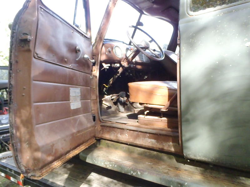

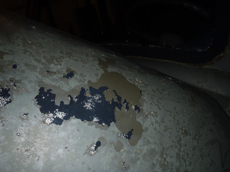

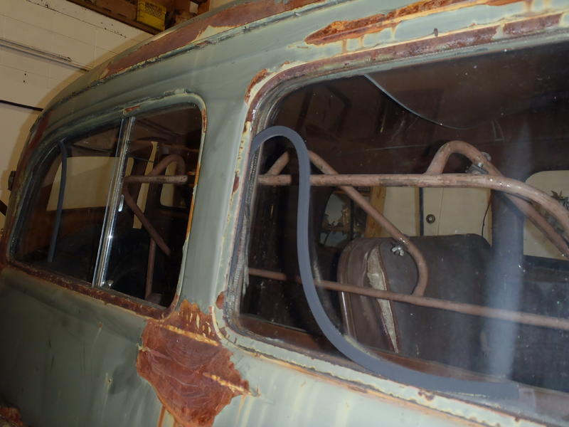

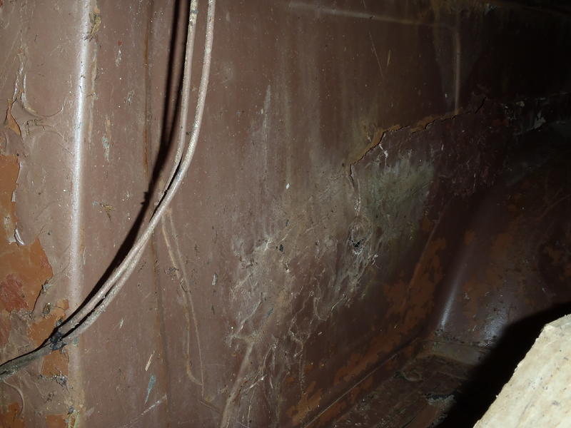

1951 Suburban
Digital cameras are great for hidden places.

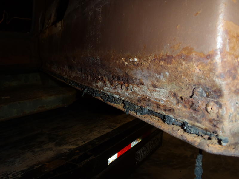

A picture inside the passenger door shows a little age but it's not in bad shape.
3 or 4 layers of paint are poking through with black, brown, semi gloss OD and whatever OD is on top. The green under the hood is in such great shape, it looks original.
After beating on a 6x6 for 2 years, this looks easy.

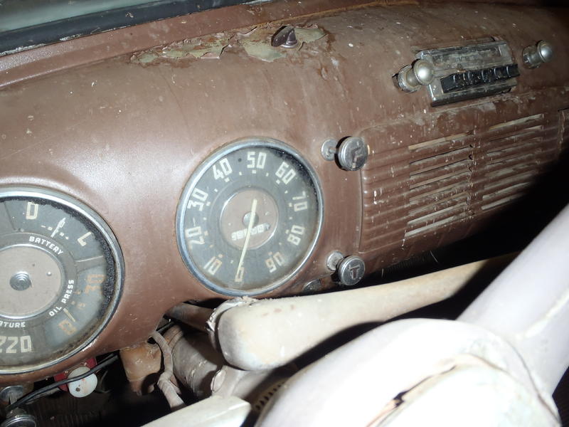

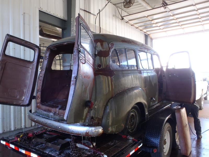

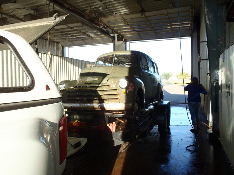

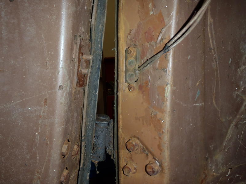

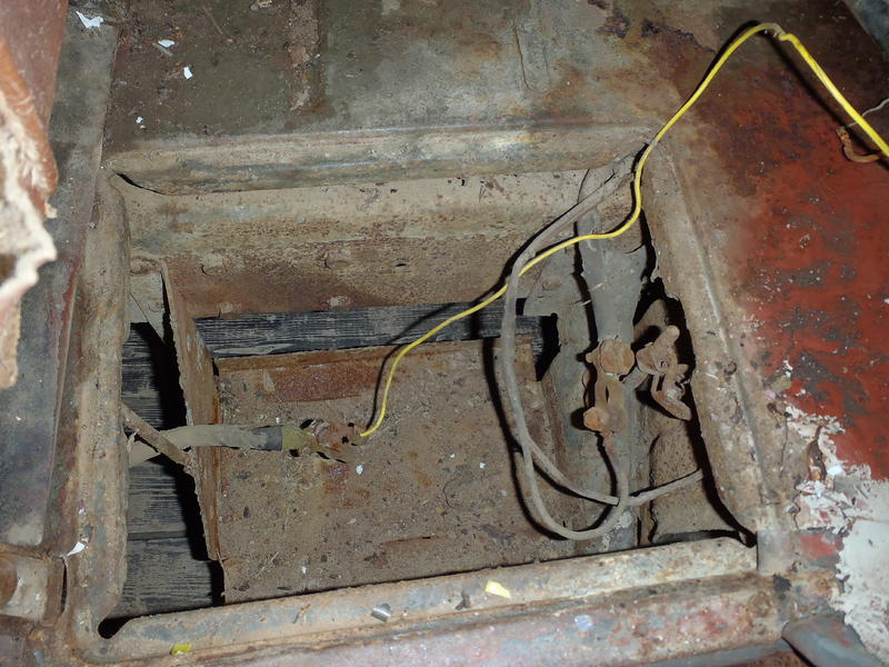

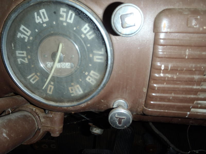

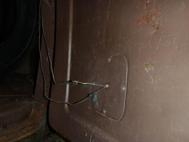

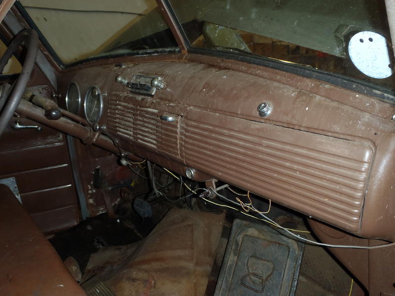

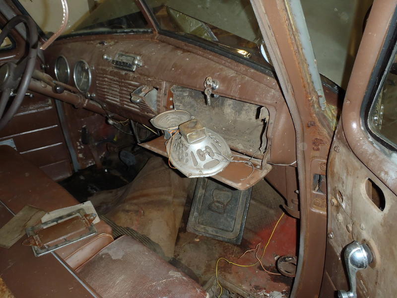

The truck was driven to it's parking spot sometime in the last 3 decades and would probably start with a jump. Prior to firing or even trying to turn it over everything will be removed, purged, cleaned, blown out, lubed, juiced, replaced, measured and weighed. The least we'll do is new fuel system, oil and air prior to turning the key.
We even started with 'extreme graphite' in the door handles, locks, hinges and anything that moved, before we moved it.
The speedo reads 05794 so it's a guess if she went over 10000.

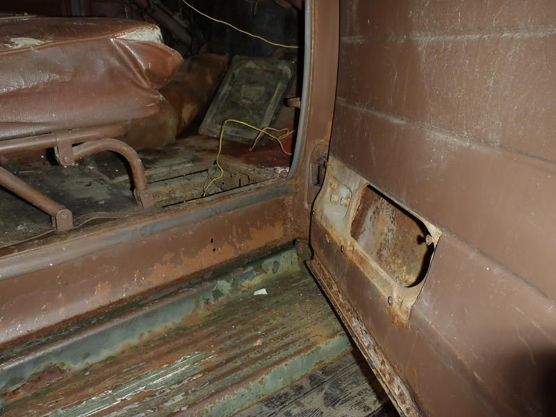

Pulled a little loose bondo off the inside drivers panel to expose the air conditioning.
The single Left rear light is powered only when the door is closed with the 'open to the public' contact points above the bottom hinge. The right one might need some wiring alterations but originally the KIS principle was used by running the wires through the back door and leaving slack for opening. Keep It Simple.
