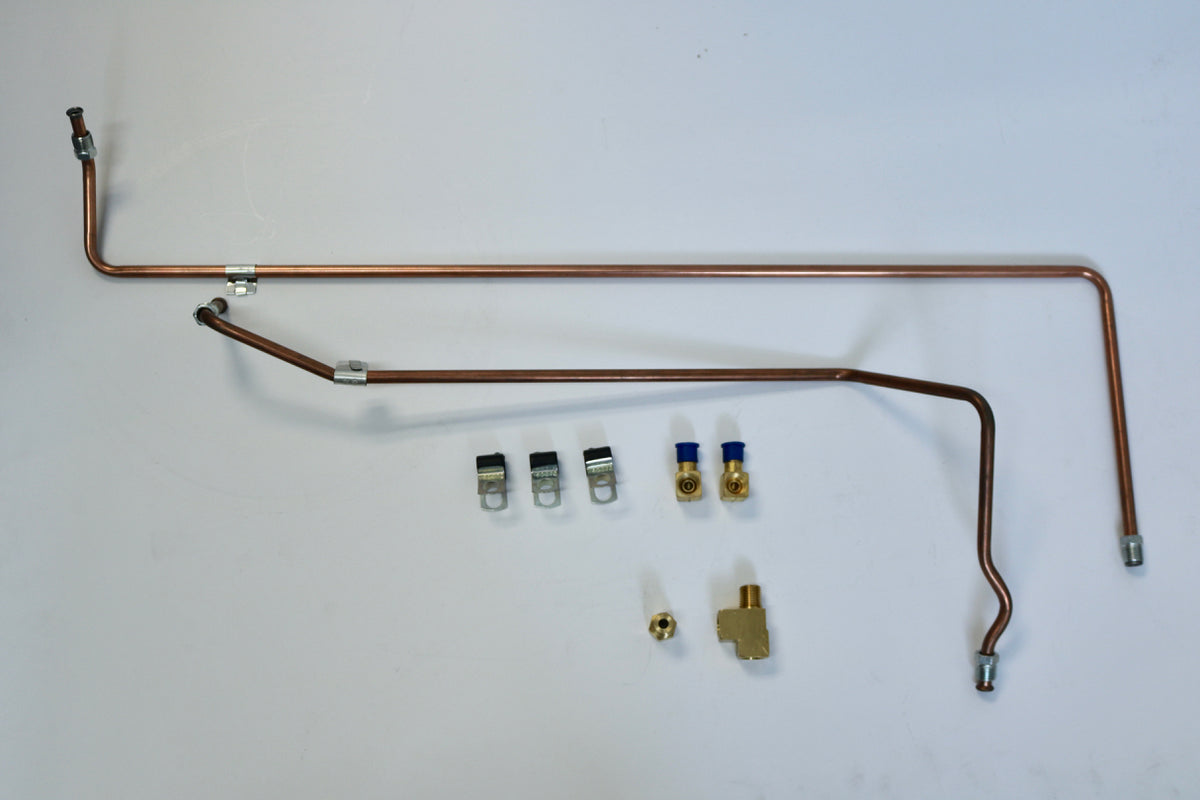

Where does it go:
Once the new line is in you need a fuel source for it. In my case I picked up some JIC flareless compression fittings and put a T into the steel line that runs to the front head. Sad to say the hydraulic supplier I went to here local was kind enough to point out the fittings are good for 5000psi but failed to mention that you only tighten them 1.5 turns after finger tight or you will crack the ferrule which is what I did and had a leak. Now I have decided to remove my emergency shut off valve and replace it with anther ball valve and run a new line to the front as well and have all new JIC type fittings and 4600psi hydraulic hose, yes it's diesel fuel rated, for my fuel lines. As a side note, according to Cummins tech support, the 250 has a rail pressure of 25psi at idle and at may load has a rail pressure of 160 to 170psi, so a 4600psi hose may just be a bit of overkill. In any case the best place to get a fuel supply for the new line is off the same port that the front head uses. If anyone has a source for the fittings that go into the fuel shutoff that come on the trucks I'm interested as I would like to make dual line kits.
What does it do:
Now with the line installed the truck idles smoother, the throttle response is much better, Pittsburgh Power and many others claim a 25hp gain, and some even claim better fuel economy. I can't speak much to the power increase as I said before I found a small leak from over tightening the compression fitting so I wasn't about to push it too far. Some on here have done this and at this point can speak much more to the benefits of this mod than I can at this time. I'm also told if you ever want to add a turbo or up the power this is a good foundation for it.
Difficulty level:
Personally I thought this was real easy. It was hard to get the doghouse off and it was harder to get the front fuel line off than to add the back line. Pittsburgh power sells a kit made of a steel line. I choose to use flexible hydraulic hose because I can work with it easier, no trouble lining up rigid steel line with an inverted flare fitting and I hope to produce kits someday for all of you who want to do this mod. Overall I'd say if the claims of 25hp gain are true then this is the easiest 25hp you can get.
