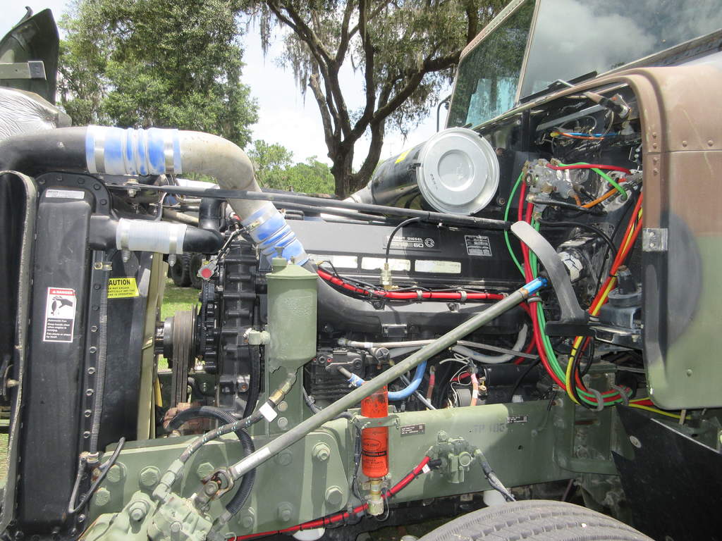

James, that open hood shot is nothing short of amazing; you seriously scored on buying this truck. Awesome find & deal./

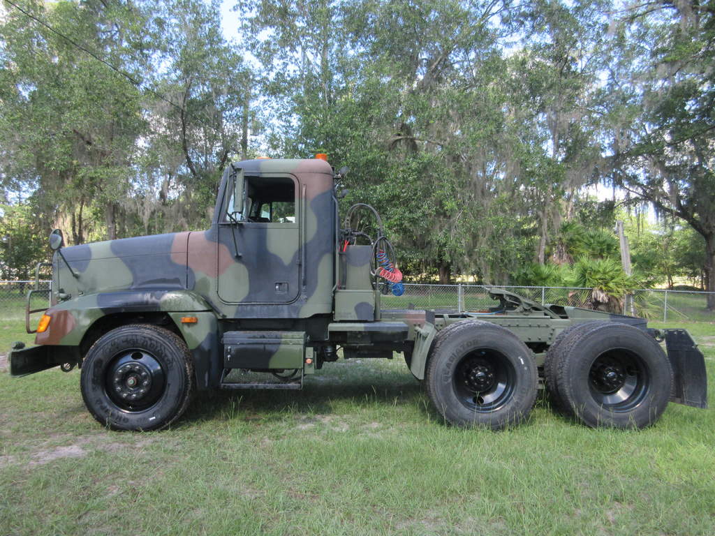

Really nice truck, looks new under a little dust. Glad you made it home.

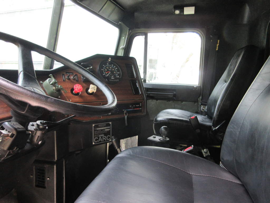

I love the three lever light switch sticking out of the dash.

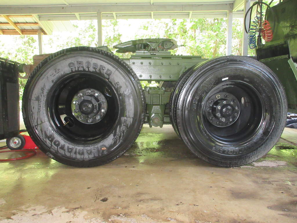

I had a full set of the 11R24.5 wheels and tires. I will stick with these new shoes. I just got the tires home and only changed out the rear rear so far but you can tell the difference between the 24.5 and 22.5.
