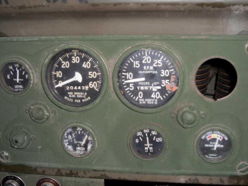

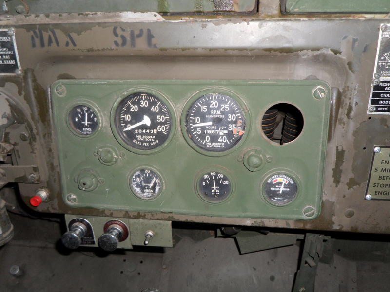

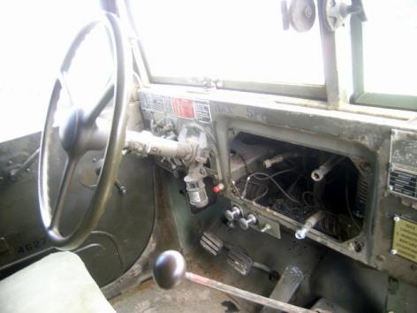

I need to send out a big thanks to fuzzytoaster. He was able to salvage some parts off his scrap M35A2 before it was rolled toward the crusher. He shipped me the needed part real quick like. Kudos fuzzy! At least part of your truck lives on......
side notes:
-his truck must have needed the 0-60psi oil pres gauge. my truck has the gauge pegged to 60psi. Both my other trucks have the 0-120psi gauge.
-both my other trucks build 100+psi air. This one indicates +/-60 lbs. buzzer seems to go off at same pressure as my other trucks(+/- 50 psi) need to check gauge on known psi source.
-need to find a temp gauge!
Thanks again fuzzy. You are a good troop!

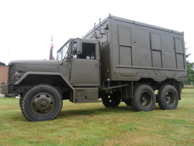

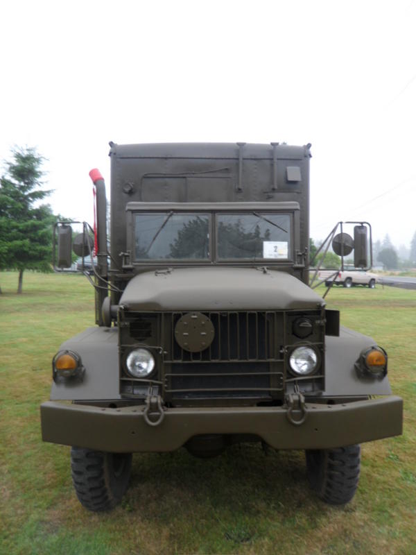

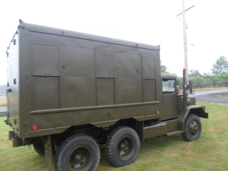

The 109 gets a much needed makeover. Had it blasted down to bare steel. Minor amount of body work. Primed with DP-40. Hosed down with 24087. 4 gallons cut with a gallon of Xylene. We ended up with about a quart of material left in the pressure pot.
Markings are next on the list!

Outstanding Aaron! Looks great. It's going to look really sharp with the contrasting white stencils and stars. Hmmm, do I see another paint project in my future;-)
wsucougarx
6,949
64
Washington State
You know as cheap as the 105's are selling at Fort Lewis, I'd buy one that has old MERDC on it. It won't be such a task to break all that stubborn CARC off otherwise.
