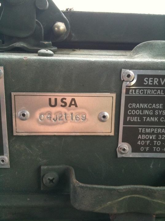

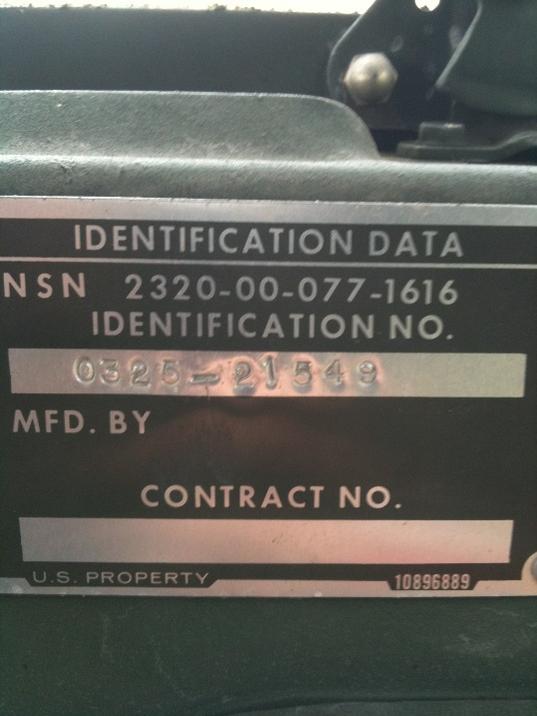

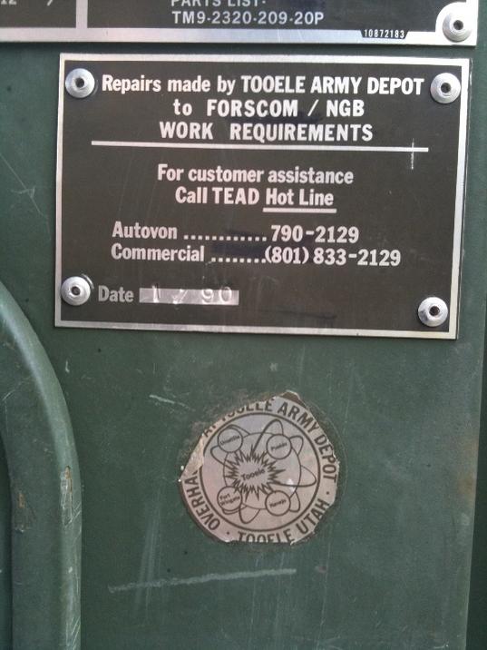

I had to post pics because I am unsure of the Serial verses Registration #'s. Mine has a data plate that I haven't seen in others pics - just a silver plate with USA and a stamped # on it, don't know if this is the Serial #? Also included pics of TEAD plate if it helps with your ID any ( I don't know if it would or not). If getting a number off the frame or somewhere else would help I can do that next time I go to the base to work on it / look at it as I haven't picked it up yet.
Thanks in advance.
a. serial #
b registration # 032521549 or 04J21169
c. NSN # 2320000771616
d. bought at Boone National Guard Center, Frankfort, KY
e. Bumper #'s: passenger side HHC 206 EN BN, driver side HQ 34

Organization:
206TH EN BN HHC EN BN REAR
Location:RICHMOND
KENTUCKY
Nomenclature:
TRUCK CARGO 2-1/2T Model:
M35A2 NSN:
2320000771616 Serial Number:
32521549 Registration Number:
4J21169 Year of Mfg:
1969 Manufacturer:
65909 Usage Miles: 17316
Jun 09
