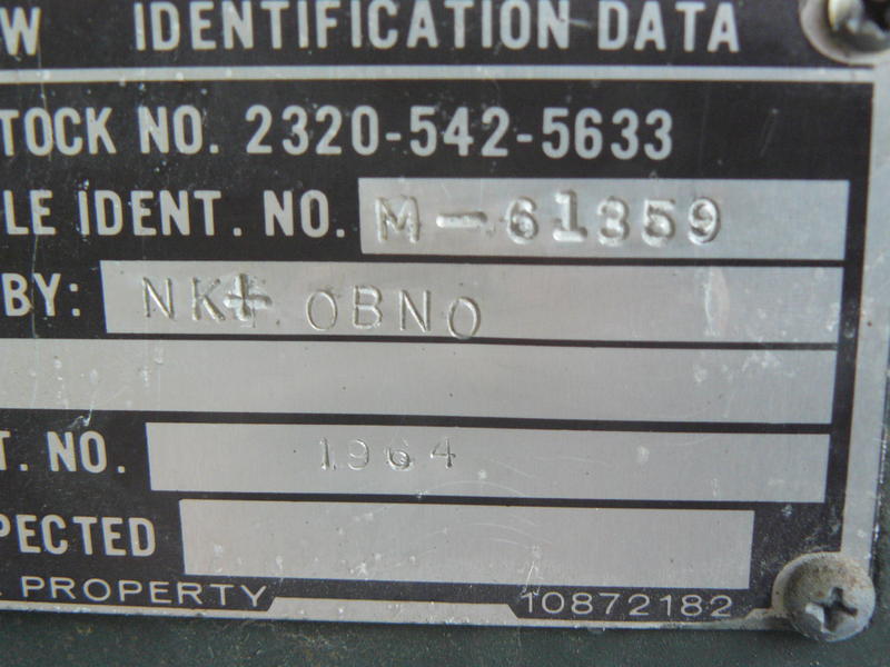

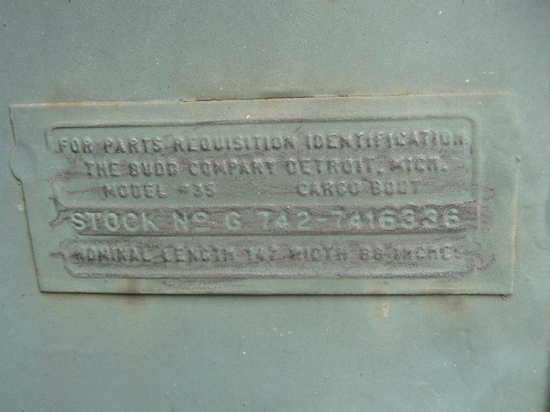

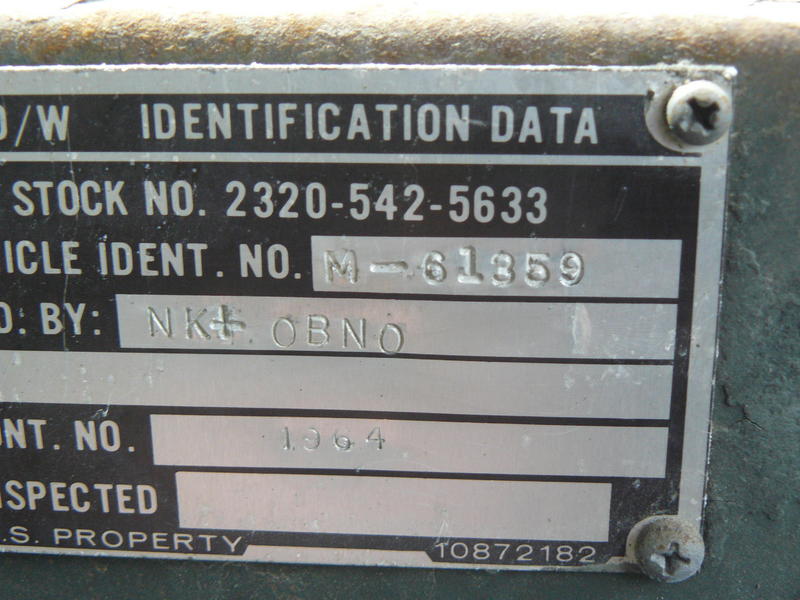

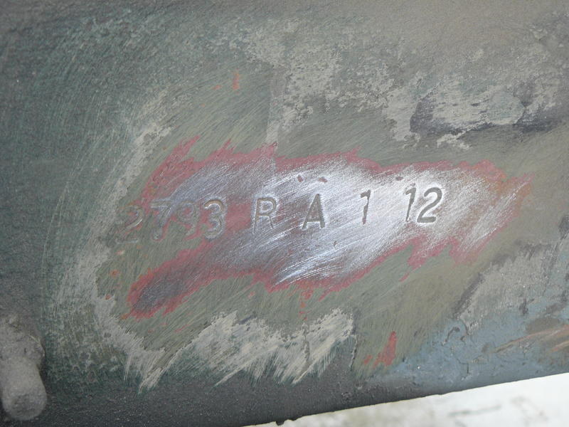

Here is the pic of serial and data plate and plate on bed...frame reads 2793 RA 112
OK,
Here is what you have
Unit Ident Code:
WHPMT0 Nomenclature:
TRUCK CARGO 2-1/2T Model:
M35A1 NSN:
2320005425633 Serial Number:
M61359 Registration Number:
NK0BN0 Year of Mfg:
1963 Manufacturer:
05827
Info Sep 05
The unit that your truck belonged to closed their doors and no long exsists. That's all I can do.
