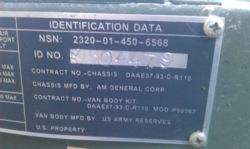

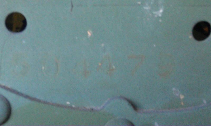

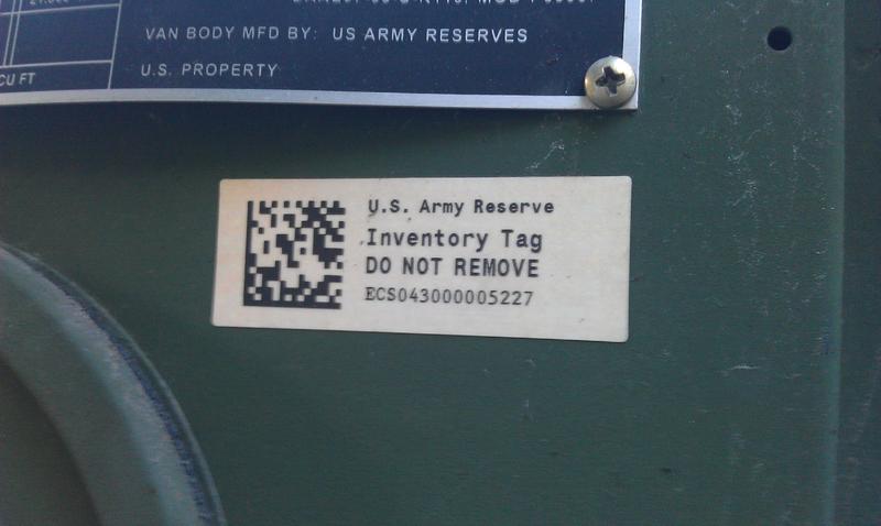

Model AM General M109a4, Shop Van without winch
A: Lot number says Serial Number is 504479
B: NSN 2320014506568 from link provided by govliquidation
I Just bought it from govliquidation.com at Fort Meade, MD
NIIN/NSN report from IHS, The Source for Critical Information and Insight (tm)
I can't read bumper numbers.
It would be a huge help to know the year and VIN to get this beast insured for the load-out next week.
THANK YOU from a Deuce newbie!
No information on this specific serial number. Your VIN is your serial number though. This speciific serial number is not in my database but I do have others around it.
You should also ensure the serial number is correct before registering it. Read post #1 to see where to find the serial number on the frame.

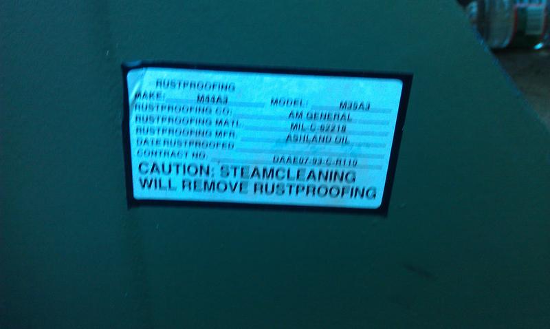

I picked it up from GL today, just wondering if any of the OTHER data is helpful in tracking this unit down
Doesn't help cause the sn is lot listed.
Picture 6 is an inventory tag from Equipment Concentration Site 43 which was located at Ft Gillem GA until the base closed last month. I might have a contact number there that maybe I' ll be able to get the info but it'll be awhile and it's not fo sure. Not sure if they keep records for stuff they DRMO'd and also they moved so they might have dumped the records.
