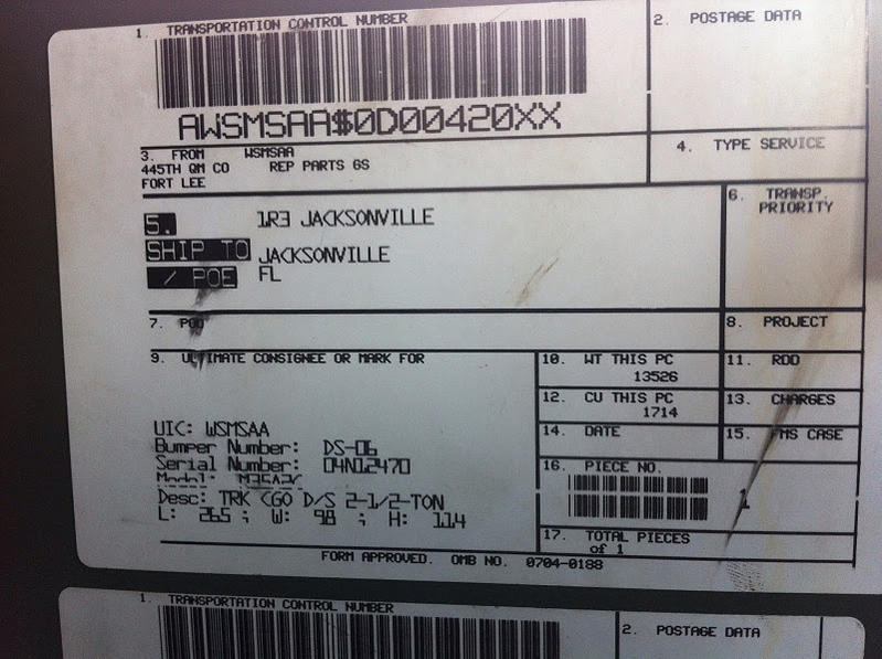

jrodjared
97
Baltimore, MD
No info on this truck. The registration number came back from a totally different vehicle. Need to verify the serial number on the frame to make sure this info is correct. The registration number comes back for serial number 52517103
The serial number came right off the frame rail. Had to grind a bit of paint off to get to it but it was there. hmmm.
Does this sticker help? It was left by DRMO on the door. Thanks :beer:

CARNAC
The Envelope Please.
8,297
715
College Station, TX
OK according to the shipping label you have the truck belonged to the 445th Quartermaster Company. The bumper number was DS-06 and it was a M35A2C drop side deuce with a regirstration number of 0412470 (although the label says that is the serial number, that's is a registration number if I ever saw one).
That registration number comes up as
Organization:ECS 27 FT DIX NJ Location:FT DIX
NJ
Nomenclature:
TRUCK CARGO 2-1/2T Model:
M35A2 NSN:
2320000771616 Serial Number:
52517103 Registration Number:
4N12470 Year of Mfg:
1970 Manufacturer:
65909
However by doing a reverse search I came up with the following from the 445th.
Organization:445TH QUARTERMASTER COMPANY Location:MG STRYKER RC
NJ
Nomenclature:
M35A2 NSN:
52517107 Registration Number:
4N12870 Year of Mfg:
1970
That's all I can find.
