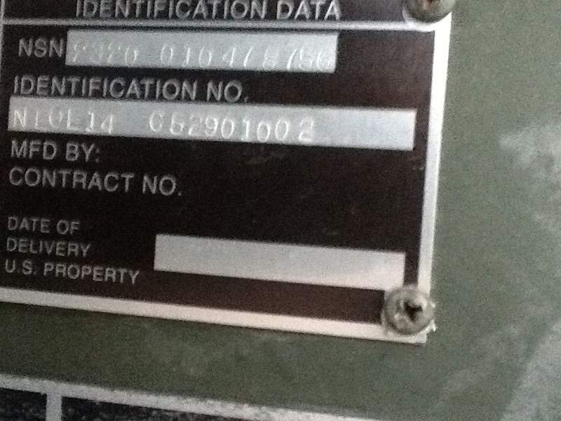

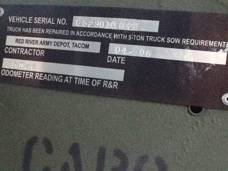

M929 Dump Truck
M929 Dump Truck (no winch) - Refurbished in 04 2006 at Red River Army Depot, TACOM
a. Serial Number (VIN number) NL0L14C62901002
b. Identification Number G52901002
c. NSN without dashes 2320010478756
d. Where you bought it Private Party who bought it at auction in LA
e. Bumper numbers none readable
Need to know year of manufacture if you can.
Thanks

Paradies
Knoxville, TN
Thanks
Here are pictures of the tags on the dash...
