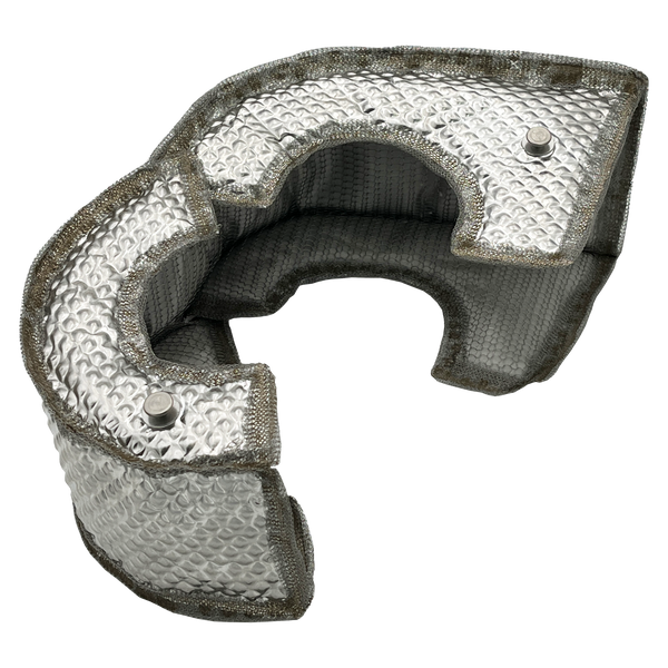

Does anyone know what standard T# size the 3126 turbo is? I'm trying to find a turbo blanket and they are sold in T3,T4,T5..etc size designations. I saw some online references to T3 for the 3126 but internet references are unreliable.

I ordered a T6 based on what an Amazon seller said would fit and it was too big, so it is likely a T4. I have a C7, but I believe the turbo is the same size as the 3126. I just found this but haven't put a tape on mine yet:

Our turbo (3126/C7) is a Borg Warner S300 (made for CAT) and my spare M-ATV turbo (370 HP C7) is a T3 flange but based on that chart it's a 7 cm thick turbine housing so I guess a T4 blanket?

ThermoTec has 2 products, one is T3/T4 sized and the other is T5/T6 sized.
ThermalZero has a different blanket for T3 vs a T4 with price reflecting the difference

I put in the cheaper PTP blanket, non split version. The post that mounts the gate valve is a little in the way but it still fits.
I put a second blanket over the whole assembly too
