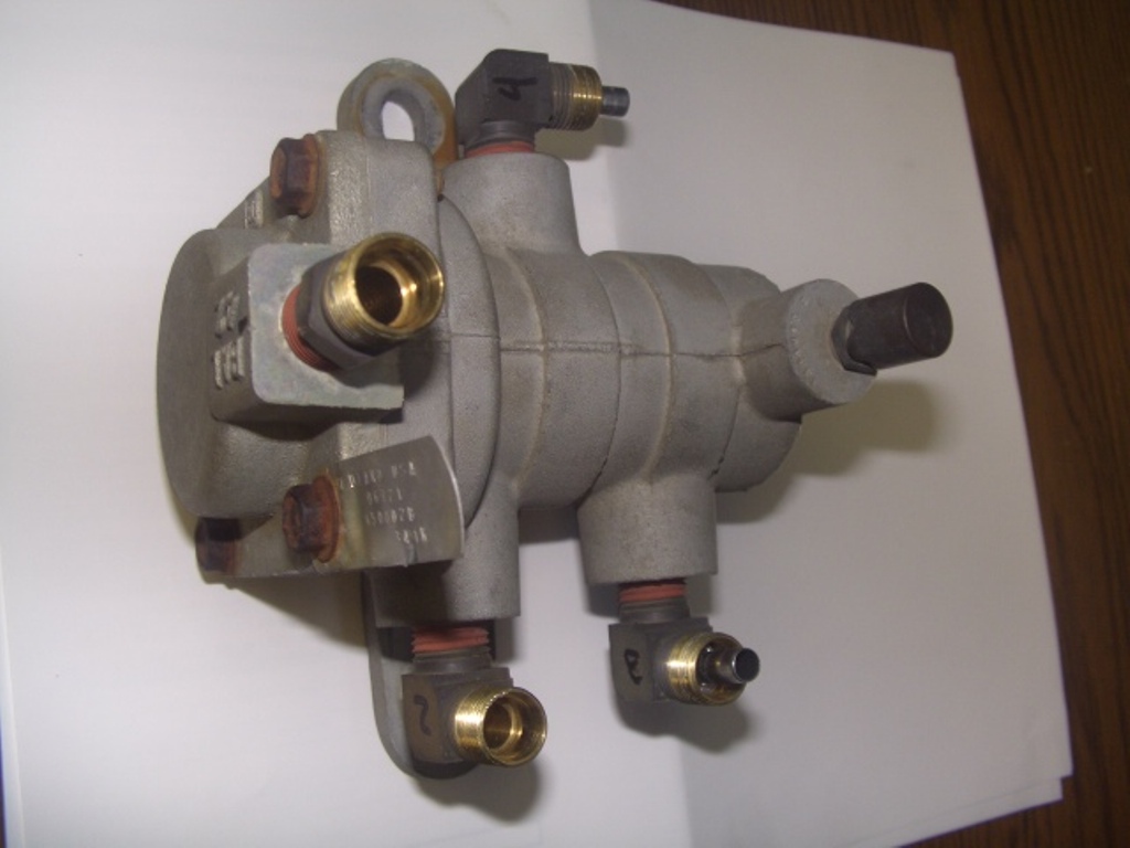

Well I had this problem with the air brakes during my recovery when I hit stop and go traffic. I took it for a drive yesterday and had no problems but then today when I took it for a spin, I got a 1/4 mile from the house and when I stopped at a stop sign, they didn't want to release. I gave it a little power and they released. I got to the next stop sign and they locked up good. I powered through to a vacant field across the street and tapped on them with a hammer and went from forward to reverse a few times and they eventually released. I got her back home and when I felt the rear drums, 1 was cold, 2 were warm and 1 was too hot to keep my hand on at all......I had traveled about 1 mile total.
I can't find anything in the TM's about this....anyone have any advise?

Well Dave I was really hoping it was the Inversion valve....thanks for getting it shipped out so quickly....unfortunately that didn't fix the problem.....Looks like I'm going in....
James
