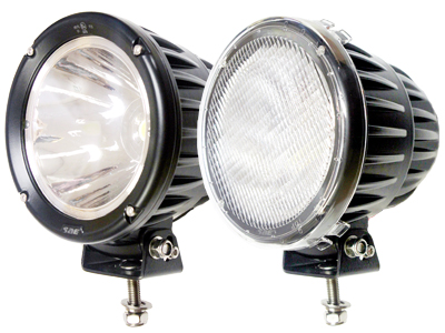

Edit: sure, it is faulty hi/lo switch on steering column. Jumper wire did job, now is time to new switch. When waiting switch arrival, i bought pair of 50W led lights - they are hi beam but with inserts installed they are fog lights. Hopefully get them tomorrow :beer:
