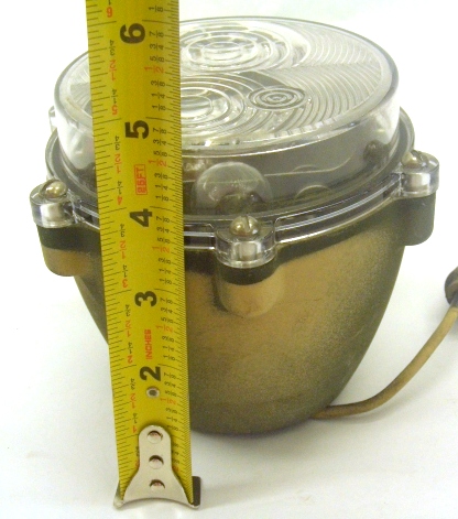

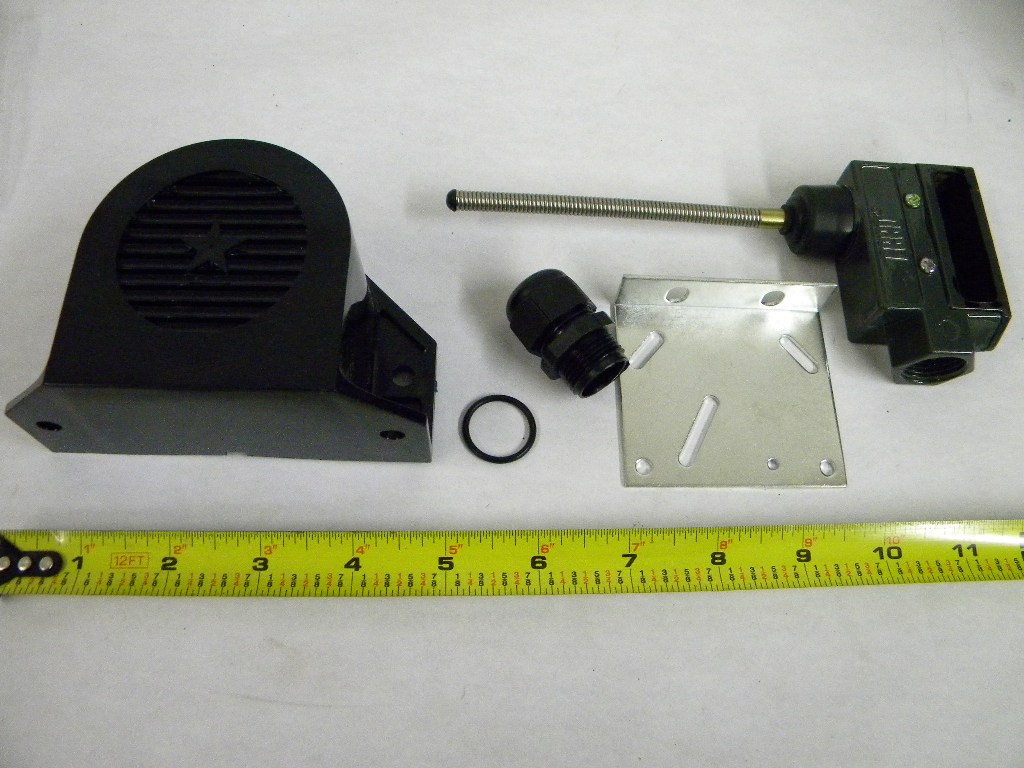

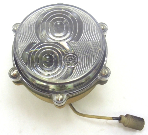

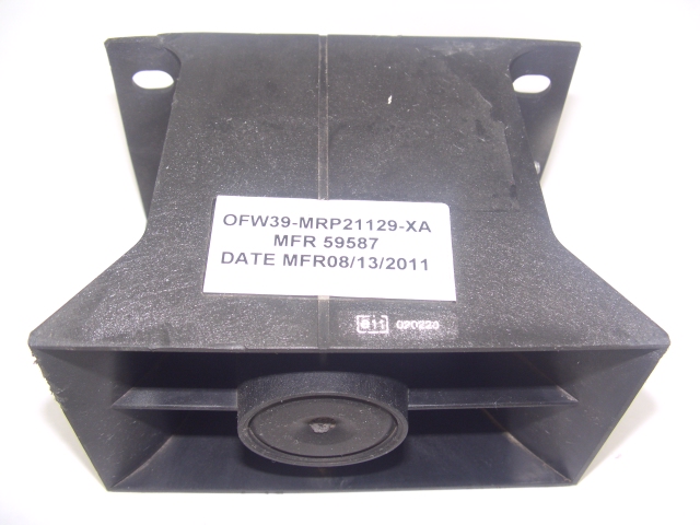

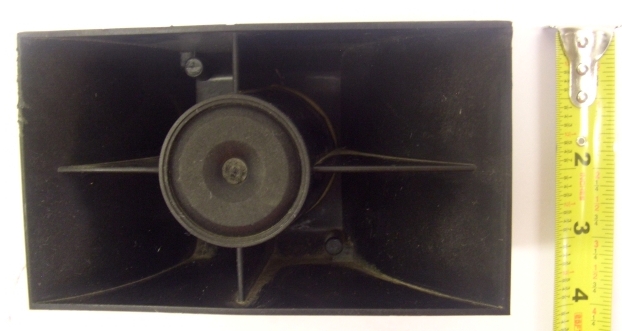

We have 24 backup alarms and lights and also stock a full back up alarm kit
dave
www.easternsurplus.net
(COM-3203) Back up light for common application. 12 to 24 volt. NOS Take-offs from unissued MRAPs. NSN 6220-01-375-3530. PN 12378501. $21 each
(COM-3202) Back-up alarm for Common application. 12 to 24 volt. NOS Take offs from unissued MRAPs. NSN 6350-01-319-9161. PN MRP21129. $19 each
(ALL-5114) Back up alarm kit- will fit any truck- set-up for 24 volt- $185
