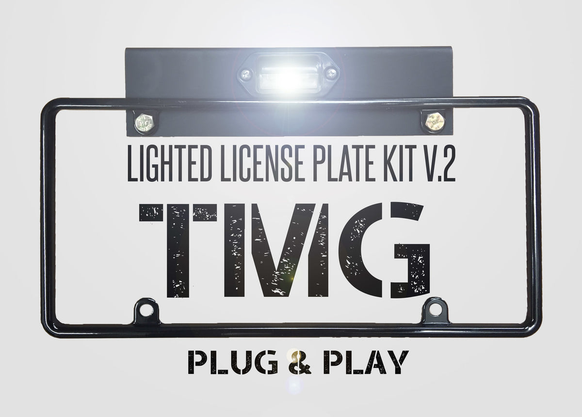

Found a cheap plate holder with a license plate light. The one I have, has no light.
