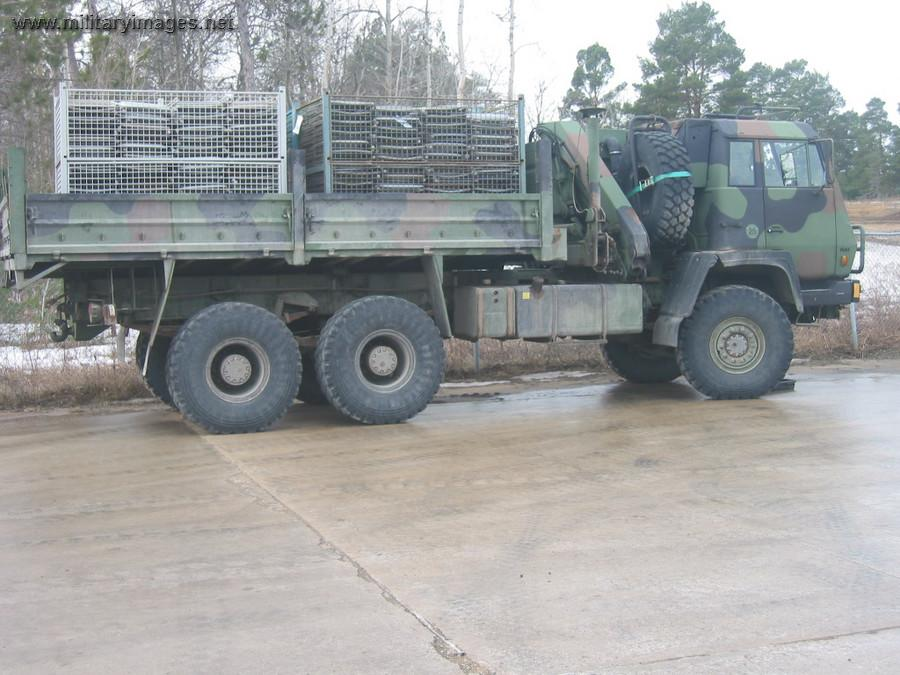

The Palfinger PK5800 came on the cargo variant of the STEYR-based Heavy Logistics Vehicle, Wheeled (HLVW) of the Canadian Forces and these were assembled in Canada. Wajax (company famous for wildland fire pumps) also assembled the Palfinger cranes. I am not sure whether the PK5800 was used on any US military vehicles (probably was).
