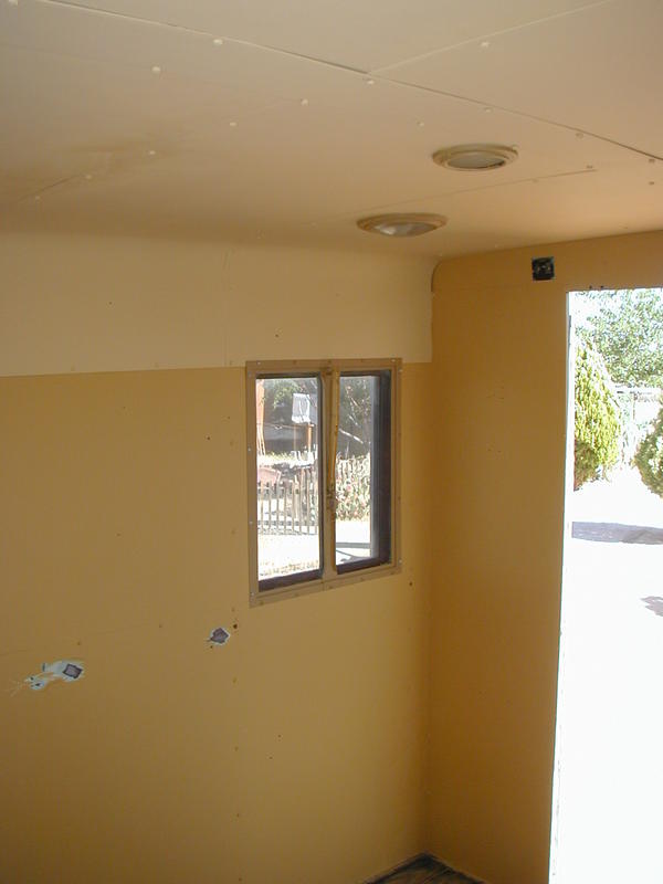

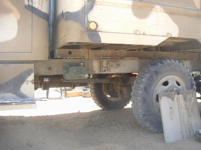

I've been promising to some of you that I would do a build thread when we (finely) got started . . . that time has come.

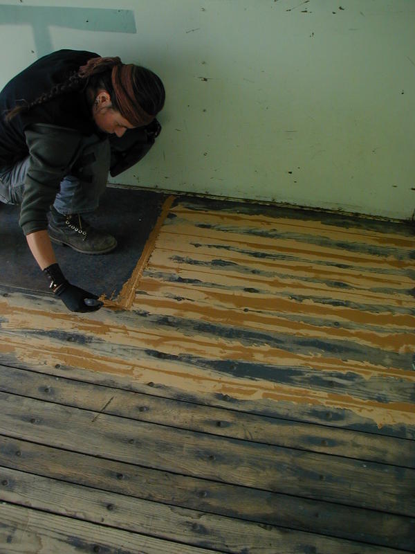

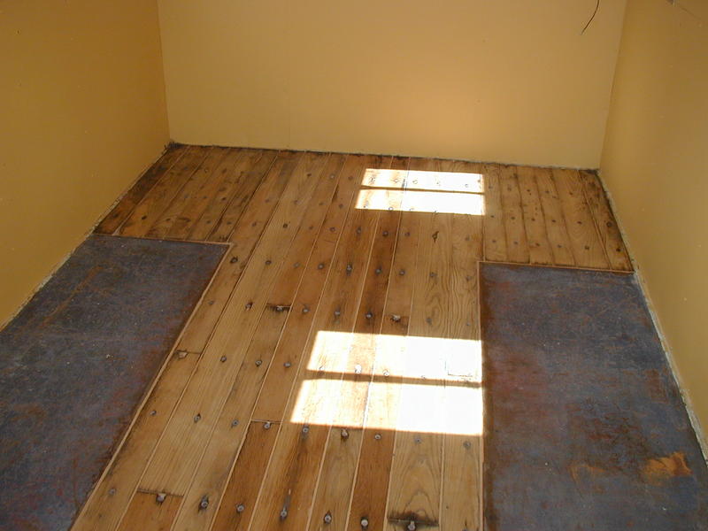

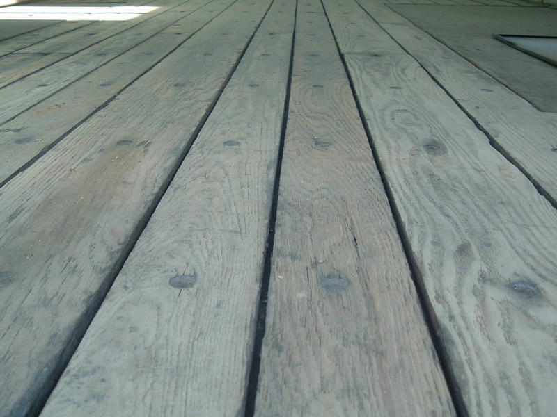

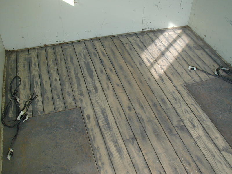

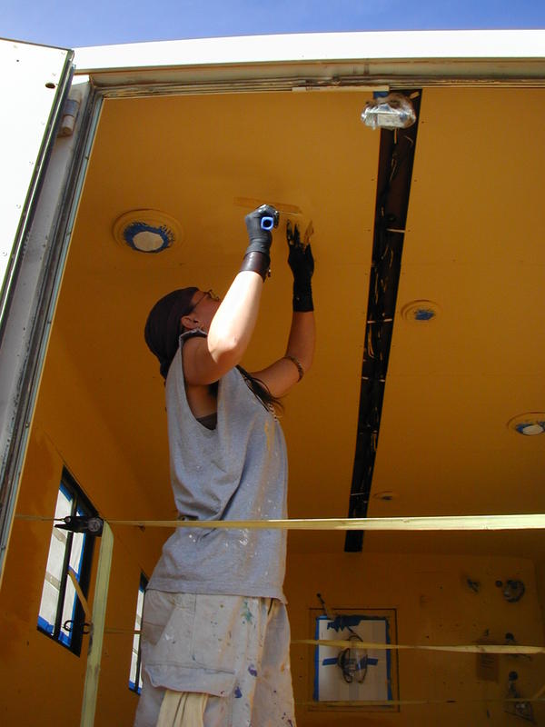

We spent the last year getting to know the rig, sealing leaks, singling out the rears & changing the tranny, re-deucing the sound levels, sanding, filling the floors and painting.
Now it's time to start the build.

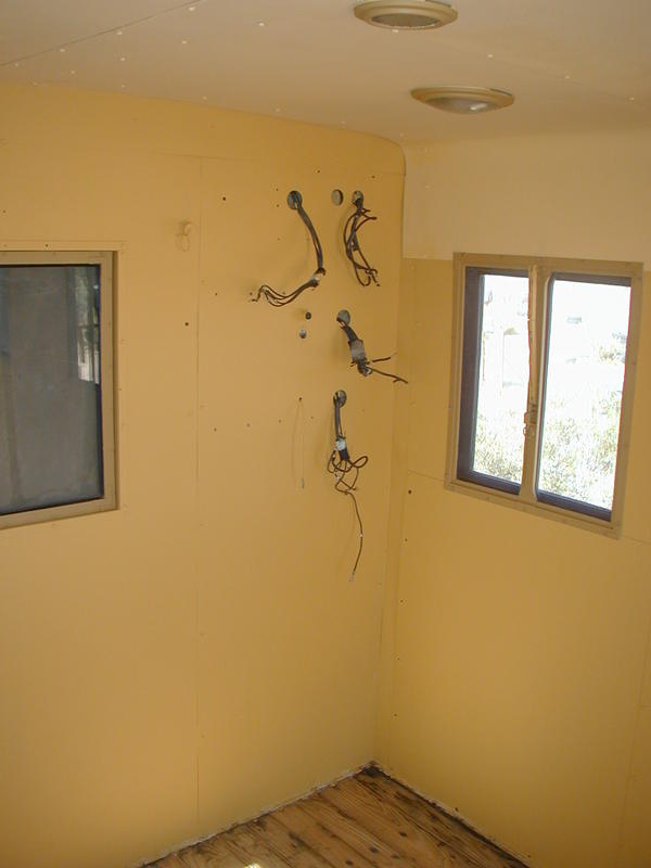

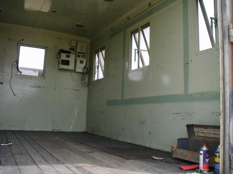

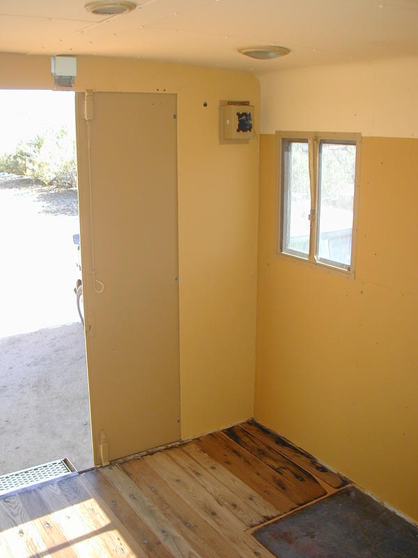

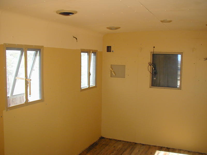

I'll start w/ some photos of the inside as we got it,
then the work that we did to get it to this starting point. I say "starting point" because up until now I've only gotten to do the wrenching and tear-outs. All the floor work and painting was Elise's, . . . it is her rig.
Now I get to do some "Spacial Transformations".
The link at the bottom will take you to the detailed photo site. Lots of photos, small on words, perfect for those that don't want to read and would prefer to "just look at pictures". ;)

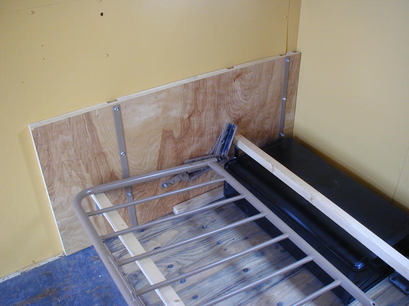

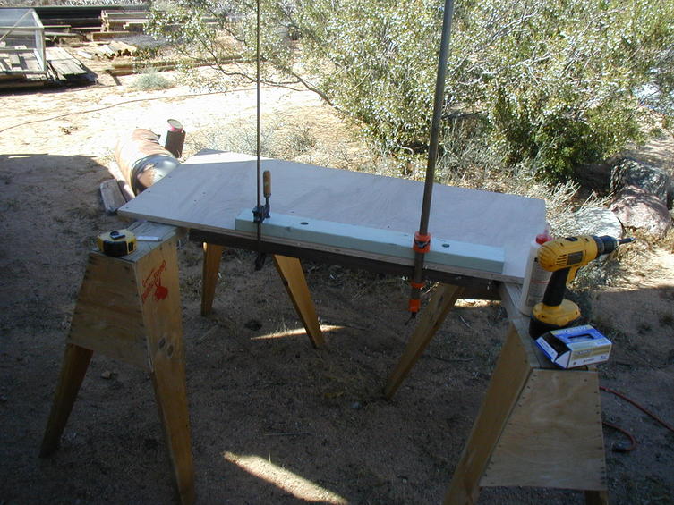

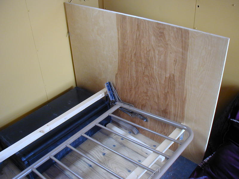

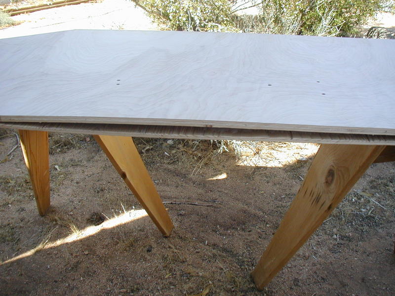

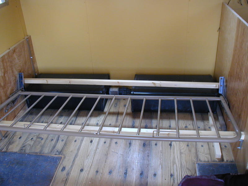

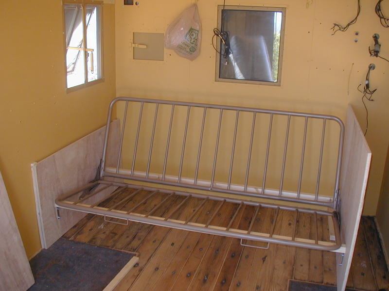

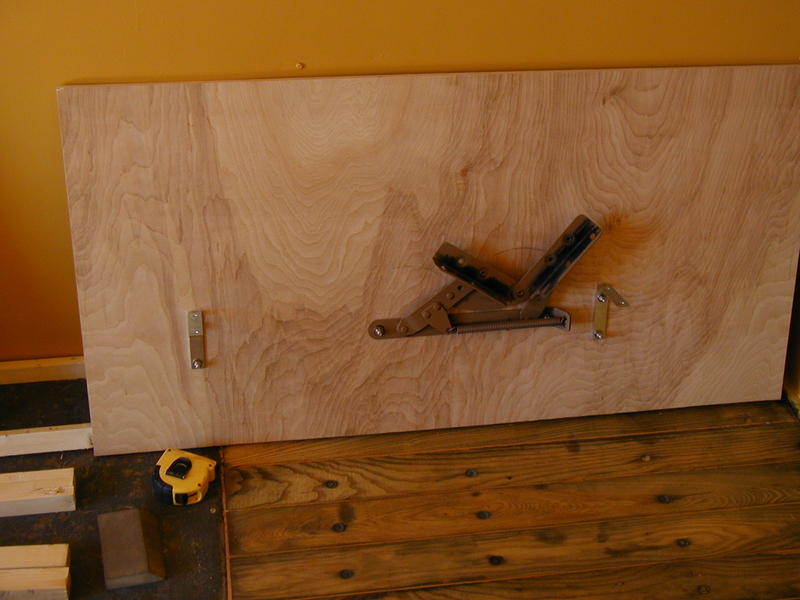

Pulled the hinges of a $5 futon frame we got at the local swap meet and mated them to some 3/4 birch ply. After making sure that my tape didn't lie to me, and I really could lay it down w/o running into the wall, I pulled it all apart for some sanding & oiling. Now I live in a tree less desert, and this ply is from the Depot, so it needed some help. When I cut it into two pieces I found a huge air bubble in the middle. Used up a bottle of wood glue and a day w/ it in clamps.

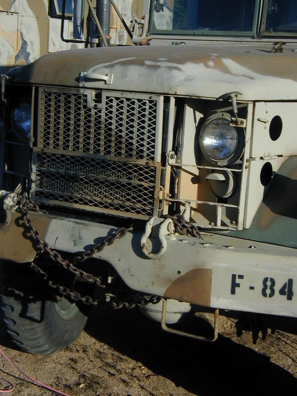

Also added a handle for lifting the hood, and a step (off my tailgate :shock:, must like this woman) to make it easier to check the fluids (otherwise I'll be the one doing it).
Got the footboard mounted to the wall, placed the water tanks (15 gal each) and sureflow pump. This is what that birch looks like oiled.

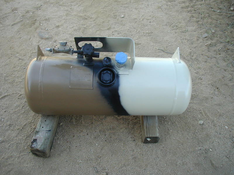

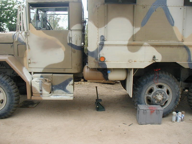

Next it was time to start on the propane tank mounting. Dropped the spare, mudflap, and pulled the holding unit off. With help from a friend that can weld, we fab'd up some mounts. Painted the tank got it back into place. Will still be able to re-hang the spare w/o having to do any fab'ing.

May I steal your LP idea? That is fantastic, and was wondering if I could fit my tank there.
I also like the way you did your 3 tone paint. I would like to use your style as well, only different colors. I officially give you credit if I go that route on mine

Steal away. The tank just fits w/o having to mod the mudflap. It's a 14.5 gal tank and we first thought that we would be cutting into the mudflap to mount it. Turned out that the mounts on the tank let us slide it far enough forward to just miss it and still give room for cab movement.
If you mean the 3 color interier paint, that's Elise's work, if you are talking about the outside, that's 4 color desert MERDC. Came that way, as did most of the things we have so far. So . . . no credit to me. I just painted to make it blend in.
