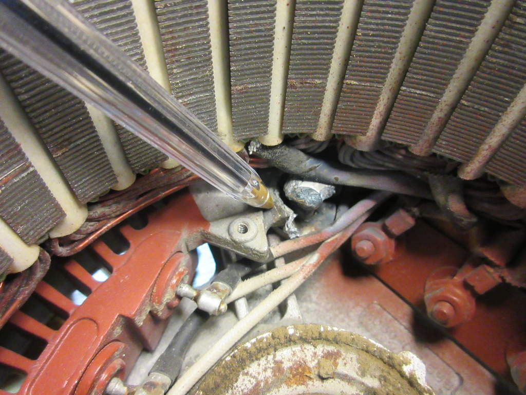

I talked with James this morning about 08:00 & his alternator has died, something about the positive stud has come out of it. He is somewhere in Kentucky, he didn't elaborate due to being frustrated. He is trying to find a shop that might be able to repair or replace the alternator problem. If that does not happen, then he is going to ship it the rest of the way home. Almost 2/3's of the trip done & murphy paid him a visit. So close yet so far!

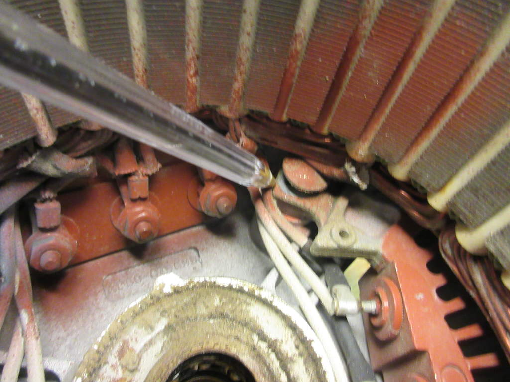

Well got a use Alt. coming for 300 but took this apart to sea. It's a carriage bolt that must have come loose and cause arcing. Think I will try and line it up good and tighten up the stud again and sea if it will work. If so then I have a spare. The two bolts on on the pic shows the arced and the good heads on them. Here I learned that the inner stud nut must be kept tight so as not to cause arcing and then fail. I will check the new one for tight studs.
