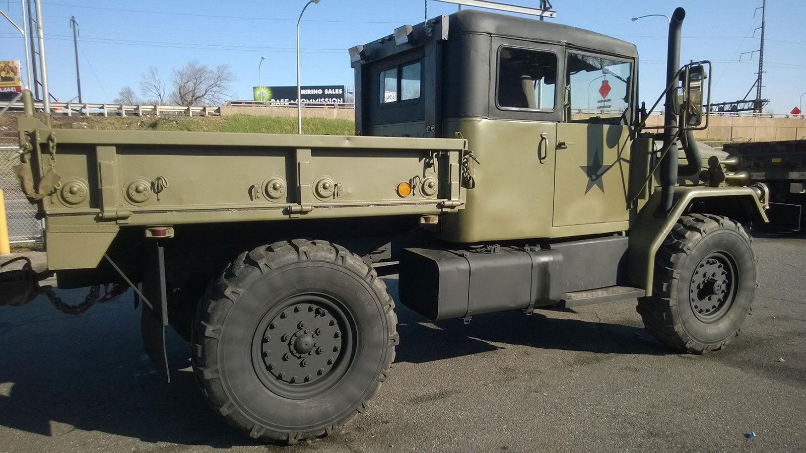

looking at buying a bobbed m35a3, but when I go and sit in it the steering wheel touches my lap and the peddles are so high I have to pull my leg up to press it, making it unsafe and almost undrivable. I'm 6'2 210lbs is there any way I can modify it to make it more comfortable? how does the average guy supposed to fit in one of these?
any suggestions will help!
