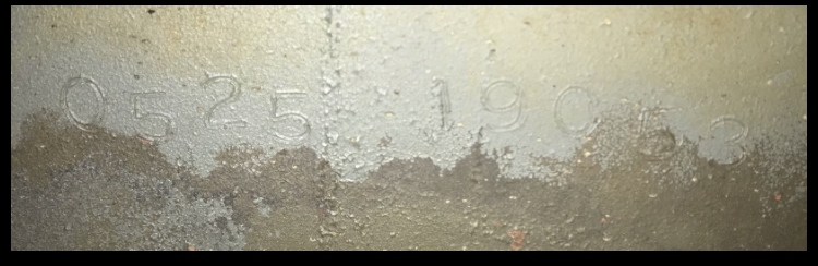

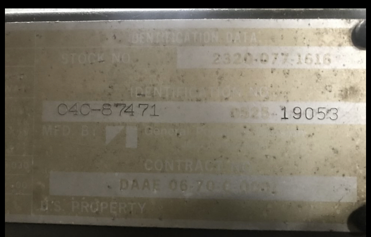

Smsfastman24
United States
I was wondering if anyone would be able to confirm and maybe help me find any additional information if possible. I recently just purchased a M35A2 privately and like everyone else, wanted to know its history. I looked in the M35A2 WOW file that was posted, but other than the info in the file is there anything else that can be researched? According to the pdf, its a 1969 and has a UIC of W8FBAA which from my understanding is the Maryland Active Guard Reserve. I also know that its a M35A2 w/o the drop down sides or winch, although the truck does currently have a pto winch on the front. It was rebuilt in 6/90 and I did confirm the tag with the frame stamped code, and they do match.
The Serial Number is 32512956
Registration: NK0D8C
NSN: 2320-00-077-1616
Was bought of a private seller in PA which was purchased from a dealer down in Delaware, currently looking for the company name.
Bumper Markings: MDNC 70 REG & HQ 4
NDT
10,858
7,436
Camp Wood/LC, TX
70th Reg (maryland.gov)
