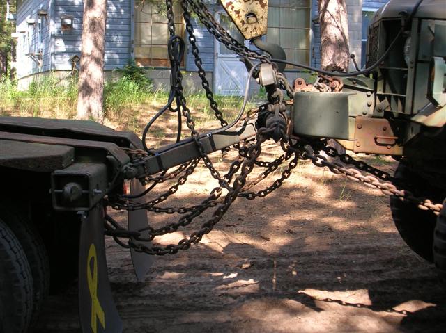

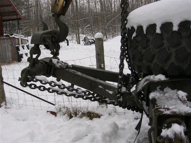

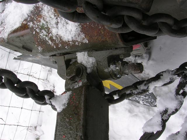

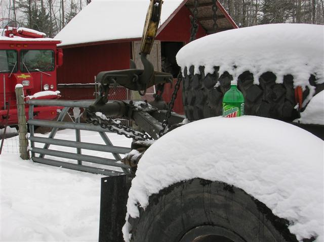

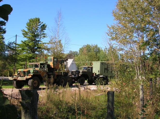

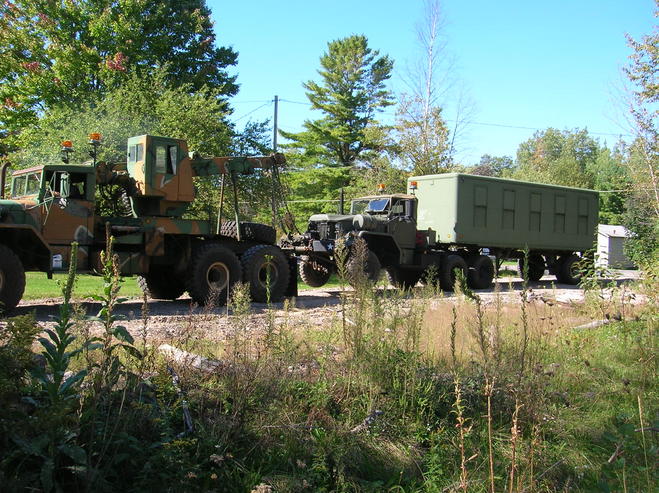

The towbar on the wrecker is interesting Dave. Have any info on it? Looks good as usual Sir!

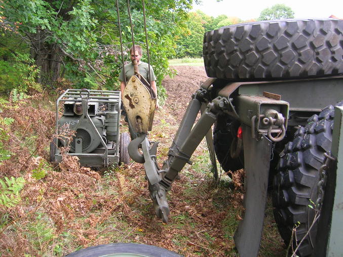

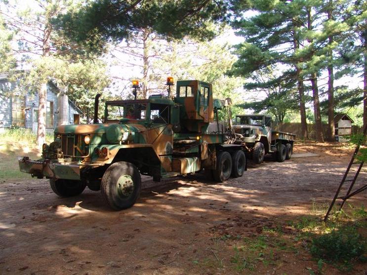

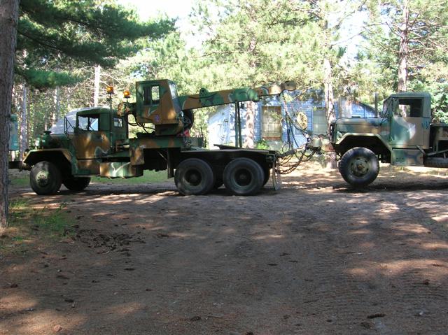

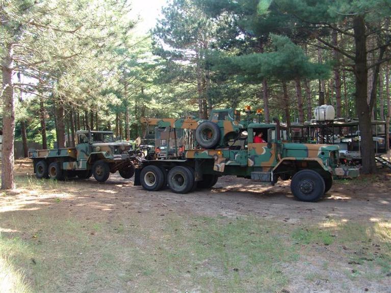

Here is a couple of random shots with my towbar in use.
you should be able to tell how my setup works.
OH! and the problem child made it the whole day without acting up!
thats a first i think.

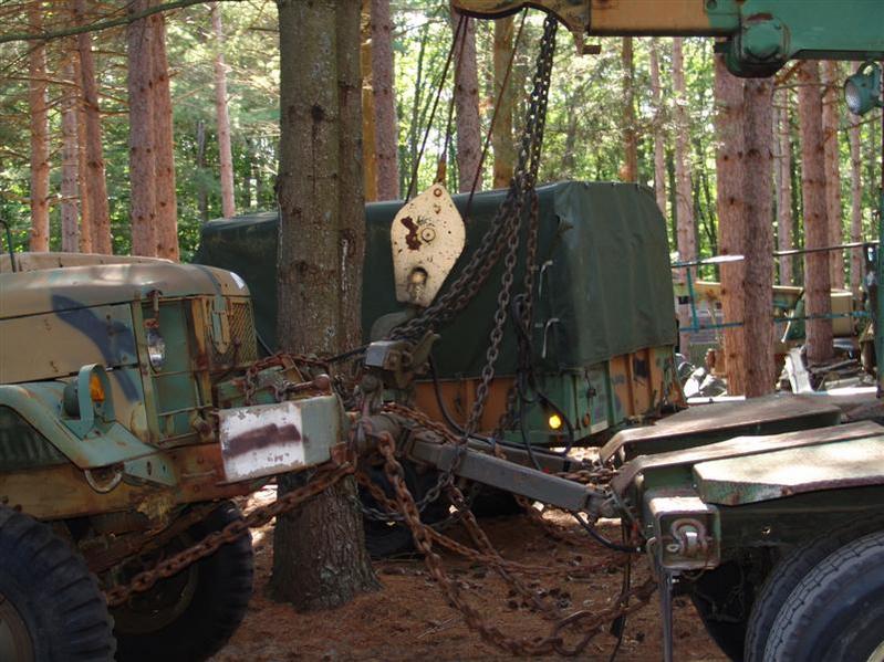

Nice to see plenty of safety chains. I need a wrecker so i can troll for m35s.
i tend to over kill on safety.
the lift/pull chains are the larger type Mil wrecker chains.
the verticle safety chains are grade 100 and they are attachted to the boom at the shive point. they are there so if the cable breaks the towed unit will not hit the ground.
then i use horizontal safety chains from the towed unit to the wrecker.
i know its over kill but that way i dont kill someone else if things go wrong.

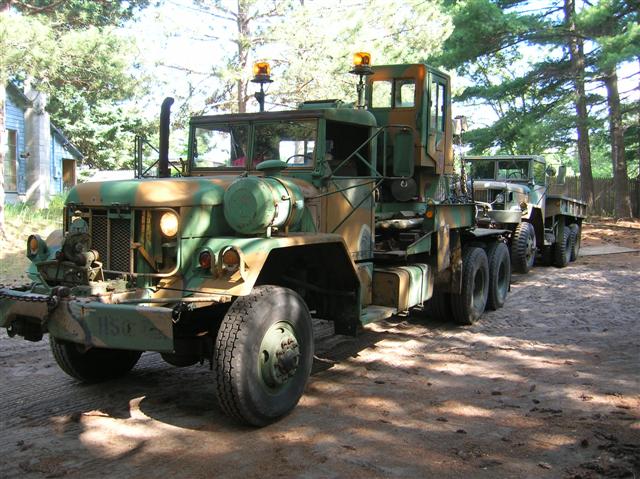

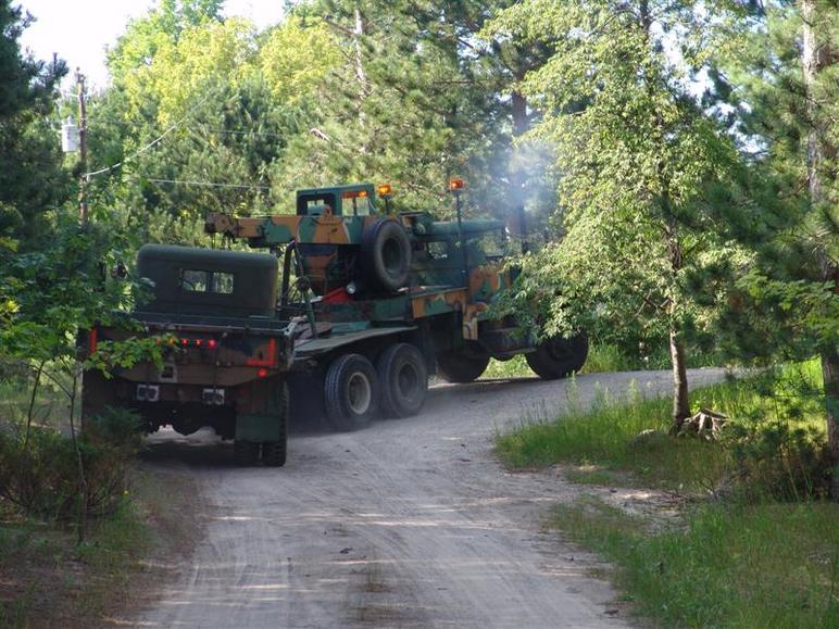

Man I turn my back for one minute to check the oil in a truck and bang the Cummins is screaming and a winch truck is flying out the drive.. :-D To bad I had to give the cannon back! I think I could have had him at the stop sign!
with the SPEED and AGILITY of the M819 i would have made it!
Besides the two were so well camoed they were almost invisible:razz:rofl
and stealthy!
