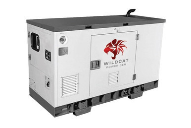

1800 works well for diesels, less so for most gasoline engines, but there are models around, e.g.
I think that part of it is also fuel management. It is relatively safe and easy to store diesel and propane. Large quantities of gasoline tends to require significant isolation distances and practices that are not so hard on a farm or ranch, but somewhat harder to achieve in more developed areas.
