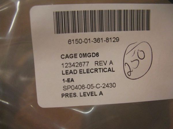

Search Amphenol MS3452-32-1S for your female bulkhead connector. The MS designates a military connector, the 3452 designates a bulkhead mounting and the 32-1S means a size 32 connector in a style 1 pin configuration and the S means it's a socket (female). The 3452 style is aavailable with different backstyles. A 3450 will mount a strain relief, the 3452 has the wires plugged into the back.
These connectors are a nightmare to identify even for someone used to working with them. To someone unfamiliar with them it's all gibberish!
Thanks for that. I definitely found it a bit frustrating, one of the plugs I bought I ended up damaging during disassembly to find the pin contact color codes. If I didn't have the plug in front of me I seriously doubt I'd have found any of this info.
Couldn't find anything with that exact part number, but when I change it to MS3452W32-1S it comes up. I only thought to change the "-" to "W" because that's the same format as the plug part number.
Looks like you can buy just the socket for about $100, so buying the entire umbilical kit for around $200 seems like a decent price as you don't have to worry about buying cables and crimping ends.

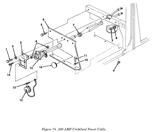

(edited) To clear up the confusion, this post is me trying to share the part numbers I found related to the umbilical cable plug in the rear passenger footwell of the heavy variant HMMWVs (M1097, M1123) for anyone that might be looking for them. I found part numbers, and listed them below, as well as links to sites that list having those parts in stock.
Hopefully this helps someone else, as I spent many good hours looking for this plug before finding some with cut off cables on ebay (of which I bought both available, and I don't see any more).
(end edit)
(second edit) Here is a link to a site showing pricing and availability through multiple venders. Part is listed as coming with pins on at least one of the vender sites. This is only for the plug body, not the cable strain relief that attaches to the rear of the plug
(end second edit)
So searching here didn't turn up much, I've been looking for a while for the part numbers for the plug that will attach to the 200 amp umbilical.
Here is the umbilical in question (This part came installed in my M1123, just posting it here for reference.)
I finally managed to find a couple on Ebay, but they had the cables cut off very short, too short to splice the wires I have into it.
Part numbers the seller had listed for the connector were GlenAir #06324, M85049/52-1-32W, MS3417-32A.
The GlenAir number doesn't seem to come up as anything (only real hit was the ebay sale), the other two numbers one shows up as the part below, other doesn't come up as anything in a quick search.
M85049/52-1-32W Amphenol PCD | APM85049/52-1-32W-ND DigiKey Electronics
The ones I bought had a part number on them of MS3456W32-1P which brings up this item
(the image they used is generic for the series, not this specific plug)
I don't actually know everything that this particular part number comes with, so I don't know if it has the pins inside of it or not.
For mine I need to order new contact pins, so I disassembled one of the two I bought and took a look at it. Found the pin contact has a color code on it, finally tracked down that code to this part:
Amphenol Aerospace M39029/29-216
It's sized for 2-0 gauge cable.
The cable on the plug and on the BEOD I'm putting this connector on is 1-0 gauge.
To use with 1-0 gauge there is a bushing kit to reduce the size so that it will crimp in properly. (no picture for it)
Here are a couple pics of the ones I bought.
View attachment 791903View attachment 791904
