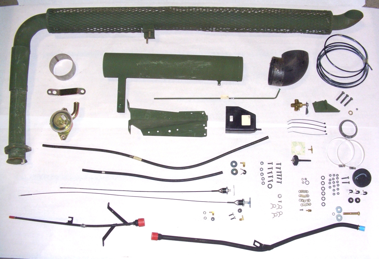

I've discovered two different NOS deep ford kits online and I'm wondering why they are different if they're both advertised for use on M998's. One is p/n 5705693, NSN 2590-01-319-5435 from Eastern Surplus (first pic), and the other two pics are 5705703 NSN 2990-01-320-8731 from RP Machine, in OH. There are a few obvious differences such as the straight end on the exhaust pipe vs the typical curved, and the different intake stack components. Any ideas or input?

I believe i've figured out the difference between the two DF kits illustrated above. The one from Eastern is the normal, run of the mill kit. The other one is listed in the parts manual (of all places) as 'Supplemental Deep Water Fording Kit'. What i thought were intake components in the pic are actually extensions for the exhaust pipe, i'm guessing for use when a cube box or something large is installed on the back of the truck. As well, in the parts manual the Sensor Cup shown above is connected by a hose to the top nipple on the DF CDR. This has been quite the educational journey so far, and i'm hoping others are learning as much as i am...
