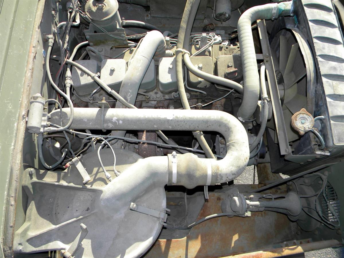

The intake piping looks funny on that truck. My truck has the turbo compressor inlet closer to the radiator, and the exhaust dumps into the downpipe near the firewall. It looks like this truck has the compressor inlet piping on the firewall side, but how is the downpipe routed near the radiator?
Eastern's 6bt pic
My 6bt engine pic
because yours has a intercooler, and the other one doesn't......

I don't think so. Here's another one without an intercooler (from page 1 of this thread). Air filter feeds front of turbo (not the firewall side). Of course the turbo in the picture below sits up much higher than the Eastern Surplus listed engine.
I have no clue if there was a contract with plans on one way to do this, or some of these pictures are custom M35A2s with 6BT builds like mine.

the one turbo is flipped. air side is at the rear, the one in this pic has the air side in the front. 1989-91 cummins 5.9 were not all intercooled. Also follow the air intake manifold to the turbo, it would be going to the front of the engine if it was intercooled, as the intercooler would be in front of the radiator....Both are piped right back to the turbo.

I'm hoping to figure out the story on my cummins conversion 71' m35a2. The tan cummins in the first picture is mine and I couldn't help but notice the alternator bracket is the same as the second picture. I've since swaped in an aftermarket radiator because the original was torn up by the winch cable when I bought it. The other pictures are my engine mounts etc. I'm just curious if the military actually converted a few of the trucks themselves or if a company was selling a conversion kit.

The M35A2 with intercooled 6BT is indeed mine. I ended up having to use a longer military truck hood (dump truck?) because the radiator/intercooler assembly stuck out too far.
For more information on fitting the intercooler visit the following, https://www.hanksdeuce.com/intercooler_mods.htm

Mines intercooled. It actually has a cummins part number on it if you’d like. Fits behind the stock grill and hood.
