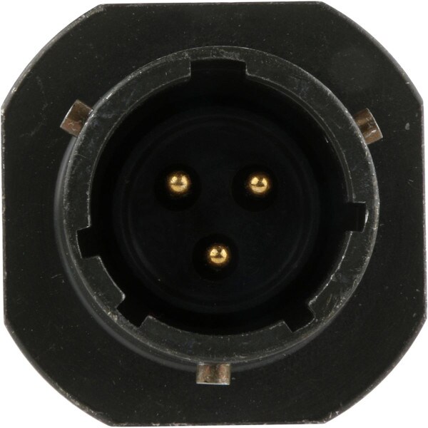

So..... where can you get a CTIS pressure switch for less than $500??? ouch....
if your speaking of the one on the tank.... yeah those are OUCHHH
Find it parts has them same 500.. BUTTT here is some discount codes? https://www.retailmenot.com/view/finditparts.com
found one hundred or so less...... but out of stock so dont trust the price
truck pro is redoing their site to they are down for the night
ebay.... best price so far https://www.ebay.com/itm/3047242975...+3w/AR1DVmT99kWVSTXzaZIkVWRn|tkp:BFBM9JbJgJ5h
Funny thing is ebay ad is from FinditParts....
CTIS Pressure Switch on air tankTruckPro/Spicer599959

Thats a tough one. Like the alternators, It is a pretty specific component, and the bandits know it. Thats why I like to throw out cost effective alternatives whenever I can:) The CTIS sw closes at 117 and doesn’t open again until 89PSI. But there are inexpensive off the shelf 90-120 PSI air compressor switches. I have not found one with normally open contacts though, so these open at 120 and close at 90 to cycle an air compressor this is opposite of the CTIS sw. You could invert that output with a relay, so maybe $20 in parts and a little bit of wiring?
IMO the main purpose of that switch is to allow the air system to recharge fully occasionally. It may be that CTIS also expects to see it open after a certain amount of fill(guessing here)… This behavior could probably be mimicked close enough to keep CTIS happy with a simple programmable interval timer… About $10?

Wouldn't even need a weatherproof box. Cut the connector at the tank and Install the 90-120PSI air compressor sw at the normal location at the tank and install new connections on the end of the wiring harness and weatherproof them to the switch. Splice the relay into the CTIS wiring harness under the trailer and park brake valves in the dash.
The normal CTIS pressure switch config grounds wire 1790/pin T in the CTIS harness when the tank reaches 117 PSI, and maintains that ground until tank pressure drops to 89PSI. So you cut wire 1790, and connect the CTIS controller end to a 24v automotive relay pin 30 and connect pin 87A(normally open contact) to ground. The truck side of wire 1790 you connect to one side of the 24v relay coil, pin 85, and you sample 24v CTIS power from wire 1911/pin H and connect it to feed the other side of the coil at pin 86.
So when you turn on the main switch and start the truck, if the new tank sw is below 90PSI(switch closed), the relay energizes, removing the ground to CTIS. once the air charges to over 120PSI, the new switch opens, de-energizing the relay. This applies that ground to CTIS and it then goes to work like normal… about $25 in common off the shelf parts…
The expensive and hard to find 205F normally closed temp switch(opens at 205) that controls the engine fan, can be replaced in the same fashion using a far more common and affordable normally open automotive cooling fan control sw and a relay…
